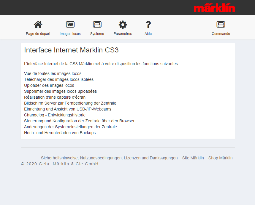

1. Make sure your CS3 is connected to your router.
2. Obtain your CS3's IP address. Go to System>IP on your CS3.
3. Connect to your CS3 by putting the CS3 IP address in your favorite laptop browser's (Edge, IE, Chrome, Foxfire, Safari, etc.) URL window and hit return. A "Märklin CS3 Web Interface" page should open.

#4 Posted : 23 April 2021 15:31:43(UTC)
Posts: 3,688
Now the obvious question is is there a similar product for CS3 and how do I get it?
Hi Rwill
The CS3, associated with a VNC Viewer (to be downloaded for free) allows your computer to take full control of your CS3.

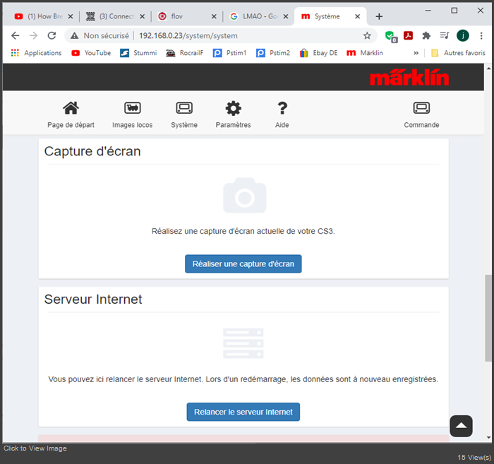

Once you have downloaded and started VNC viewer, create a contact with the IP address of your CS3 followed by :5900 (in my case 192.168.0.23:5900
You need to start your CS3 connected to your PC (I suggest a manual fixed address (so it will not changeBigGrin )
Then on you computer browser (I use Chrome), type the IP address of your CS3
Then you use system and then, in SYSTEM select RESTART INTERNET SERVER.
The previous program you are using is CS2.exe by Märklin. It works fine with a CS3 with the exception of the track synoptic (LAYOUT) the same goes with previous apps for iPhones MainStation and Mobile Station
