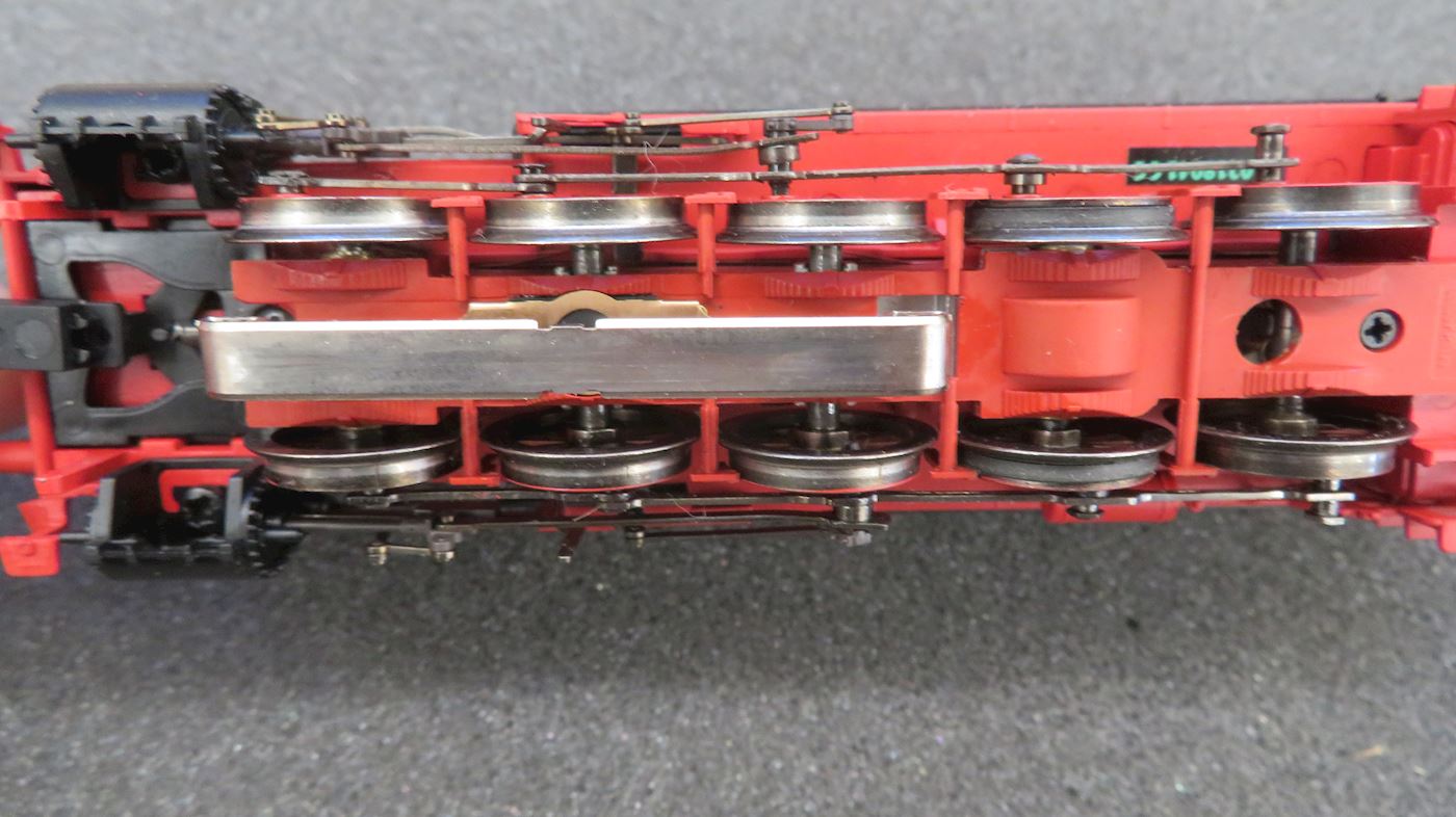

This is starter set #29721. Here are some photos of loco. Hope they help.
IMG_2509[1].JPG IMG_2513[1].JPGIMG_2512[1].JPGIMG_2510[1].JPGIMG_2511[1].JPG

The slider itself looks okay. It looks perfectly straight and is quite thick and solid built so it doesn't bend easily. It's mostly worn toward the front and back but that's because it seems to have mostly run on a circular track. This doesn't mean that there isn't a problem with it picking up power at slow speeds of course. Usually when you have stalls they happen at the same place over and over until the track is cleaned (or the center studs have been rubbed with a piece of graphite to improve conductivity). In this case the stalls happen everywhere so it shouldn't be the tracks.
How does the train behave when it runs on a bigger layout where you use all the tracks and have longer straight runs? I would suggest letting it run for a while at around 3/4 to full speed and then see what happens at slow speeds.

I don't see any wheel contacts between the chassis and the inside of any of the wheels. This leads me to believe that the contact is to the axle itself on the inside of the model.
If you look at the last axle, you can see a hole in the red undercarriage. Inside that hole, you can see two springs which rest against the axle of that wheelset.
That, IMHO is how the ground is transferred from the internals to the rails. You can try inserting a Q-Tip with contact cleaner to ensure that there is a clean contact between the springs and the axle.
I have not seen this model in person, so I don't know what materials were used. The exploded diagram in the instructions does not show how the model is wired.

So I took a look where Mike C. suggested and do see two small springs in contact with axel. The axel looked moist to me. Using a Q-tip I rubbed inside the hole. The axel will slide side to side and wiped the Q-tip there also. Photo below shows result of that. Currently don't have any contact cleaner but is on the shopping list for some CRC Contact Cleaner and Protectant. (I do have some of the QD cleaner but looking at some posts here, not a recommended product for this.)
I've not lubed the loco but was thinking it might be due. Must have a good 20 hrs on it now. I do have some of the Trix lube and Labelle 108 oil on hand but haven't tried using it yet.
I ran the loco at separate times today. First time I started at half speed and made some laps (4' x 8' double loop), then slowed down to slow speed. No stalling at all. This afternoon started loco at slow speed and went around a number of times without stalling. Go figure. Confused Hard to say what result tomorrow.
Thanks all,

I had that problem with my FS 424 running in analogue. Cleaning did not solve the problem.
As a result, I had Mike digitize the loco and it worked well for a few years; until now. Scared
My gut feeling is that the decoder is bad.
I would suggest to our friend to borrow a loco from a friend and run it to see what happens. At the same time, run the troubled loco on the friend's layout and see what happens.
However, I would NOT replace the decoder unless I were positive that is what causes the problem.
I doubt it's the MS2.
BEST solution: I would buy locally even a used simple loco to compare performance.

Eeehhh, couldnt this be the 'grease-in-motor-issue', where the BR94 is known for? Did you recently oil/grease the gears near the motor?
See also https://www.marklin-users.net/fo...lin-BR94-5-18--cat-37160
I had this even with the 'good' motor of 37168. It happens when the grease from the wormwheel gets into the motor onto the brushes. Causes high current consumption, and the decoder going into 'safe-mode' (current protection), thus causing the stalling.
Please check this:
- What do the lights do when the loco stalls? Do they turn off immediately or do they stay on/come back on immediately? (mine stayed on often, as only the power to the motor was cut) How does it behave with/without sound?
- Typically, as sound consumes some power, the stalling should occur less when sound is off. Do some test with/without sound. If the stalling is the same, independant of current consumption -> look at the motor/grease issue.
If you have to happen a regulated power supply with current readout, a so-called lab supply, you can hookup the motor to that and check for current consumption. If there are spikes in consumption you have the greasing issue. This is what I did (I have a 15V/3A max supply). My locos motor consumes < 0.2A when it is OK. The bad motor had short spikes up to 3A (the max of the supply). After running the motor like this for a while it got 'cleaner' and the loco was usable again for a short while. (Lots of smoke when the grease burned away!) Sadly it didnt fix it permanently, either the grease contamination was too bad or it was damaged too bad. But mine was in worst shape than your based on the videos, so you can still try.
So I replaced the motor with as new one (~25euros) and now the loco is as good as new.
Did you also clean the motor? Do this and change the brushes for new ones. Similarly as with the BR94, a dirty motor will cause higher current consumption, which the decoder will not be able to handle if it gets too high. My guess is you couldn now be at this point, if you changed nothing else.
Although on 2nd thought, in analog the decoder has to undergo the reversing voltage spike every time. This kills the main rectifier capacitor on the decoder. over time. (ESU decoders where known for this) You could try adding an additional capacitor there (like a powerpack) and see whether it helps.

It's losing power.
Everything looks clean. Too clean. Even the wheels and the slider of the loko looks brand new.
Let the loko RUN IN, if you haven't already done that. Run it at near full speed 20 mins in one direction, then 20 mins in the other direction.
I don't believe so, the locos from that start set have a history of doing this, and i pointed the OP at a thread here previously.
It appears to be a problem with that particular loco design, possibly because of the way the axles are designed to slide sideways to take sharp curves on a loco with a lot of driving axles.

First off thanks to everyone for all the suggestions and comments. Great to know you are there to offer advice.
Don't want to jinx it by saying Mystery Solved! Woot Woot However, the loco has been performing as it should for this past week. Have run it a slow speed for a great deal of time without any issues at all. I'm thinking the solution as Mike C suggested was an inspection of the small access hole at bottom of loco where the last axel is located. When I did this I noted (as reported in a previous post) what looked to me like a lot of oil. The excess was wiped away and ever since the loco is working.
Additionally, yesterday a friend I met here on the forum from a town about 80 miles away was able to visit my layout. He brought one of his digital locos (BR50.40 - Marklin #37049) and it ran just fine on the layout at a variety of speeds. He is much more experienced at this than I. He also noted my loco to have more oil on all the axels than maybe should be. (I'll get some of those real small cotton swabs to wipe away the excess.) I've never oiled the loco (just received it in Jan), so the assumption is that it was service by the Marklin dealer I purchased from or was over oiled during manufacturing. Again I'm a real novice and just making a guess. In any event believing the excess oil was cause of issue.
Mike C had suggested I use some contact cleaner in that area also. The cleaner is on my shopping list and hope to pick up some tomorrow. That will be the next step in the process.
