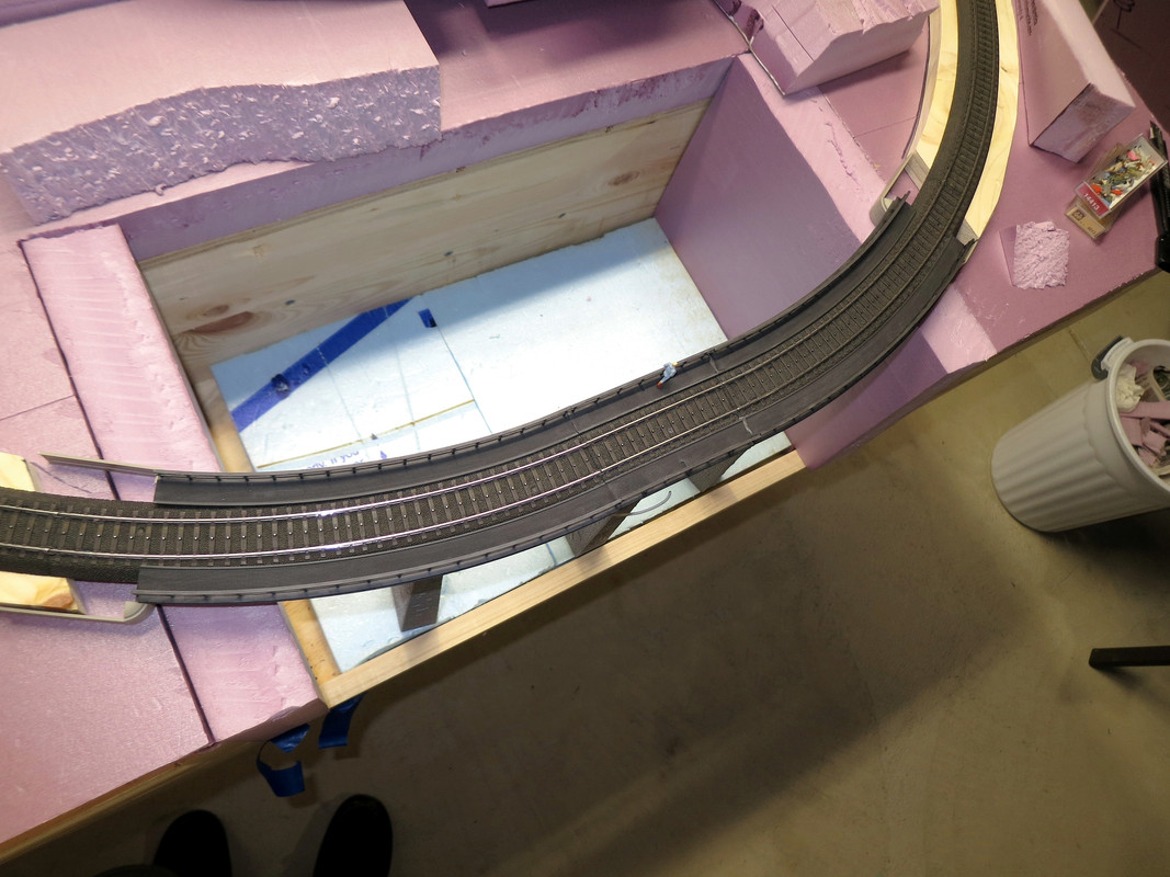

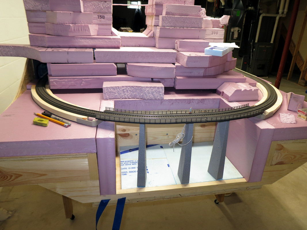

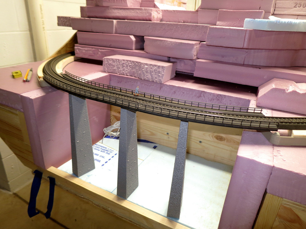

#3 Posted : 20 April 2021 00:09:49(UTC)
LA2019
Joined: 18/11/2012(UTC)
Posts: 361
I found a solution for my particular situation with a bridge for R3 track. I used two 74623 and one 74618. The R3 track roadbed needs to be trimmed a bit to fit the curve but it does work. I also had to cut down the straight bridge; again for my application. It wasn't too fussy and just a bit of finagling and it seems to have come out OK.
Just wanted to share incase anyone needs an option for R3 track...
