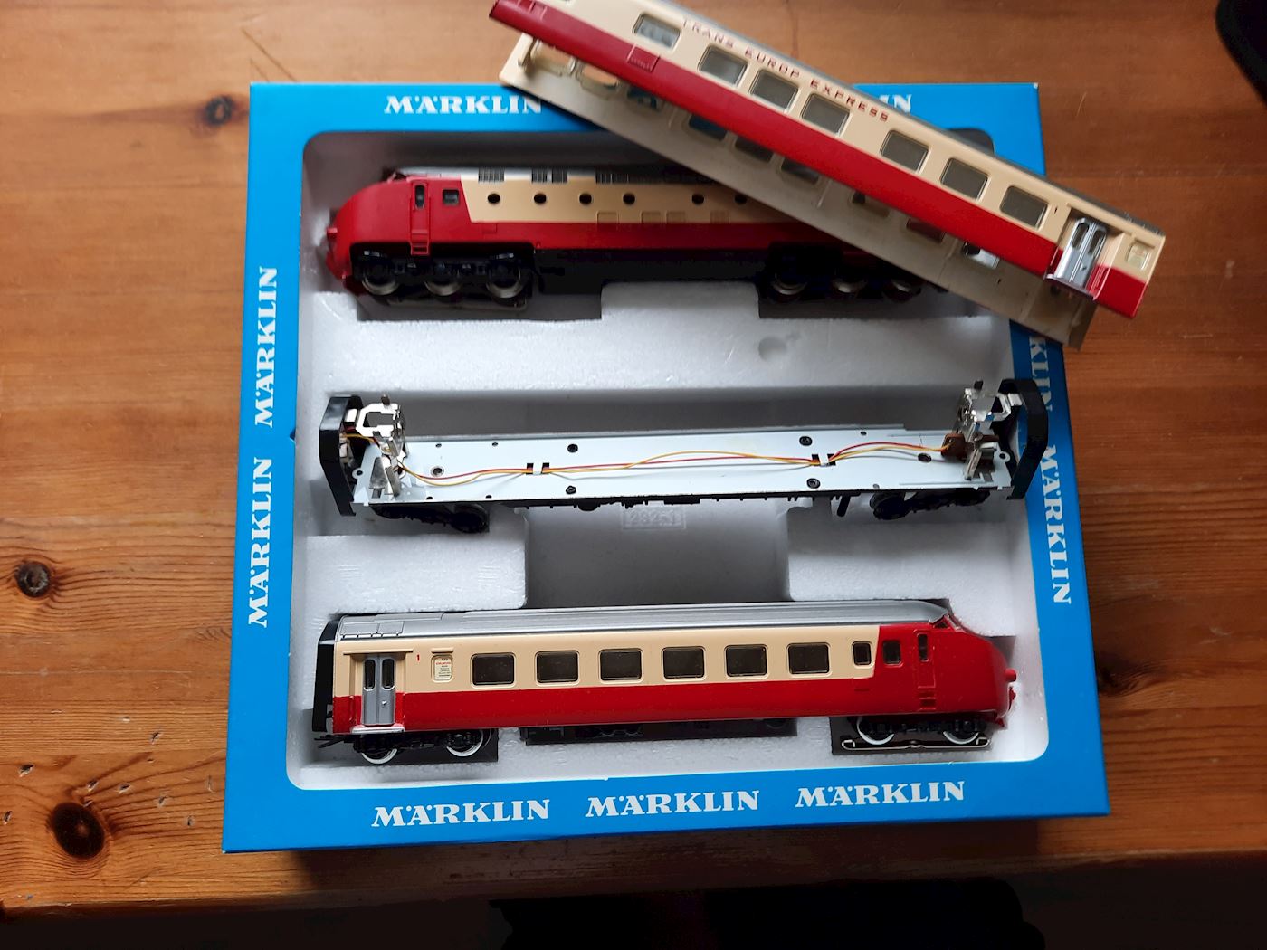

Hi Users.
I want to create some inventory for sitting passengers in my old Märklin
set 3071, see attached pictures. I will make the inventory in thin plywood
and balsa and giver it spray paint afterwards.
It will be great help if any of you will take the time send me some pictures
if you are the owner of a newer series of this train set with inventory from
factory. It will be a great inspiration for me to making this Inventory.
I am not sure that this is the right group for this request, so please guide
me to another group if that is the case.
Regards Ole from Denmark

Your post is a little confusing in English.
I am assuming that when you write inventory, you are in fact talking about interior details.
The first two models (3070/3071) did not come with interior fittings
The later 3471 and 39700 did.
I don't know if those parts are available as spare parts.
Some people installed the 0223 and 0224 interior parts inside their models. We did not.
https://www.ebay.de/itm/...P-OW134-26/383999085903?
https://www.ebay.de/itm/...P-OW134-27/324506461335?
The interior parts from the 39700 are as follows:
Steuerwagen 49700
Speisewagen 497220
Abteilwagen 497010
I don't know if the parts can still be ordered from factory. Maybe Ritter Restaurationen or other expert may still have these?
I have a 3471 with interior details in my collection.
You can also look here:
https://www.stummiforum....amp;t=70688&start=25
https://www.stummiforum....1&start=700#p1690656
