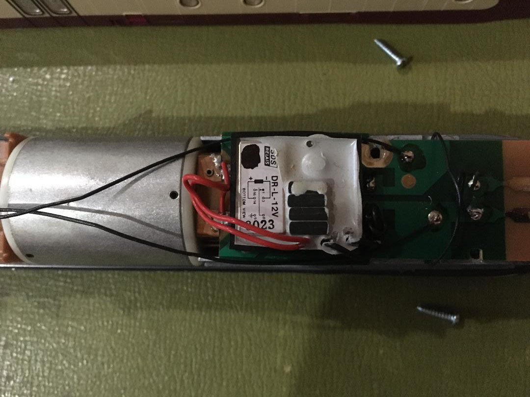

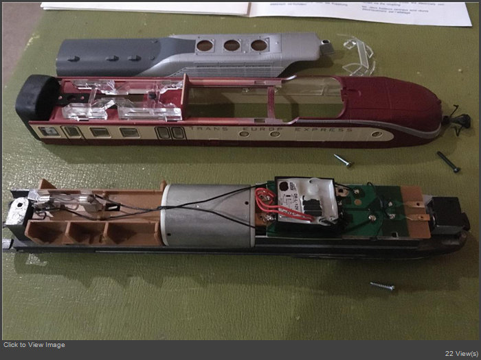

Requesting assistance in converting a Roco 14183A / 14070A BR 601 (VT 11,5) TEE train from AC to Märklin Digital. The motor is located in the front unit but both the front and back / end units have collection shoes which switch over with direction of travel. Upon inspection the motor appears to be AC as there does not appear to be any permanent magnetic field, it is a cylindrical piece located between the two sets of drive wheels (front of lead unit and back of lead unit). There is a black box next to the motor which appears to control the direction changes as well as where the power is accessed from (front or rear of train). The top of this box is labeled: 3023 SOS Relais DR-L-12V and it has wires coming out of it connected to the left and right side of the motor. I suspect the connections to the sides of the motor are for field windings each in a different direction like the field coils for the older Märklin AC motors. Piece of additional information - the cars are connected via a current conducting coupler system so the power from the rear collector shoe can provide power to the motor when the train is running in reverse. Also there is limited space beside the motor.

The two red wires on the top of "box" are connected to the motor

I don't think Roco ever bought out an ac motor, what you will find they have added a rectifier, you should have enough room for a decoder and a loudspeaker., you may have to alter the front circuit board by cutting it and place the loud speaker there (cube type), exchange the globes for leds and the rest should be easy

The motors are DC no question about that.
To convert it to Märklin digital you need to do the following thinks.
1. Check if there is enough space for the decoder base and decoder
2. Take of all the existing electronic modules and cables except the motors and the pick-up shoes
3. Use the 60973 decoder board which has the pickup Changeover
4. Do the connections according to the instructions
5. The motors must connected in parallel (if there are more than one)
6. You can use any 21mtc decoder you like with or without sound from Märklin or ESU
Costas

IIRC there are versions of the Roco VT 11.5 where the motor draws about 1.5 A at max. But I don't know if the pictures show one of those motors.
Normal H0 decoders may not have sufficient amps for the motor.

ktsolias: What do you mean by 21mtc decoder? Would a Märklin 60983 decoder be the type to use since from comments that suggest the motor is in fact DC with a permanent magnet? There appears to be no "brushes" for the motor as there are no openings in the motor casing - just the two electrical connections via the two red wires shown in my first photo.
The Märklin 60983 decoder has continuous current load at the motor output of <= 1.1 amps, maximum total load <= 1.6 amps.
The complete train has the two lights shown in the engine + 5 passenger coaches of 2 lights each + the end cab unit with two lights (total lights 14). The lights are all the same type as shown in the above photos other than the two for the headlights. It appears that all the lights are wired to remain on at all times, regardless of train direction. The only thing that changes is which collector shoe the power for the motor comes from - and this is transmitted through the train from the back to the front via the permanent couplers. A leaflet in the box states that for block operation the rear collector shoe must be removed and that the train can then only be operated in one direction.
I am not quite sure of how the electrical connections are working. The two black wires coming up from below the circuit board (upper photo front of circuit board) appear to be connected to the front collector shoe and the right side of the "little box". This also connects to the rear of the light bulb at the back of the unit which also has wires going down to the coupler. The wire at the front of the rear light bulb is connected to the left side of the "little box" and as is visible in the upper photo is grounded to the frame via a screw that attaches the circuit board to the frame. I don't know how both collector shoes can be providing power at the same time if they are both connected to the couplers...? Sorry - the wiring is confusing me.
