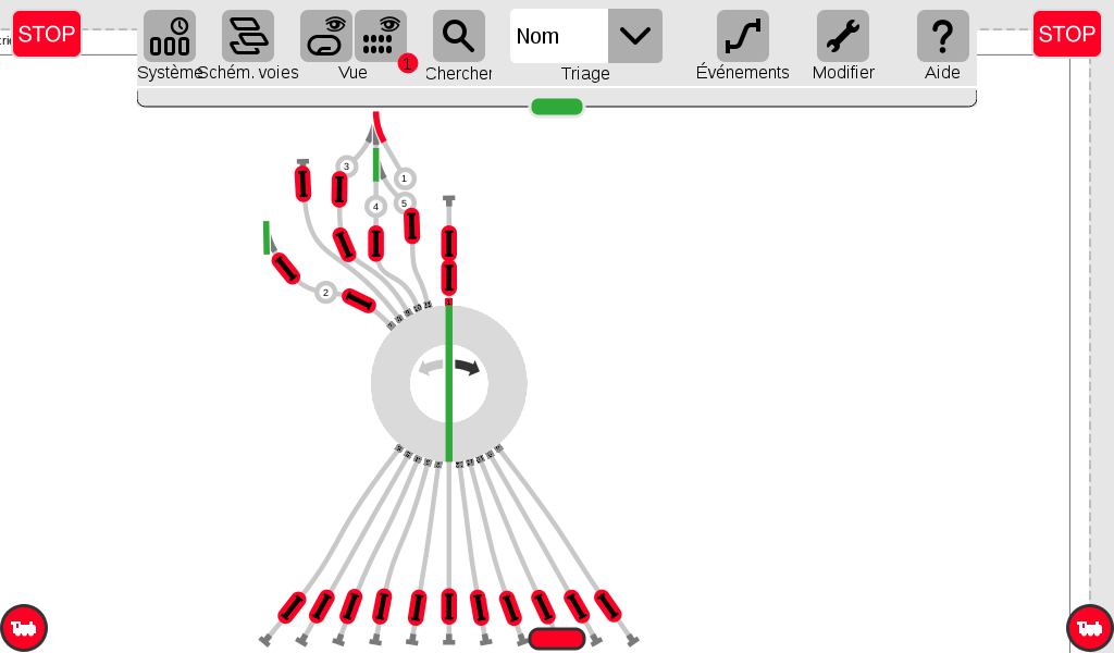

I also observed a funny behavior as I did the following
* created a switchboard-like surface for most of my layout and all went well
* when a created the surface for the steam depot (with a TT) using the normal layout then all went well
BUT when I connected the steam depot to the main layout (invoking interface switches) then all tracks on the steam depot was with bridge-like tracks

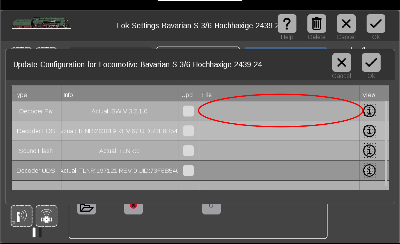

before you start totally blaming the cs3 i would upgrade to firmware in the decoders.
Download the software for the 60971 programmer to your Windows PC and connect to the cs3 with it across your local network. Also make sure your cs3 has upgraded itself to the most recent level as well.
Just remember, if you send it back to Marklin the first thing they will do is make sure the cs3 software is at current level, then check it with locos fitted with decoders at the most recent firmware upgrade.

That track diagram behavior you saw was odd. I was about to make my first track board when this other stuff started, so I am pushing that back for now. I have read other posts about the challenges of getting a track board set up and working correctly on the CS3. If it does not become more reliable than it currently is I won't need a track board anyway!
In fact, my fault, Märklin recommends to select either the normal track board ("Platte") or the control desk ("Stellpult"). Probable reason: they know about remaining bugs
I did because the layout looks so much better using the "Stellpult" but it poses a real problem when having a turntable.
Long story short: once you have spent the time to set the 'layout" right, then it is very OK
I totally agree Alan. I thought of that this morning, because this is the kind of behavior you would expect with a system with mismatched software versions. I will update all of my decoder's firmware, starting with the locos which are giving me the most trouble. I would never send the CS3 back to Märklin unless I could determine a definite hardware failure.
My CS3 is up to date and I already have the 60971 software on my laptop, so that should be doable. I tried using the CS3 to do that the other day, but I did not have my laptop on that local network, so of course it did not work. As soon as I catch up on our massive snowfalls, that will be my very first chore.
You have helped me figure out enough stuff that soon you can say that you are running a MRR remotely in North America! BigGrin

I also need to update my decoder's firmware as Alan suggested and that could easily be a source of this behavior as well. I have been in the process of upgrading my internet service and I am finally approaching normal and workable speeds. ThumpUp I also just bought a new laptop which is vastly nicer and faster than the one I had been using with the decoder programming software. Right now I am just waiting for the next rainy day to set things up to do that, since my CS3 is not normally connected to my main network.

I assume you have checked, but dos your boosters and track format processor have the latest firmware? (the track format processor had and an mfx fix in the latest update.). You could also try a forced update on the cs3, to eliminate that something went wrong with the latest update.
As for locomotive firmware updates, it's quite easy to do them on the CS3, unless there is a specific need for 3.2.2.1, you can get 3.2.2.0 on cs3. The cs3 is also able to update firmware on older mfx decoders if they have updates. I don't think you need an internet connection to do firmware updates as long as you have the latest firmware installed. I don't think the mdecoder tool 3 software can update older mfx decoders (gen 1 and 2).

The few that I have checked using only the CS3 have not found any available updates even when the CS3 was connected to the internet.
Did you check the dropdown menu? you have to actually click on the grey field to get the dropdown option and see if there is an update. (red ring)
Them you should get something like this: (it's worth checking the other options as well, but usually they are empty)
Good question. I think that I clicked in that field, but maybe I didn't. I will check that again and see if any updates are just shy and hiding in there. lol
