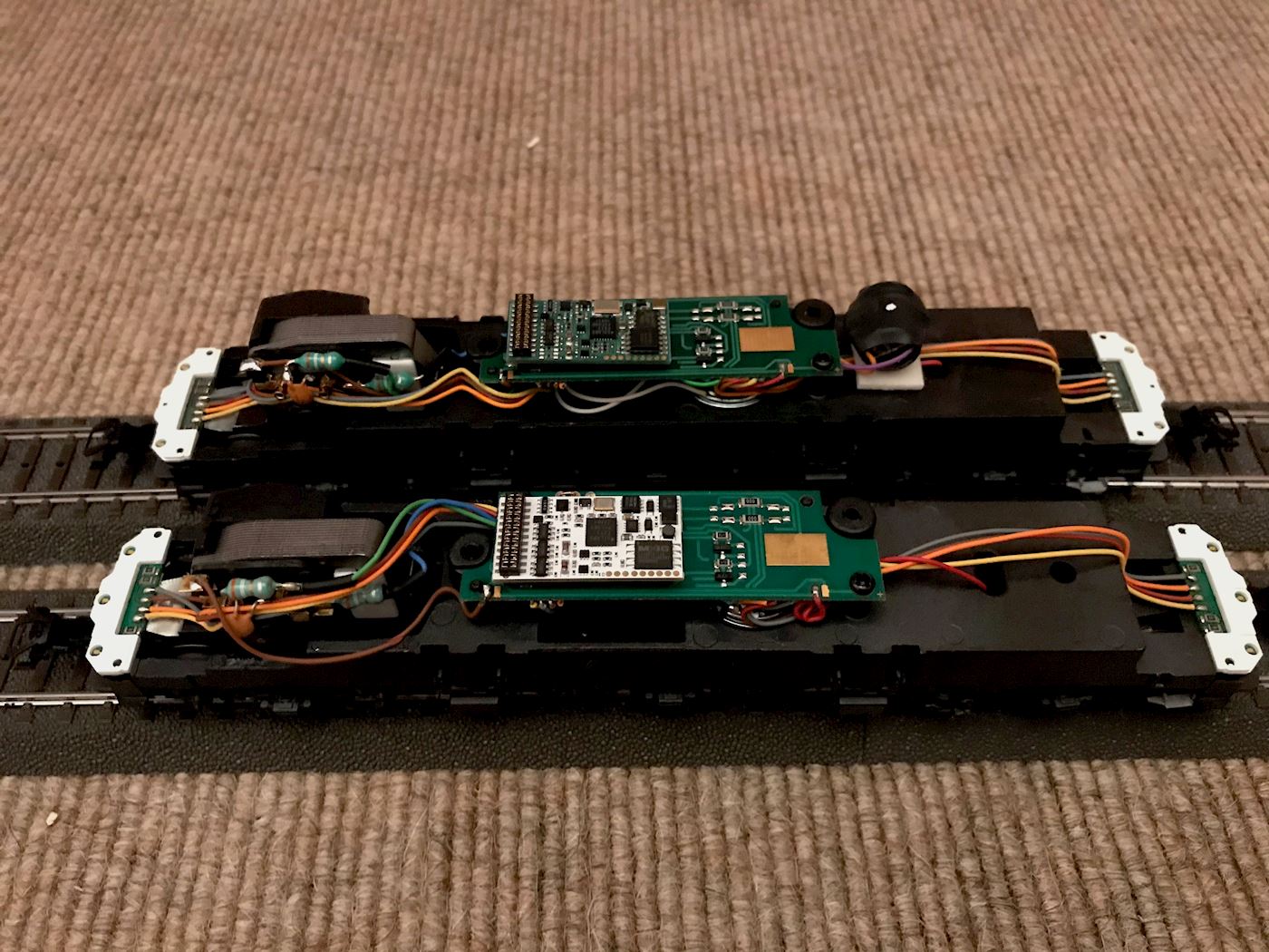

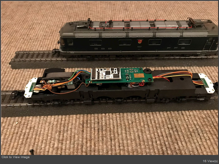

#10 Posted : 03 February 2021 23:22:29(UTC)
Posts: 8,250
Bert,
Thank you very much for your help. I will check the innards to see how many LEDs are on the panel.
I will make sure that I have the 37322 and 37324 on hand for comparative purposes
37325 Internal
37322 Internal
37325 front, 37322 rear
37325 LED Close Up
The 37322 photographed is actually equipped with the shell for the 37320.1.
Summary:
F11 with F0 off = Rail Joints (Schienenstoss)
F11 with F0 on = Rail Joints + High Beams
If F6 or F8 are pressed while the locomotive is travelling in that direction, only the sound comes on and there are no lights. (Killing the lights does not kill the sound function).
If I send the model back to Goeppingen, I will probably have to pay CAD$120 for shipping plus whatever service. I will probably get a model back that no longer has high beams. According to the website, the decoder for the 37325 (253537) is out of stock. They may still have some in stock for repairs in house.
All of the decoders for 37322-37326 are showing as out of stock:
260028 Decoder 37321 + E113289 Sound Module (May be the same for 37320/373230
260079 Decoder 37322/324
253537 Decoder 37325
296206 Decoder 37326

#11 Posted : 04 February 2021 07:56:44(UTC)
DasBert33
Joined: 21/01/2004(UTC)
Posts: 1,280
Yours looks exactly the same as mine, so there goes my theory.
