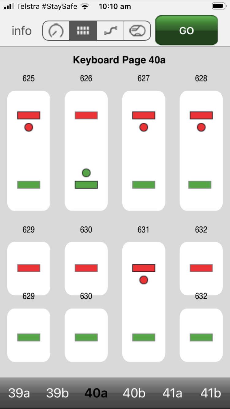

I've found a peculiar problem with my CS2 in conjunction with the mobile station app on my iphone.
I have DCC turnouts controlling ESU servos and noticed on my CS2 with the turnout icons that some are 'paired' in the same box and some are separate for the red and green.
On the CS2 however the turnouts work regardless but when using the mobile station app, those that are 'paired' do not activate at all.
By going into the CS2 edit and comparing them, those with the paired box are configured as 'standard', while those separate are configured as 'standard red' and 'standard green' but otherwise identical.
Here you can see on my iphone the two types:
You can see here 629, 630 and 632 are separate, configured as 'standard red/green'. The others are paired.
So when using those turnouts from the CS2, they all work.
When using the app, only 629, 630 and 632 work.
By changing the turnout from 'standard' to 'standard red' on the CS2, the box changes and they now work on the iphone mobile station as well.
Anyone experienced this before or can understand the logic?
I can of course change all the turnout types to 'standard red' to fix it, though a lot of them to go through.... Is there any way to bulk change them?
I have no idea how they were changed in the first place given the CS2 is from my dad who bought it new and he never touched those settings (didn't even have DCC decoders, let alone in that address range!'
