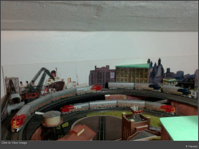

BigGrin
Jens
This account is no longer active
thanks 3 users liked this useful post by TouchCab

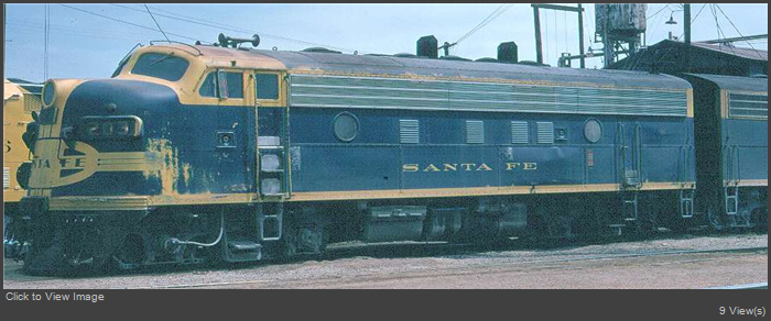

With the exception of the new SC set carrying number 305, M* produced ATSF warbonnets with double head lights and dual use numbers.
Obviously ATSF freight F7A units had only a single had light and a blue body with yellow embellishments, initially with cat whiskers (see pic 1) and then with cigar bands (see pic 2). I like the "goggles" look of these F7A units.
(The latter are not to be mistaken for the blue bonneted M* 3362/3662; some prototypes really existed, but those were repainted passenger units.)
Did anybody bother to have a go at such 200 class freight units?

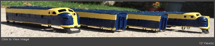

Let the games begin:

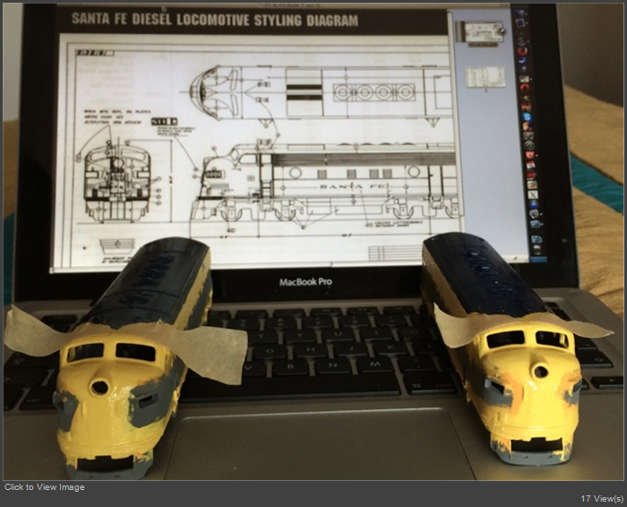

Take a battered 3649 and a neglected 4081, remove shells, strip off grab irons/window glazings/horns, prepare priming by cleaning surfaces with a toothbrush and toothpaste, rinse thoroughly and let dry.
#66 Posted : 10 August 2014 16:39:12(UTC)
Posts: 6,075

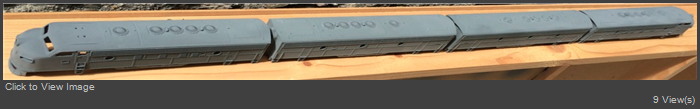

Apply several layers of primer (let dry in-between).
#67 Posted : 10 August 2014 16:42:39(UTC)
Posts: 6,075

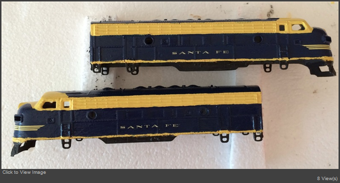

Select colors, ensure that yellow paint matches decal color (it does, but on the photo it looks different than in reality).

Applying decals is a challenge: This is my second attempt after I had to abort the first one yesterday evening.
Cursing
Fortunately, I had ordered two decal sets.
Blink
#84 Posted : 17 August 2014 15:14:20(UTC)
Posts: 6,075

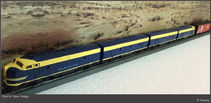

And after seven days the cycle closes for the ATSF F7 ABBA freight loco kit bashing experiment. I tried to match the setting of the initial 2006 photo at the beginning of this thread - see pic.
RollEyes
Mission accomplished, but neither complete nor finished I would say. My strengths lie in another area, thus I would not do it again. Lessons learnt:
The round(ed) prototypical paint patterns on nose and front roof are a nightmare and it is almost impossible to "industrialize" the process; and using a tape plus a fine brush I was not (cap)able of obtain acceptable results. Now, as the prototype is a freight loco which has always a somewhat battered appearance on color photographs, I can live with this, but (super-)detailing is not my world. Advice: Do not paint the inside of the number board shafts; otherwise the latter will not slide into place again...
Sad
Following the instructions of Vallejor (http://www.acrylicosvallejo.com/en_US/applying-decals/blog/1/35) and with the help of four products (gloss varnish/decal medium/decal fix/matt varnish), warm water, tweezer, toothpick and cotton swabs, embellishing the F7 shells with Microscale decals (and protecting the latter against being rubbed off by accident) was doable. However, for a beginner a spare set of decals does not harm...
RollEyes

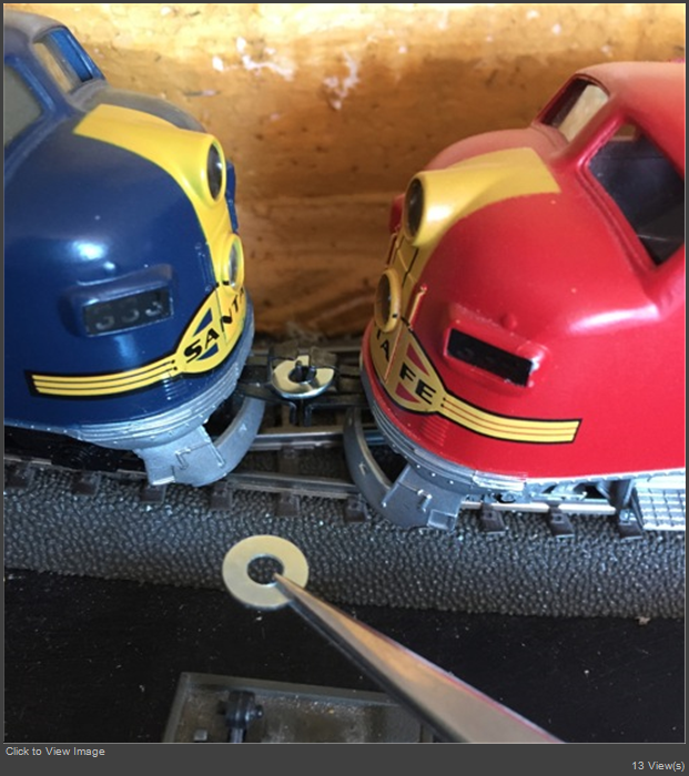

Bjorn, motorized B-units are actually very useful.
You can hook up dummy A-units to it to make again cheap consists (remember the title of this thread ! ).
My intention was to motorize the Athearn B-unit body shell using a 3060 as organ donor and build a dual motor setup like the Märklin Amtrak model has. Now I've been running it just with a dummy A-unit and never hooked up a powered one.
I ended up shortening the baseplate on so much that it fits on 4063 body shell keeping the Märklin dimensions. For Athearn shell it needs to be cut a bit shorter.
I used Esu Loksound 4 with a magnet for the motor conversion. To me it runs pretty smoothly even in the lowest speed steps. Problem is more the big difference between the lowest steps and continuous power feed than getting it running slow. This is all with a blamed 3-pole motor.
Please take a look at the video and pictures below. It's not as hectic as music videos today, but crank up the volume and you can hear the EMD 567 diesel rattling beautifully!
Juha
Brakeman attached the following image(s):
thanks 6 users liked this useful post by Brakeman
#88 Posted : 28 August 2014 09:58:40(UTC)
Posts: 6,075
That is what I did, too, for not having to re-arrange all the 3649 cabling between motorized units and pick-up shoe. I cut off the end of one of the motorized A unit body shells to fit a 4081 B unit shell on top. The last A unit of the ABBA consist is a trailing dummy on the 4081 body shell.

Wanna close-couple F7 equipped with hooks?
3 mm or 4 mm flat washer does the trick.
See pic.
(Works also between B-units.)
