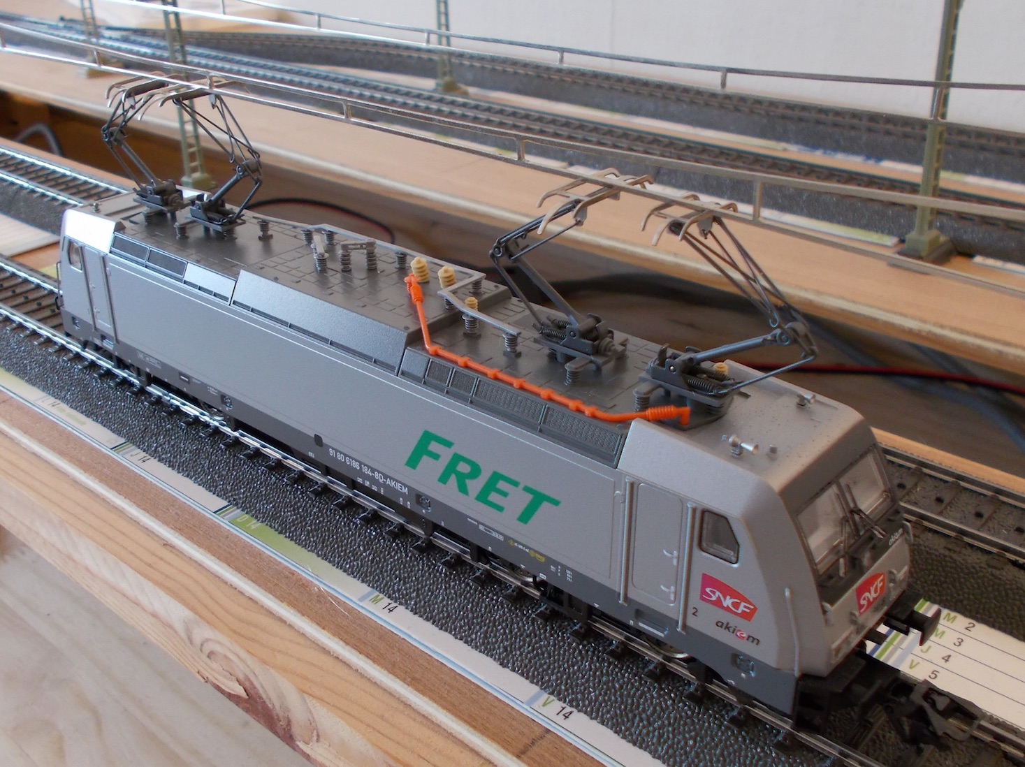

Much much more modestly than John, I use the old Märklin catenary.
My layout is switchable,
either analog with power supply for the catenary,
or digital without power supply for the catenary.
In all cases the pantographs are up.
I noticed that now, on new locos, reducing the playability, the pantographs are closer to reality,
and in particular for their width.
So I always select the wider one.
Depending on the European country, the pantographs are more or less wide.
For example:
France, Switzerland, Netherlands => narrow
Germany, Belgium => wide
(hoping there is no mistake)
This can be seen clearly on my 36625 (the prototype is used to cross different countries).
The wider is the pantograph,
the greater are the tolerances for placing the catenary,
especially on tight curves.
So some people prefer to leave the pantographs down,
and forget the catenary in the tunnels, whatever digital or not.
Best Regards
Joël
