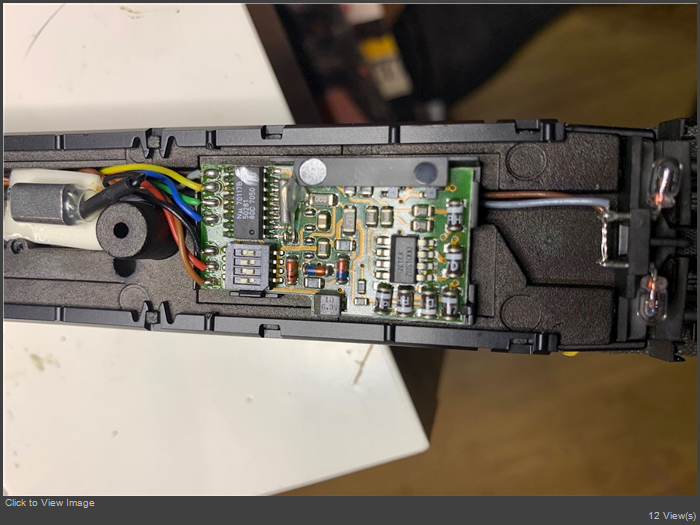

I have bought a used locomotive ,Marklin 34645,with delta decoder. The train runs ok digitally but the light intensity follows the speed.Do I have to do something in the config menu for the loco in the cs3 page?There is no F!,F2.. defined in the menu.marklin34635.jpg

As far as i know this is normal behavior with a Delta decoder.
Only way remedy this is by installing another decoder (but then you normally change the motor also...)
