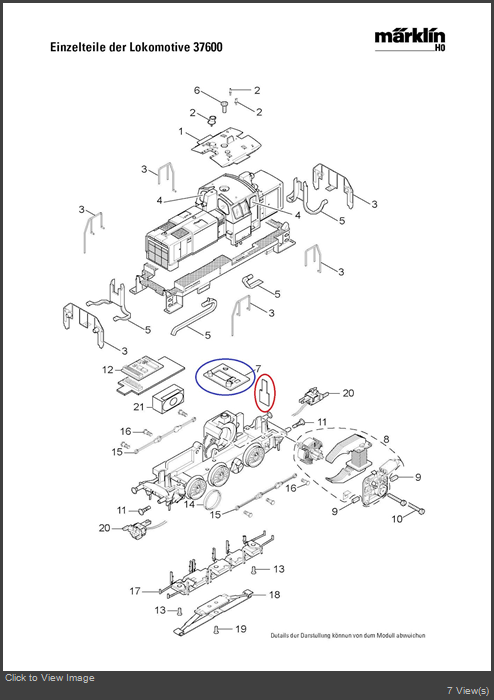

Can anyone tell me what is the part no E188376 of a new version of V60 locomotive, with pictures. I have the 37600 locomotive and I cannot figure out what item 7 in the spare part list is.
Thank you.

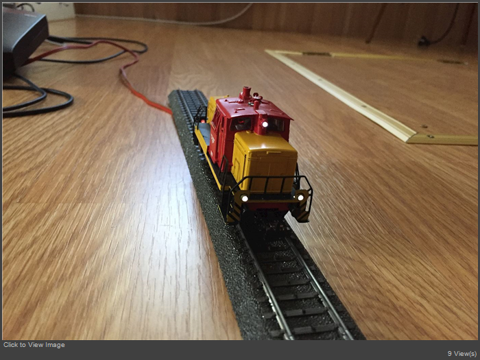

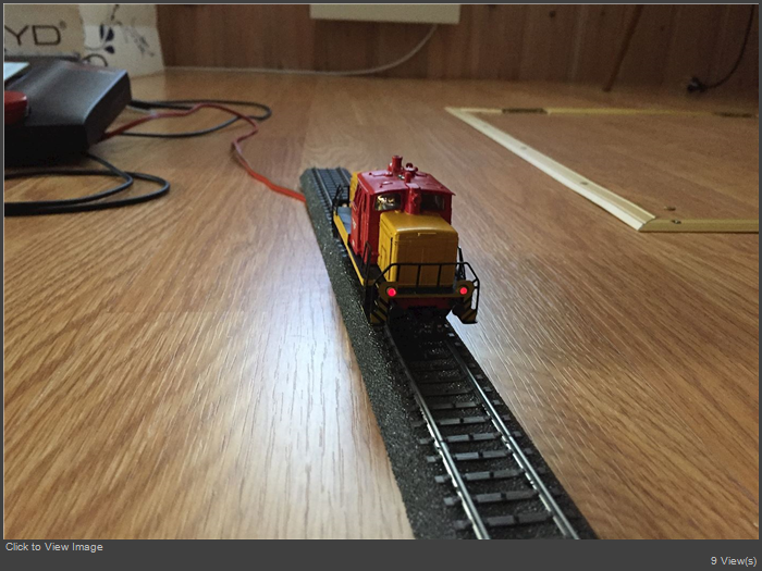

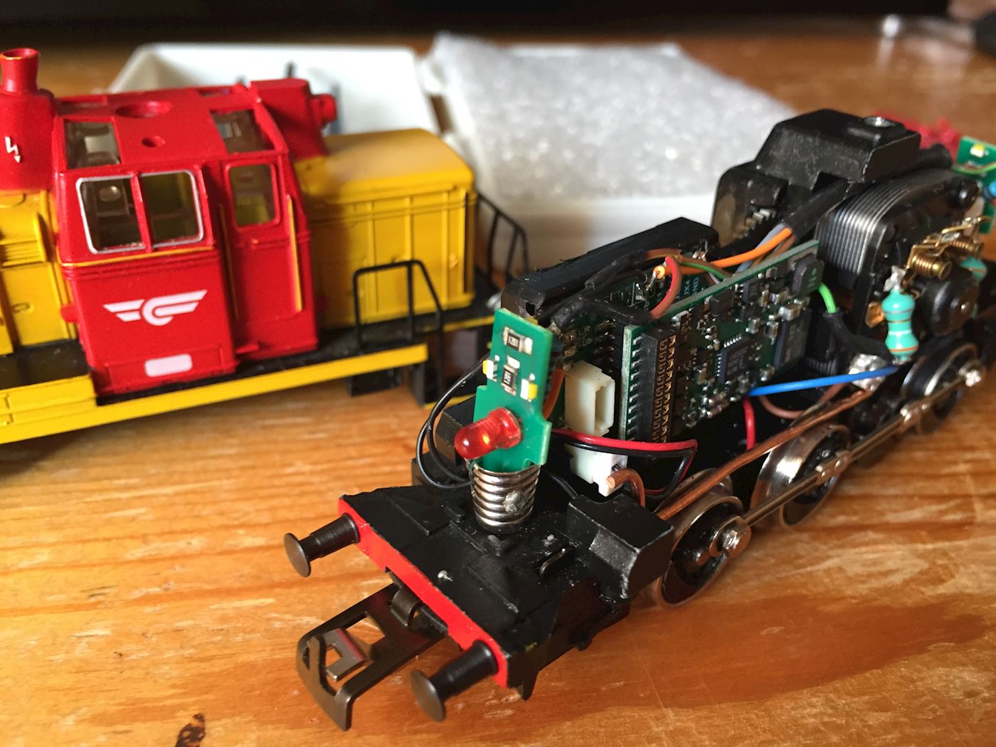

It is a pcb with 2 or 3 leds on the front side and 1 on the backside - all warm white. The shape makes it possible to stick it into old light bulb sockets. I have drilled two extra holes and soldered an extra red LED on the front making it possible to show red marker lights.
I will post a picture when I am back home.

I did not have red SMD leds when I was converting this locomotive. Will change that one day…

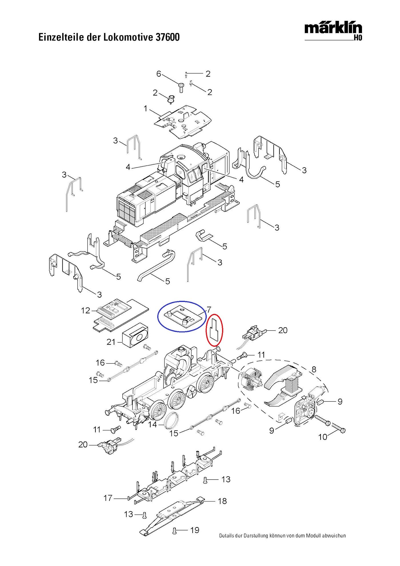

So there seems to be an error in the manual.
Item 7 is the one in the red circle and not the one in the blue.
Is the one in the blue circle an in cab detail plastic piece that covers the motor? And if yes why it is not installed in the locomotive. And second how can i order it?

Yes, that is an error. Part #7 is in fact a pcb with part # E601815. As far as I know it has only been used in Märklin 34641. It is connected to the telex couplings and the two leds will turn on when the telex couplings are operated.
Leif
