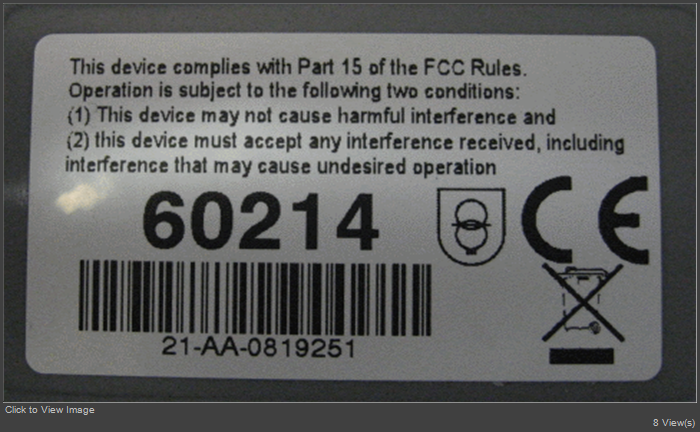

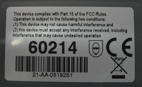

If you plan to buy a CS2, I recommend avoid units without galvanic separation (all 60213 and early 60214)
Galvanic separation is indicated by two intersecting circles .
