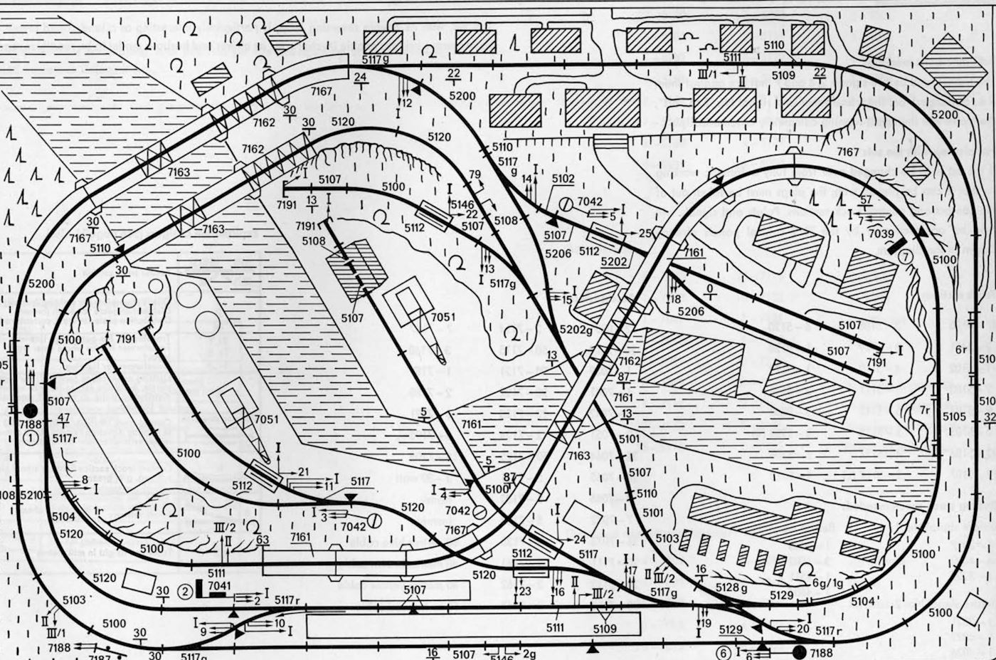

Today I was browsing through the 0350 layout book, and came across the trackplan that I've always liked, and which really shows off the M bridges...
I'm thinking I'll use this as a focus to my collecting - assembling the components over a few years.
However, looking more closely at the plan, the text says that it has "two return loops". However, both loops are in the same direction of travel. Once a train is travelling counter-clockwise on the outer loop, it can't be turned around again. Quite a shortcoming if you are going to bother to have return loops.

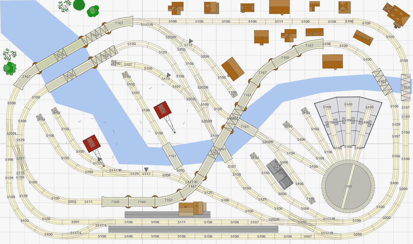

My first thought is to add a double-slip on the left and move the switch to the outer loop like this:
which then allows the inside to be used as a return loop for a train travelling counter-clockwise.

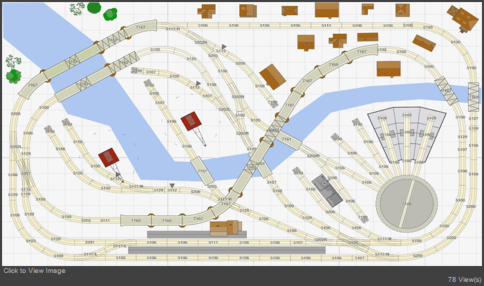

Well, now I've messed with the track plan anyway, so what the heck. If I'm going to build a period-style layout, I want to have a turntable and roundhouse.
So, I did a layout based on this one, but made it 30cm wider and added a turntable on the right hand side. The mainline is topologically the same, but I've messed with the sidings and created a bit more run to have slightly lesser gradients...
