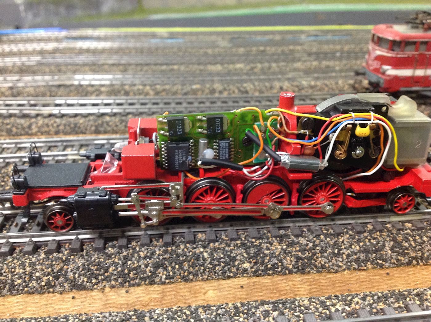

#4 Posted : 26 March 2020 08:30:20(UTC)
mvd71
Posts: 1,973
Location: Auckland,
image.jpg hopefully someone recognises this decoder
#5 Posted : 26 March 2020 08:40:06(UTC)
Posts: 15,543
I have fitted a pickup shoe
Did you also re-solder some wires? If so, which?
Offline mvd71
#6 Posted : 26 March 2020 09:11:01(UTC)
mvd71
Posts: 1,973
Location: Auckland,
Ah ha! Success, it was address 86 and put the pick up shoe on properly.

Offline mvd71
#7 Posted : 26 March 2020 09:31:50(UTC)
mvd71
Posts: 1,973
Location: Auckland,
Hi Tom,
I've done nothing other than remove the hamo pick up and screw in a Marklin shoe. But when I screwed it in I didn't realise it was not touching the contact point due to the tight fit in the loco. Once that was fixed it was easy to find the address. Just need to understand how to change the address now.
Cheers....
#8 Posted : 26 March 2020 09:56:14(UTC)
Posts: 15,543
Create a DCC loco in the CS, put the loco on the programming track, and change the address as you do for any MM or DCC loco.
I hope this even works for such old decoders. I don't know if the CS supports DCC register programming. This could be a challenge if the decoder requires that.
