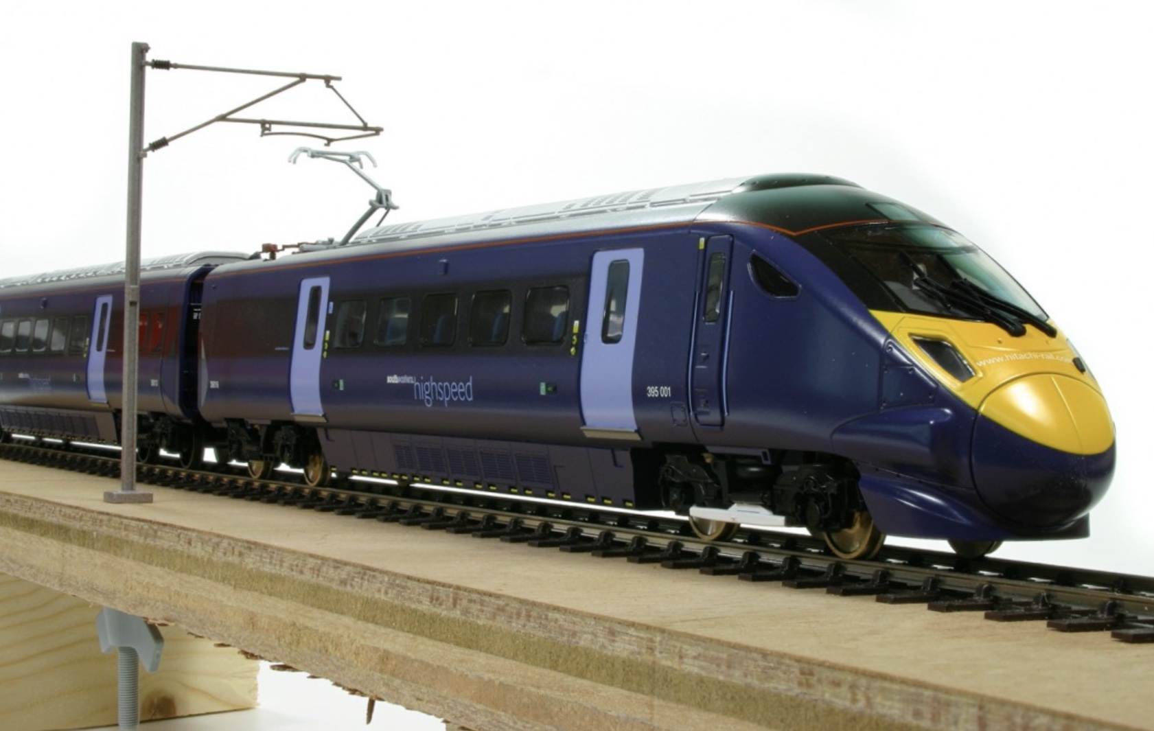

Some of us are thinking of installing - at least fake - catenary on our layouts, and I have ordered some Sommerfeldt 317 ”Quertragwerke” for the stations on my SBB/BLS inspired layout. However, I will not use catenary wires. I will need a lot of masts on the double track line, and the cost for Sommerfeldt masts will be... high, approx. 6-7 EUR per mast. Ofcourse, they look very nice and are all metal, but on the other hand: Is that really needed, as I will not use wires?
So, on the net I found the Dapol ”OOCAT1” catenary masts, and I purchased a package of 10 pcs at approx. 15 EUR for testing purposes. OK, they are all plastic, but as you can see on the pictures below (not my pictures), IMHO they look ”good enough” compared to the prototype? (A good thing about modelling Swiss railways is that there are a loooot of different catenary prototypes.) At least, I believe they will look better than the Märklin masts, that are too German looking. And it seems as if it’s very easy to install the masts, using wing nuts.
So, what is your opinion on the Dapol masts? And has anyone of you tested the Dapol masts? Blink

They look really good .
And you are right, the variety of catenary supports along the Swiss RR lines is practically infinite, and sometimes even varies from one suspension to the next .
If you watch video of cabrides in Switzerland , you'll get a feel for what I really mean.
Your suggestion is interesting and since it's not very expensive, I'll give a try....but it will have to wait considering the current lock down

They look good!
Are they rigid enough to hold a strand of thin wire or thread between them, representing the catenary wire? If they are I would consider fitting them on the parts of the track where I don't presently have catenary. The packs of catenary wire that Dapol make for these masts are, in comparison, quite expensive.
https://www.dapol.co.uk/...ssories/ohe-and-catenary
I have Viessmann catenary on some of my track, which is similar to the Marklin newer type but came in a "starter pack" at a more economical cost. However the cost of buying more catenary pieces and masts to complete the job, coupled to some difficulty lining it up, made me reconsider and I never completed the job. Because I don't have all my tracks fitted I run most of my electrics with the pantographs down, pending the completion.
I might use this Dapol catenary to finish the coverage of the layout, but "fix" my loco pantographs so they don't go all the way up and touch the "wire". It's not ideal but looks better than no catenary at all.
