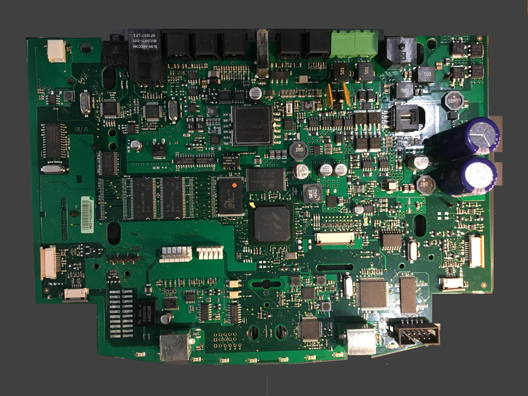

Definitively they don't repair it anymore. Below is my 60215 motherboard.
