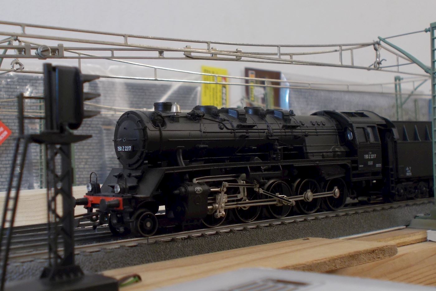

Hello Friends,
I have just purchased this lovely loco.
#3414
150 Z 2217 SNCF
This loco had never run.
I wanted to share with you the needed servicing,
after 27 years of hibernation.
First contact with the tracks, the loco does not move...
This loco was an export model from 1993
See you next post !

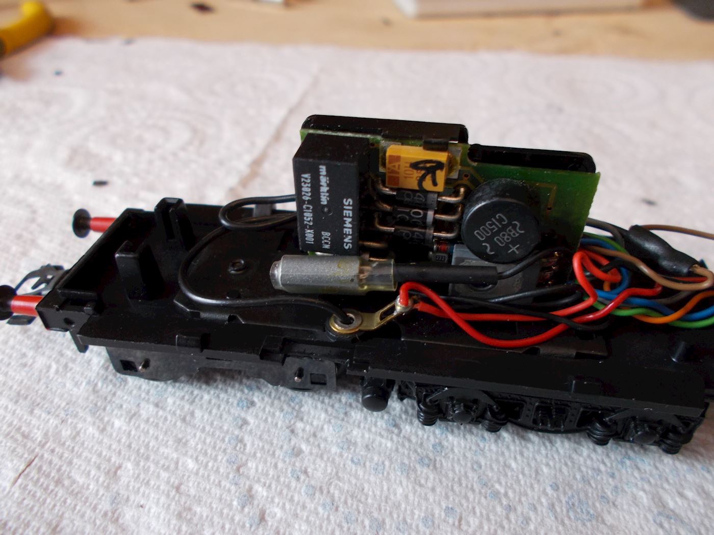

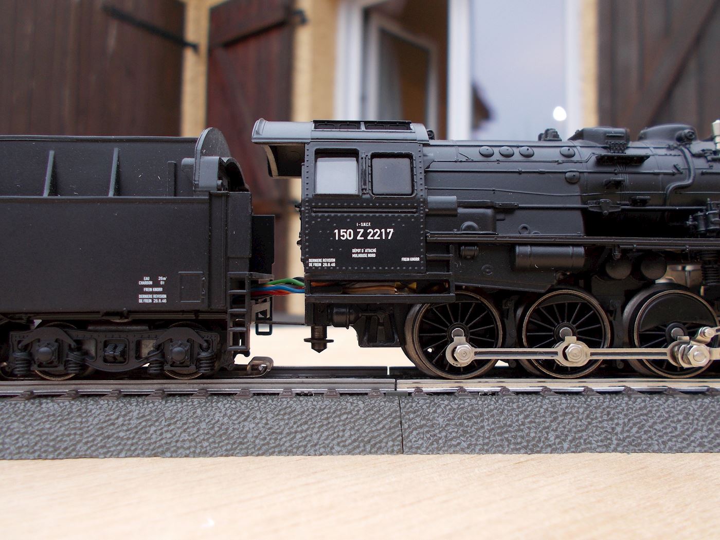

So let us start with my loco
The silver bell close to the chimney looks nice !
See the wide space between loco and tender...
..and the noodles of colored wires going through Blink .
This and also the place of the pickup shoe give us information about the reversing unit location...
When I first put the loco on tracks, the lady did not move.Blink
I then noticed that the 5 driving axles were completely blocked CryingCryingCryingCryingCrying

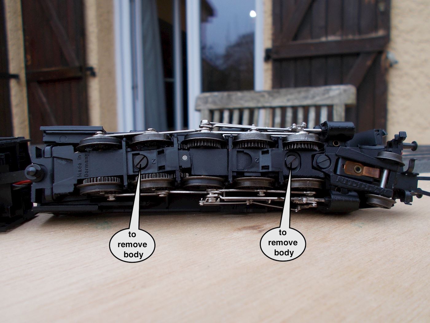

To find why the wheels are completely locked, the loco has to be opened
It is easy on this model even if the instructions leaflet attached to the box is not very accurate...
This loco is almost similar to the 3084 model.
For the loco body, only two big screws
on this magnificent articulated chassis:

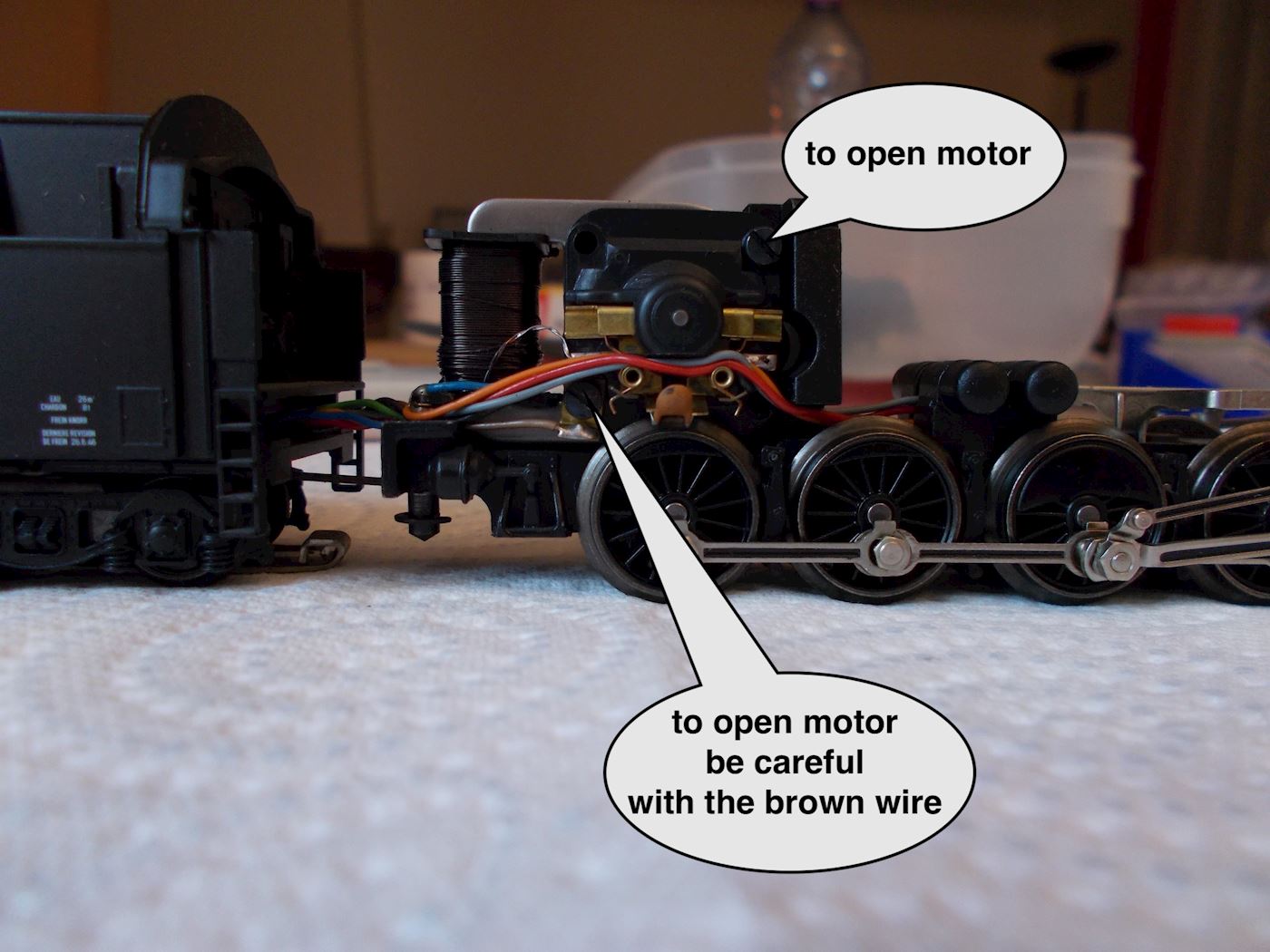

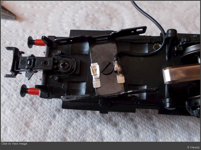

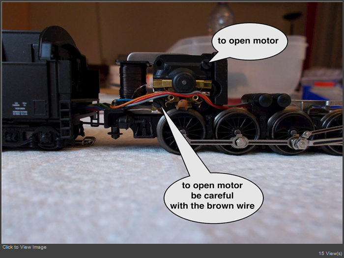

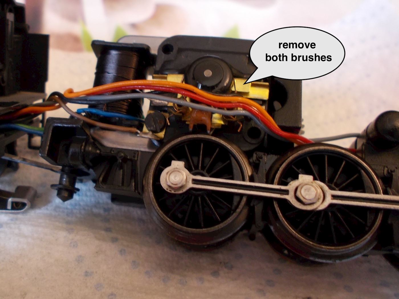

Now opened...
well , not much things inside:
the front bulb
the contact plate for the smoke generator
and the DCM motor.

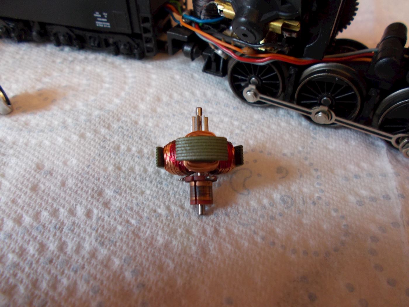

to solve the blocked wheels problem,
let's remove the rotor at first.
Two screw to remove:
don't forget to remove the two brushes
the three poles rotor is there:
Well some dirt on the poles
this proves that the machine has made at least a few turns
thanks 4 users liked this useful post by TrainIride

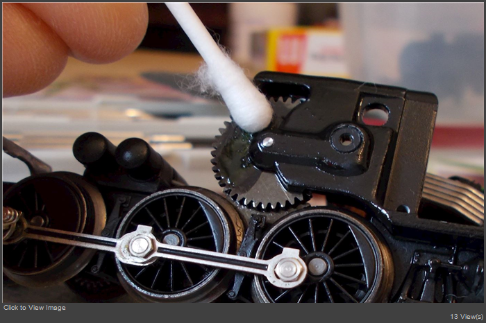

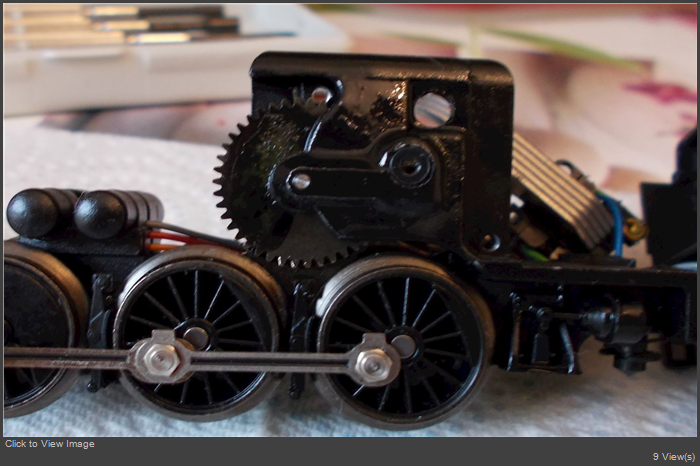

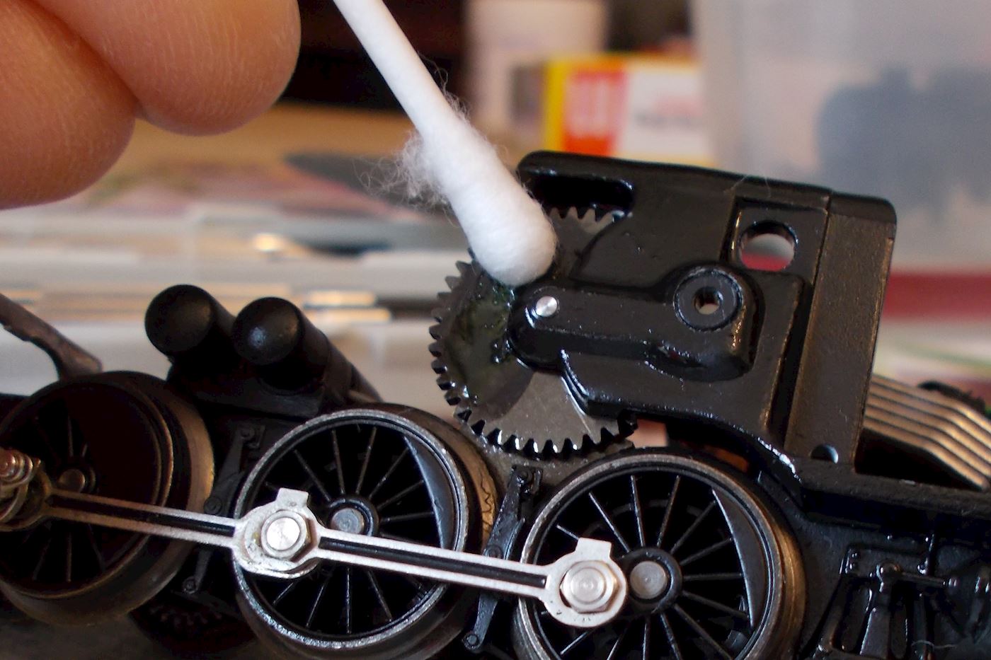

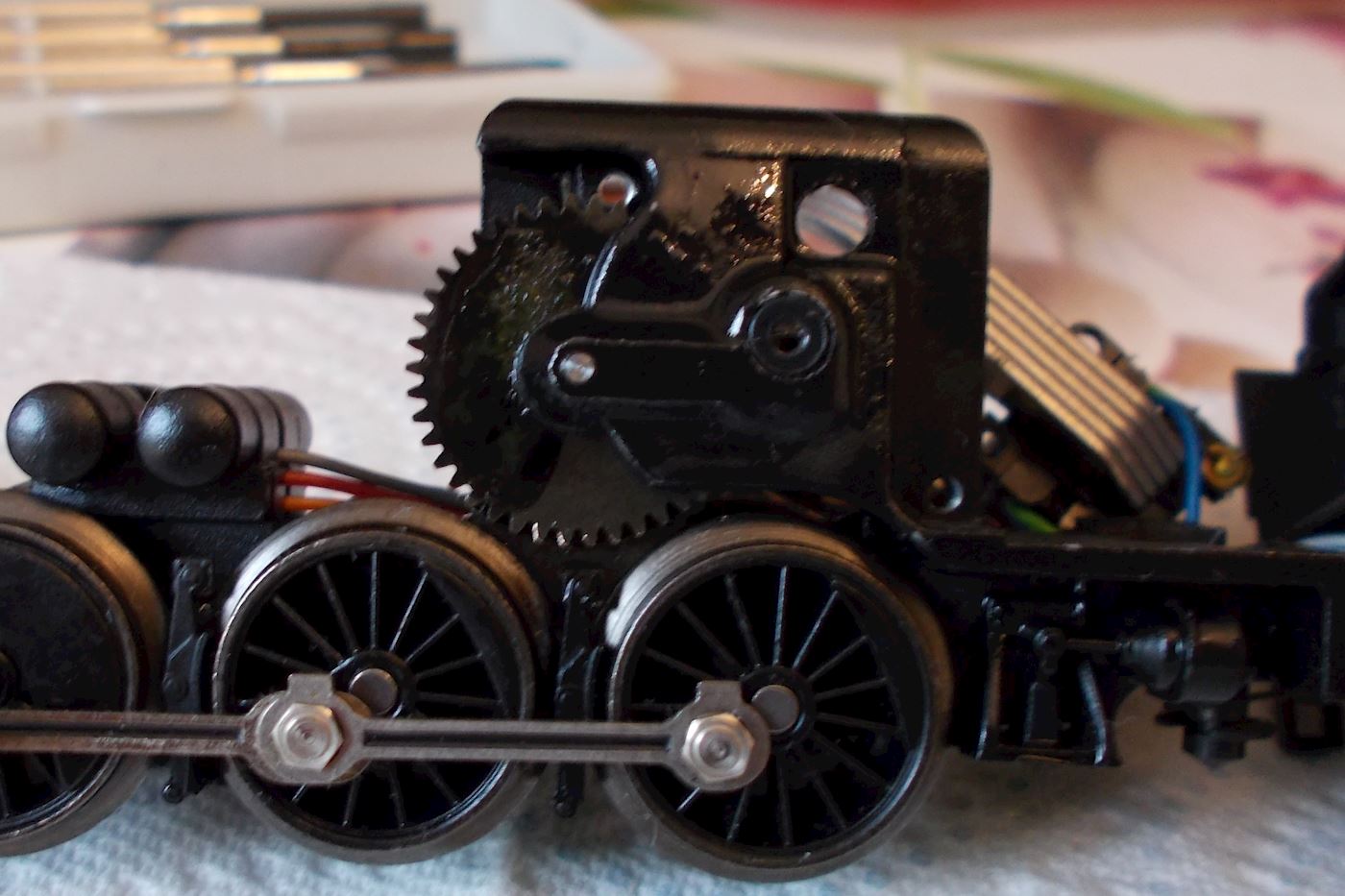

Well,
after unmounting the rotor,
the wheels were still blocked.
I delicately tried to move the axles laterally,
and there was no problem !
I finally found the responsible...
This big gear was completely glued to the metal side of the motor:
It is time to use some medicine ...
First sprayed with WD-40 (the blue bottle) to dissolve the old oil
turned into glue over time:
Wait a few minutes ....
The big gear can be gently turned now,
to let appear the glued thing OhMyGod
Now cleaned with alcohol:
I'm sure there are other recipes, but this one is mine, and it works...BigGrin
thanks 7 users liked this useful post by TrainIride

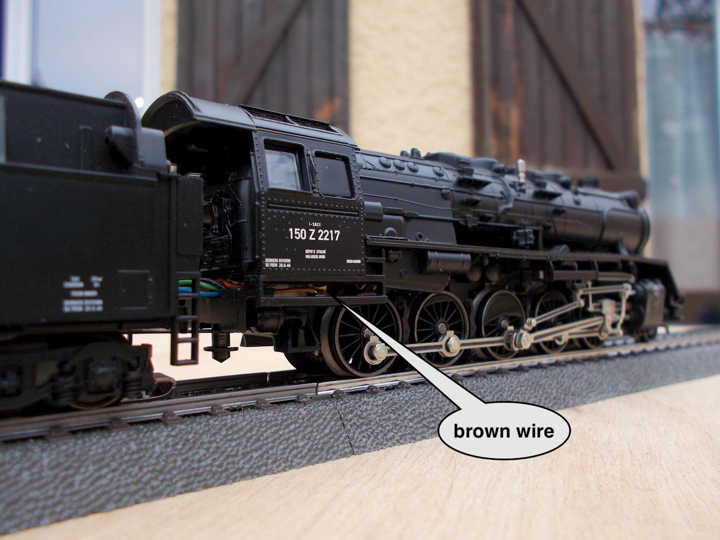

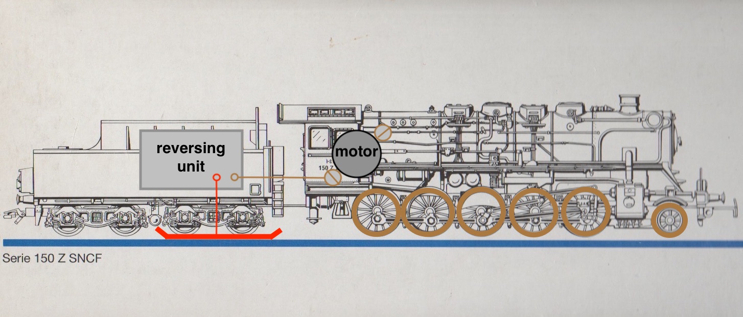

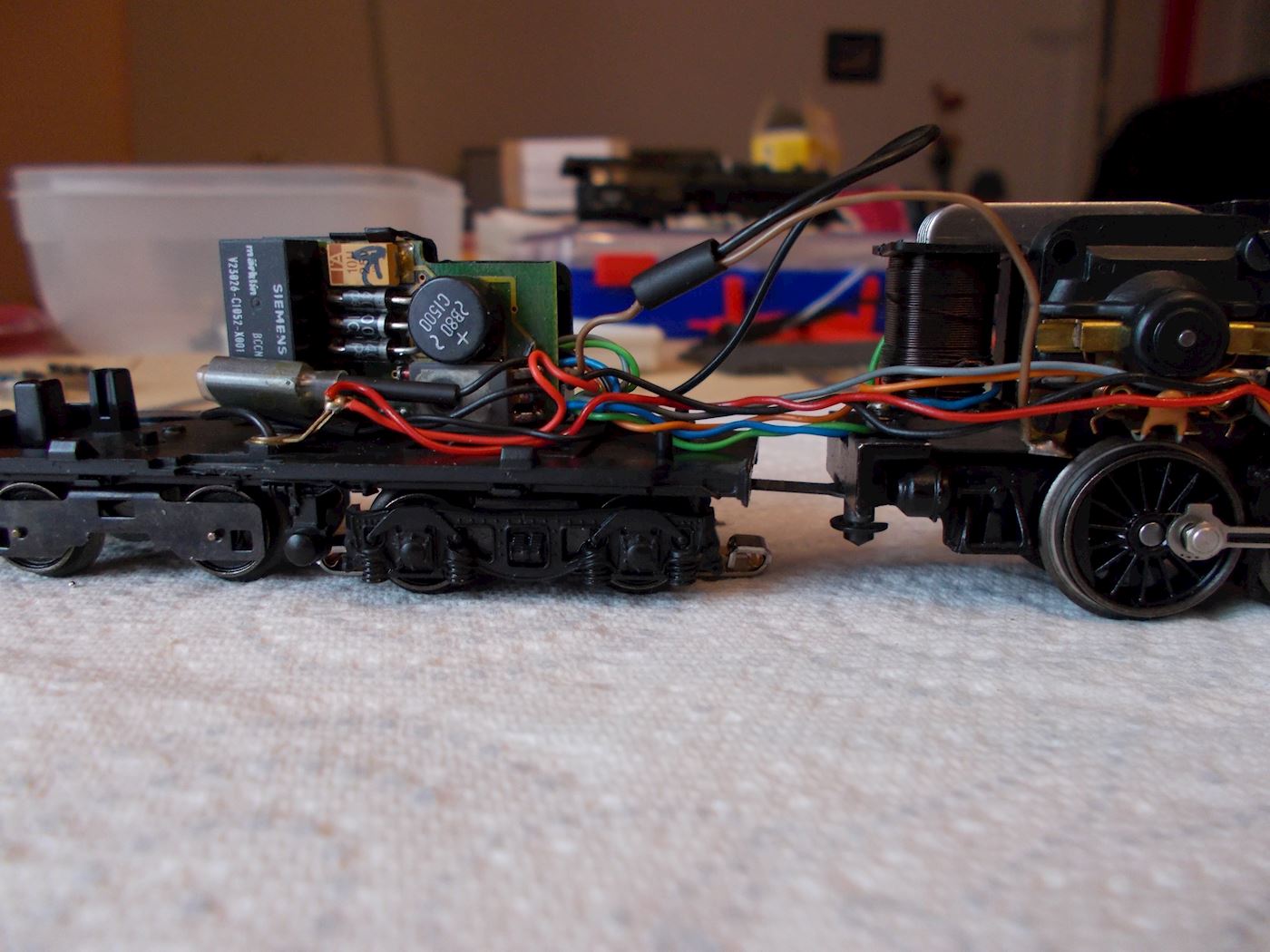

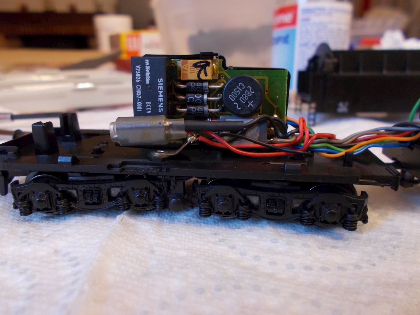

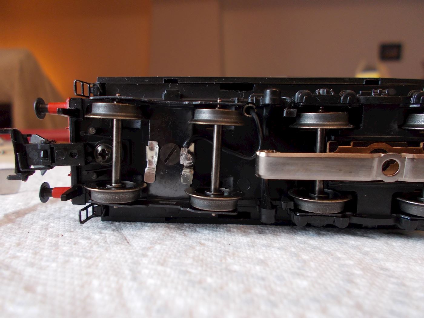

Chapter 2 : the Big Grounding Issue !
Well As Janne and Mark said in their posts, these 1990's models tend to be subject to ground issues...
...and my loco is a very good example Blink .
Let us have a look at the reversing unit input schematic:
The pickup shoe is under the tender and feeds the reversing unit with a red wire.
The reversing unit is grounded by a brown wire going to the loco,
this ground wire is connected to the loco metal chassis using one
of the two motor screws.
all the wheels of the loco connect the loco metal chassis to the tracks.
Looks good... ...theorically Blink
thanks 2 users liked this useful post by TrainIride

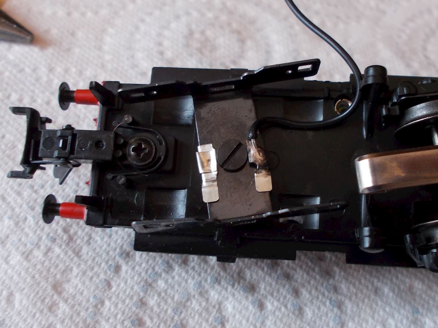

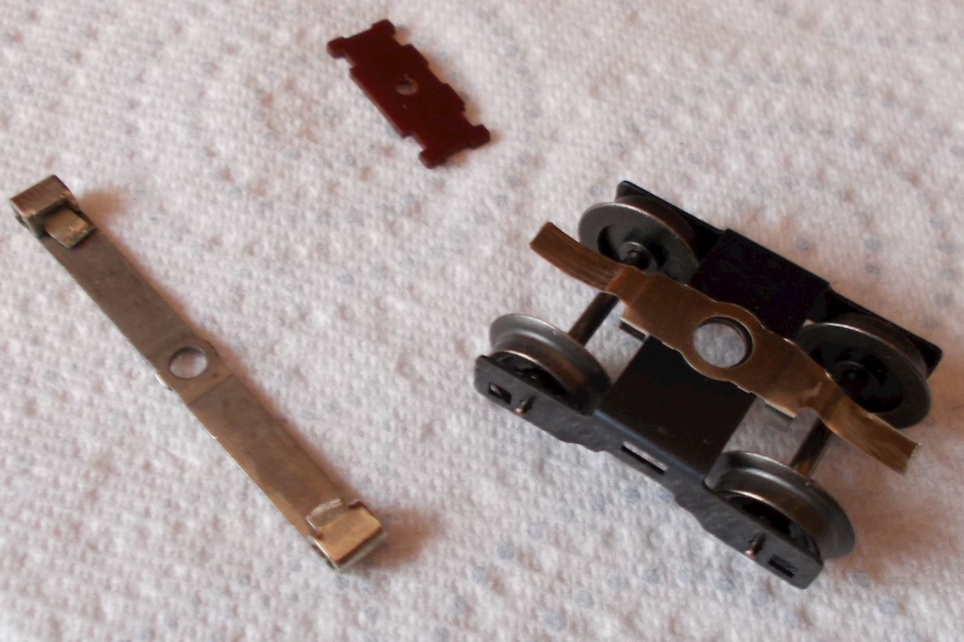

and for me this "too much oil which becomes glue and insulating coat"is terrific.
I have tried to clean my 3414 the same way I have cleaned all my previous models,
but no effect.

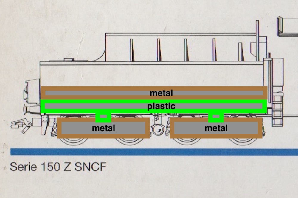

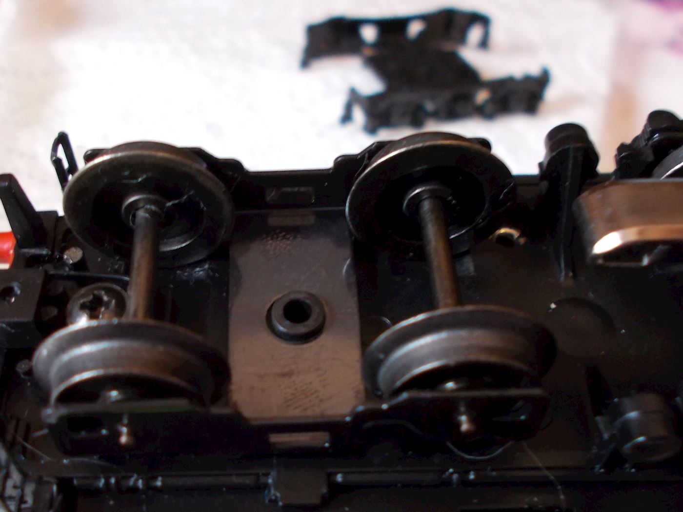

Soooo I have decided to find another solution and started my project:
and to modify the strange tender design that was originally:
thanks 3 users liked this useful post by TrainIride

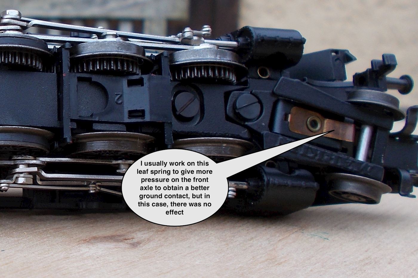

Hi Joël,
Have you cleaned every gear and every axle? I would try isopropanol instead of ethanol. It's much more powerful as a cleaner than ethanol. I buy it at the local pharmacy; it's cheap and very efficient. In my opinion, WD-40 is not a real cleaner, but a lubricant. It's an oily substance that I only use on door keys and locks. I don't think that removes all the old oil, and on top of that, WD-40 is not a recommended oil for model trains, is it? If you use that, your loco will run again, but you'll add a new type of oil.
What surprises me in this thread is the grounding problems with locos from the late 1980s or early 90s. I used to have a lot of those, and in recent years I've cleaned and serviced some that I wanted to sell or still own, but I've never had any grounding problems with them. Could the WD-40 be the cause of those issues? The only loco I've ever had a real grounding problem with was a digital BR 01 produced in 2015. The old vintage locos I've cleaned with isopropanol now run very smoothly, and this process has also worked out for locos with blocked gears produced after 1980.
I've quoted your photo of the chassis seen from below because it shows the places that need to be cleaned with isopropanol. You need toothpicks to clean every tooth of every cogwheel to get the grime out. Just dip the toothpick into the isopropanol. Before you use the toothpicks, apply isopropanol with a cotton bud while you turn the wheels (the brushes being removed). I use cotton buds and hold them against the inside of every wheel, above the axle, so the isopropanol trickles down and dissolves the grease on the axle. Try to move the axles sideways. If that is difficult, there is still some old oil. Even if you can easily move every gear and axle, there is now WD-40 all over your chassis, and that might cause the grounding problems.
Once you have finished cleaning the loco, use new oil sparingly. I use Faller Spezial Öler, product number 170489.
Just in case all of this advice does not help and the grounding problems persist: can't you send the loco back to the seller and ask for a refund? In case you used Paypal, you can threaten to open a dispute and force the seller to take it back. Locos that are sold on Ebay are supposed to work, except if advertised as defect.
Best regards, Mark
but no effect.
Hi Joël,
Hi Mark,
thank you so much for all of this !
But there must have been some misunderstanding,
I have only used WD-40 to dissolve the Big gear glue.
I never use it to lubricate loco wheels I use Märklin 7149.
I never had any problem of this kind.
Now all the gears are running absolutely free.
The only remaining trouble was this Big Ground Issue.
There must have been oxidation, maybe because of a seaside.
I don't know.
The solution I will show soon after had fortunately resolved the trouble.
Best Regards
Joël

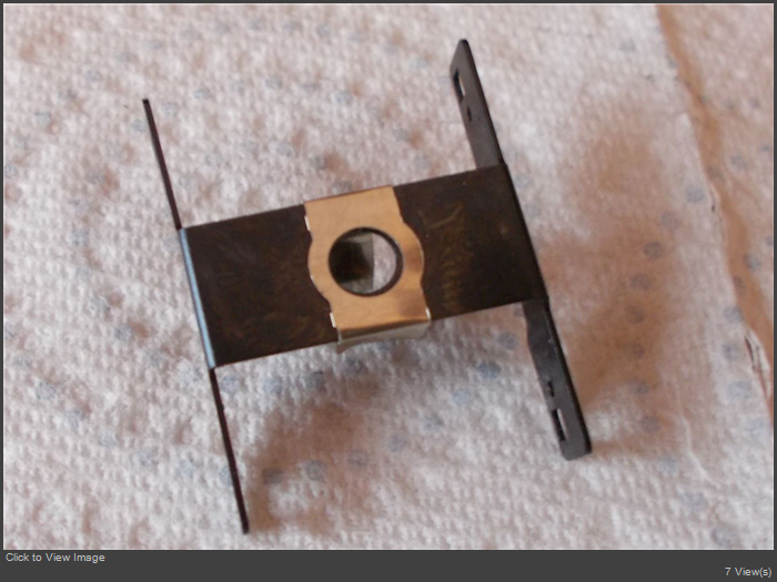

hereafter my DIY solution:
Let us have a look at the tender bogies.
after removing the plastic cover, we can see that the metal bogie
is placed under a plastic pivot.
this perfectly insulates from the ground Cursing .
a metal frame, like in the good old days, would have done the trick.
I thought about what could be used to ensure the continuity of the ground of the bogie.
I searched in my drawers and found an old used silver pickup shoe.
and I tried to find a reliable but removable solution, without damaging anything...
Offline TrainIride
#20 Posted : 18 March 2020 12:37:19(UTC)
TrainIride
Joined: 23/10/2010(UTC)
Posts: 2,083
Location: FRANCE

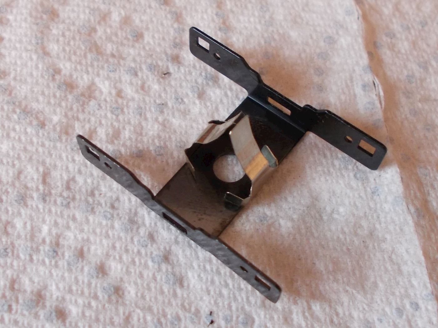

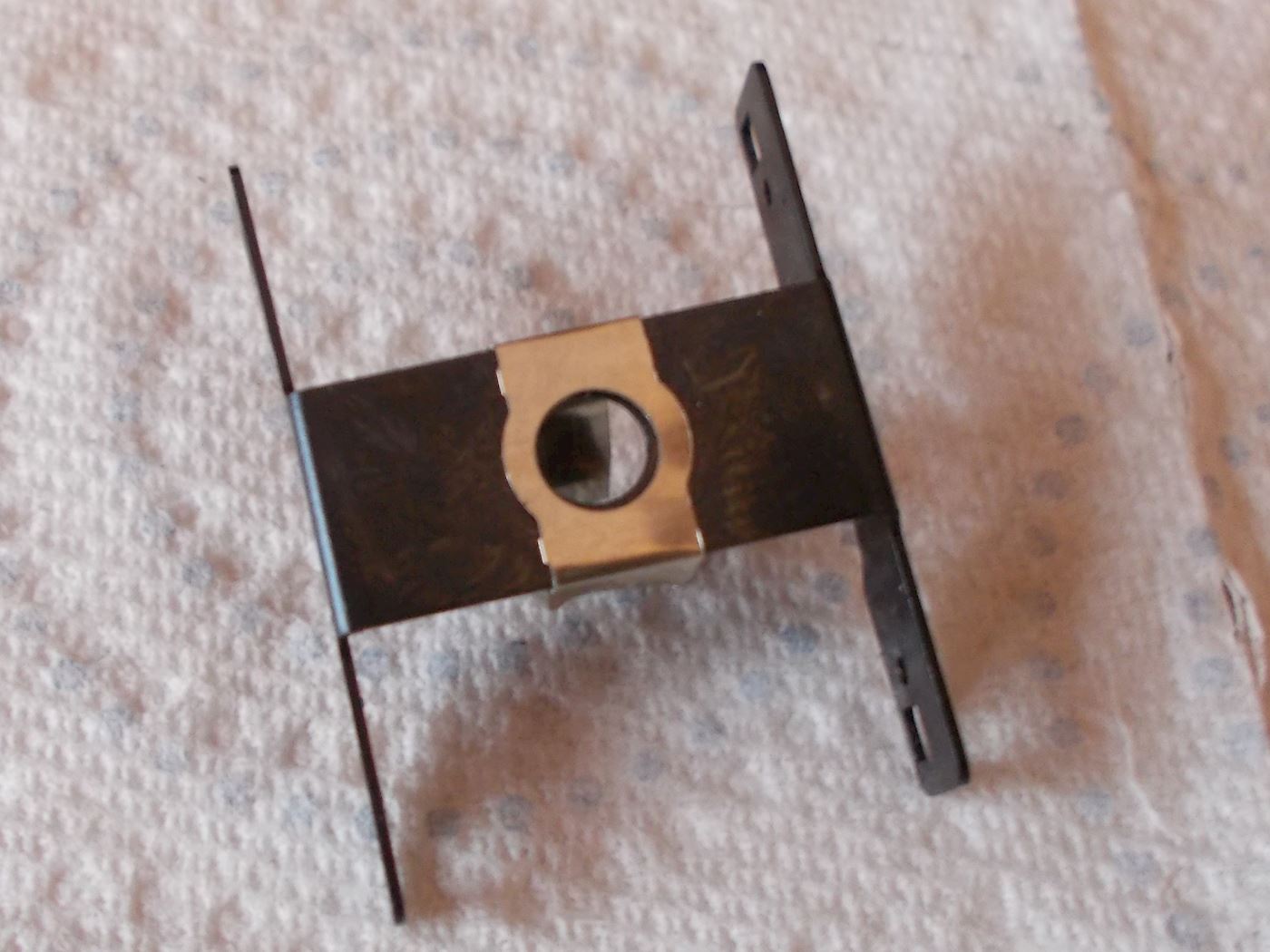

trying different solutions and finding a good setup for the silver spring....
The silver leaf spring is finally flattened with pliers, just after a black wire has been soldered on it.
Offline TrainIride
#21 Posted : 18 March 2020 13:44:11(UTC)
TrainIride
Posts: 2,083
Location: FRANCE
There is already a hole in the tender chassis.
the one created by the eyelet used to fix the lug for the other polarity.
Let's use it to escape the black wire.
The black wire is now soldered to the brown wire,
the famous brown wire feeding the loco ground to the reversing unit.
Best Regards
Joël

Preparing a consist...
...to show you the results
Best Regards
Joël
Offline TrainIride
#23 Posted : 19 March 2020 18:53:12(UTC)
TrainIride
Posts: 2,083
Location: FRANCE
Well,
not so bad BigGrin
Best Regards
Joël

Location: Luxembourg
I have only used WD-40 to dissolve the Big gear glue. I never use it to lubricate loco wheels I use Märklin 7149.
Hi Joël,
Your 3414 is still analog, isn't it? Given the fact that it has a drum collector motor, it runs very well now. I've looked up some information about WD-40. Yes, it can be used to clean metal parts, but apparently it's not a lubricant. Actually, WD means water displacement, so it was meant to be an anti-corrosion spray. In the Vietnam War, U.S. soldiers cleaned their guns with WD-40.
In another MRR forum, the experts on old tin plate trains warn against using WD-40 because it may get underneath the livery and destroy the paint coat. They wouldn't use it on model locos at all, not even on gears. In addition to that, it's more toxic than isopropanol. I service locos inside our house, so I really couldn't use WD-40 there.
My main reason for not using WD-40 on model trains is dosage. Once you press the button, too much of that stuff comes out. The same goes for Märklin's oil (7149). The Faller oil is much more user-friendly thanks to a very thin metal dispenser.
Many Ebay sellers use WD-40 or some other spray to make blocked gears turn again because this allows them to claim that the loco works. In most cases, this is followed by the foolish tip to add some more oil. A look at the discolored bottom side of the gearbox tells me that some kind of spray must have been applied generously to produce fast results. I'd rather buy a loco with blocked gears and service it myself.
Best regards, Mark
Hi Joël,
Hi Mark,
yes the loco is still analog, with its original 3 poles DCM motor !
And you know these are the first turns of the loco wheels,
I am sure after a good break-in, the idle speed will be better again.
Thank for your inquiry on the WD 40
I use very little, often outdoors, and to control the amount, I spray it on a cloth or cotton swab.
I never saw any damage to the paintwork unlike when using alcohol 90.
The WD 40 saved the M-tracks of my previous layout from rust
after the house air extractor broke down, during holidays.
Thank you for all your help and advice.

Hi Joël,
It's true that alcohol, especially isopropanol, needs to be used with great care on MRR items. It damages plastic parts as well as paint.
Anyway, you've done a great job on your loco. It now runs better than what might be expected of an analog drum collector motor, and it will probably improve with time. I was intrigued by your thread because I used to collect this type of loco and I'm interested in analog locos. Documented stories like yours that include lots of photos and videos actually help other Märklin users assess which items they might (or might not) want to buy in future.
