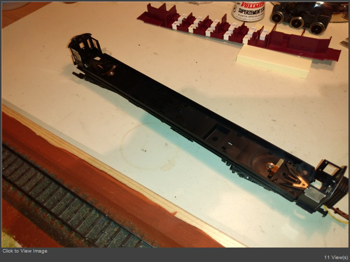

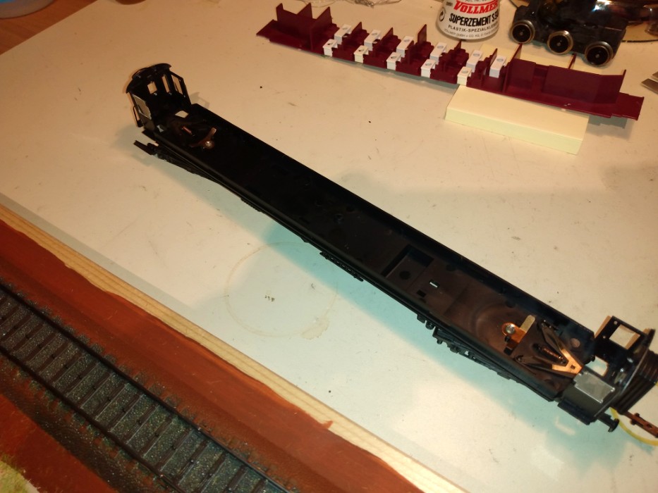

This time, I noticed a clicking sound coming from the coaches when parked, and my Marklin signals were flickering with the clicks.
So I dissassembled one of the baggage cars (with pickup) and one of the coaches, and found that there is a rather large Electrolytic capacitor on the circuit board, connected to ground. Thinking that this might be for interfernce suppression, I removed them and now the lights continue to operate normally and the clicking is gone. The signals no longer flicker.
Thought I'd ask the experts here about this before I dissassemble all the coaches and remove the capacitors.
Am I on the right path here?

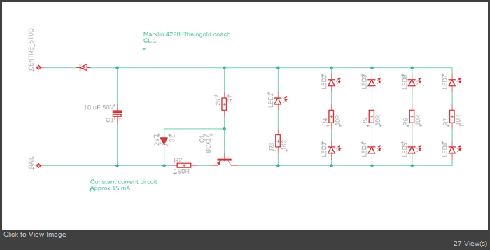

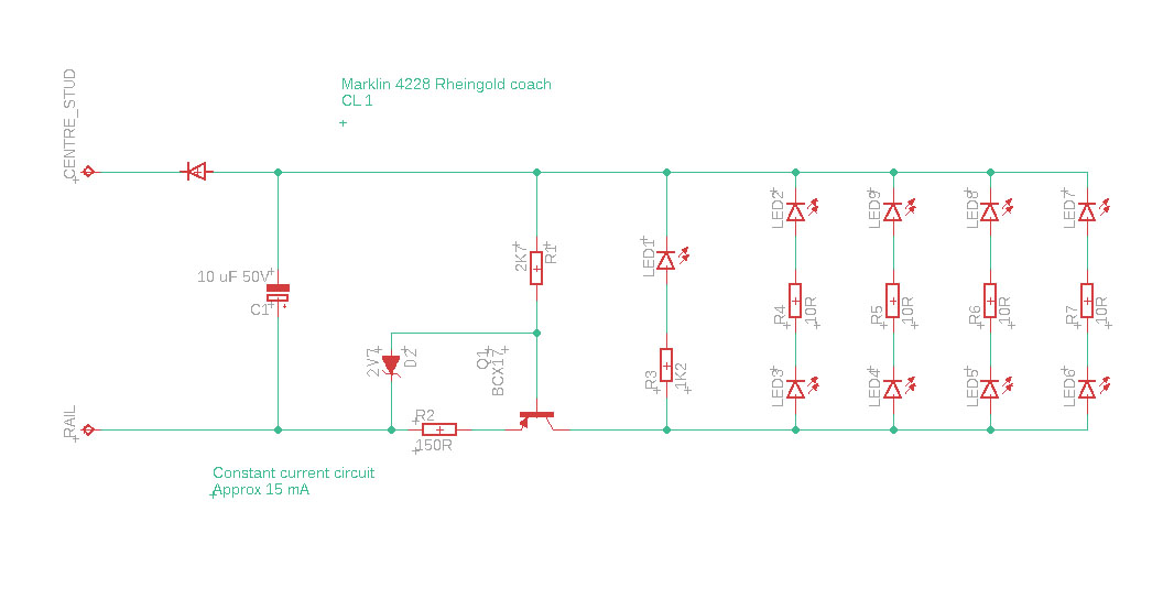

Below is the schematic diagram of Marklin 4228 (Class 1 coach). Class 2 coach will have different resistor value, and more LEDs (thus, different current setting) but the circuit is still the same.
It is a current regulator circuit, which provide around 15 mA.

Zener diode behave similar as rectifier diode if the applied voltage is less than its break-down voltage.
Probably you should connect the circuit to track, then measure the voltage across R2 (resistor between transistor and zener), which should be around 2V to 2.5V if the zener is 2.7V

Rectifier Diode: Fwd bias .586v, Rev bias 0 v so this seems ok.
Zener Diode: Fwd bias .675v, Rev Bias .805v
I think zener diodes can pass current in both directions if a certain voltage is applied, not sure if this is a good result or not.
The LED's all check out ok, fwd 1.717v, rev 0
The voltage across R2 is 2.20v in baggage car, and 2.14v in 2nd class coach.
However, I noticed that when I had the curcuit board out of the chassis and connected to track power via alligator clips, no clicking, even with Mfx. When I replaced the curcuit board into the chassis, the clicking resumed. Interesting.
So I dissembled the bogies completely and cleaned with rubbing alchohol and polished the ends of the axles. Continuity check was good, but I cleaned anyway. However, still clicking.
The chassis are plastic so no shorting possible. The current conducting coupling assemblies look normal.
The chassis is very simple, so this has me quite puzzled.
The clicking only occurs with Mfx active.
Stay healthy and safe!
Best Regards,
Don
___________________________________________________________________________________
TFT ECOS, C track and Z scale, mostly DB/DR and SBB, SJ

Hi Tiono,
Yes, clips were positioned per photo.
I bent the ground clip and coupler contact springs upwards slightly to increase contact pressure with the circuit board, didn't help.
There is probably something simple I am missing....Confused
Best Regards,
Don

may be try this way:
Put the board back into the chassis, but without the metal coach body. Just the plastic chassis + bogie + board. (you can put the interior seat back, should not be any difference since it is plastic)
Check whether the problem is still happening.
- if the problem disappear: probably the metal body intermittenly in contact with the board or other electrical line.
- if the problem is still there: try connecting the center rail to the protruding metal stud below the chassis using alligator clip (this metal stud is the one soldered at the board, next to capacitor). Then test again. If problem disappear, then the suspect would be the conducting-coupler mechanism.
if the problem persist: try connecting the outer rail to the wheel or the center pin below the bogie, using alligator clip or a cable. If problem disappear: the suspect is bad contact of the bogie-wheel-center pin and rail.
thanks 1 user liked this useful post by tiono
Offline Donb
#19 Posted : 19 March 2020 18:21:44(UTC)
Donb
Joined: 03/04/2013(UTC)
Posts: 309
Location: Fraser Valley
Using this process of elimination, working back from the circuit board, I have found that the audible clicking begins when the rail alligator clip is attached to the bogie sidebars. The red wire can be connected to the coupling or center pin, no difference.
So I disassembled the sidebars, polished and cleaned the mating surfaces and applied some dielectric grease. No improvement.
I then applied more weight to the coach chassis, still clicking.
Then I attached alligator clips to clamp the side bars to the bogie pivot plate. Still clicking.
Then I applied dielectric grease to the axles/side plate holes, no change.
As a next step, I think I'll disassemble the bogie (yet again) and apply dialectric grease to the bogie pivot plate/ground pin interface.
Other than that Ive run out of ideas.
Best Regards,
Don
