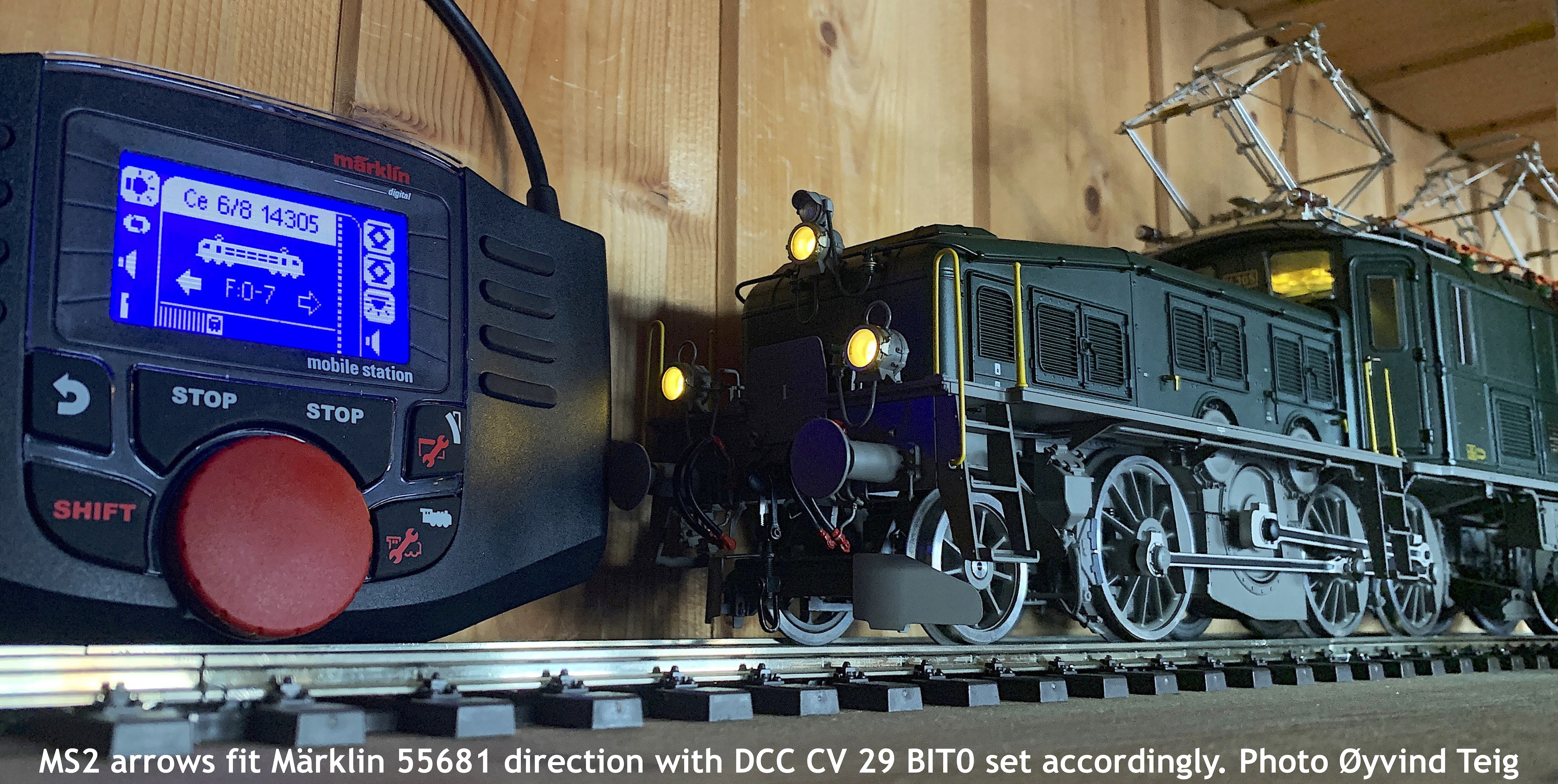

Thank you, rayF! So I did this:
  1. Starting with the loco registered as mfx+ and having a copy of its setup on an (orig) loco card
  2. I set the protocol to DCC only
  3. I deleted the loco
  4. I added a "Kroki DCC3" as my new loco, with address 3
  5. I changed CV address 29 value 0x06 to 0x07 to have the direction BIT0 set
  6. It worked, the arrows on the MS2 now point in the same direction as my loco on my 2 m. shelf track
  7. I saved the loco to another loco card
  8. I deleted the loco again, since I did not want to set all the icons etc.
  9. I added the loco back again from the (orig) mfx loco card
  10. I changed the protocol to all three: mfx,DCC,MM2
  11. The loco now runs mfx and the arrows on the MS2 are ok!

MS2 arrows fit Märklin 55681 direction with DCC CV 29 BIT0 set accordingly. Photo Øyvind Teig
I also forgot to tell why I just didn't want to turn the loco around! It was because I wanted to see the driver in the I end from where I normaly stand.
