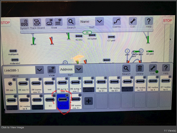

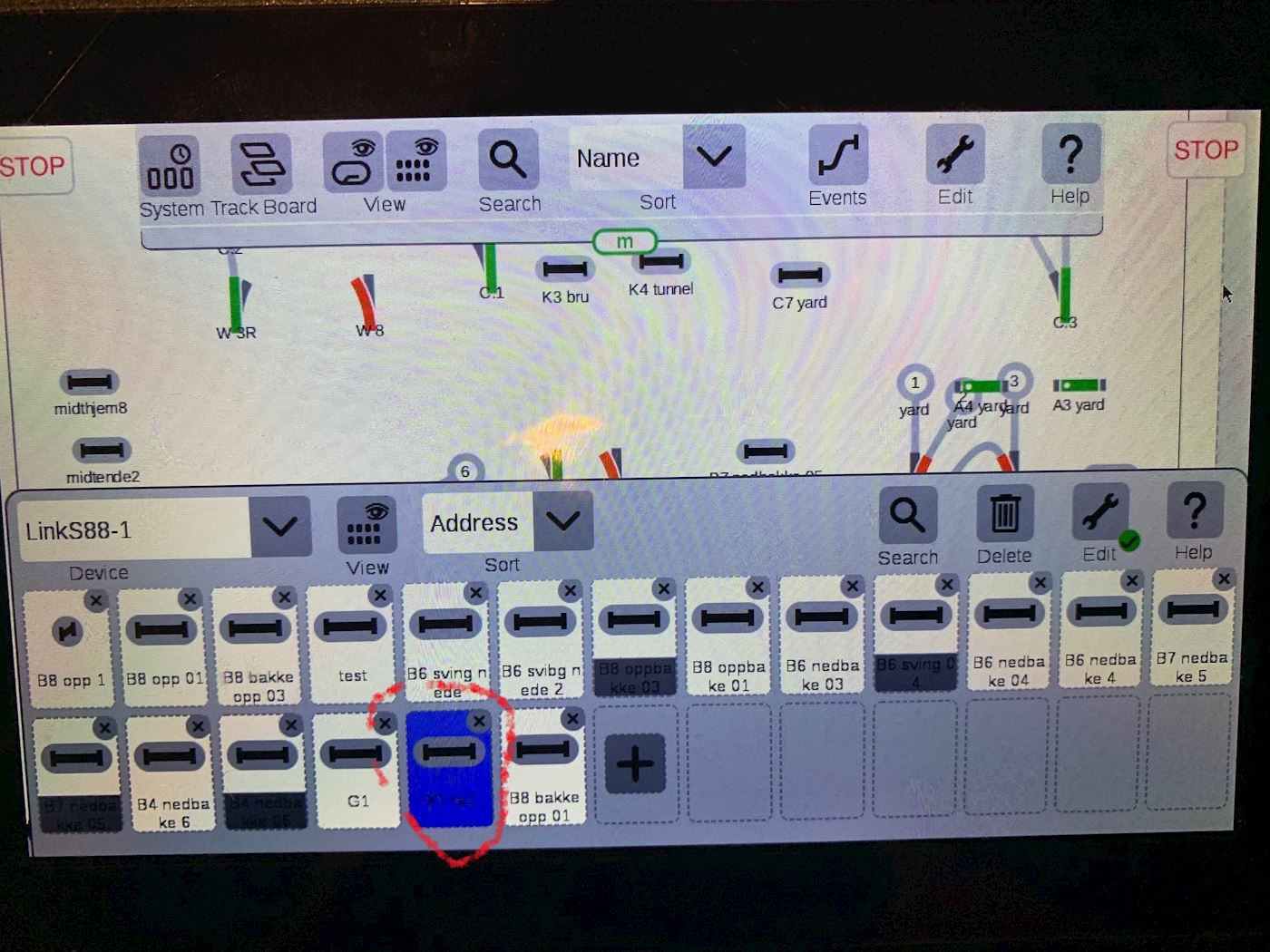

Where is my new contact,can not see it on trackboard.
I'm trying to make a new event but I guess I need to grab the contact from trackboard.
I've just upgraded my cs3 to version 2.0 and the menues/screen on cs3 have changed.
Is there any explanation how to do things in the "Edit article list"window?

Offline geir
#3 Posted : 10 December 2019 17:44:33(UTC)
geir
Joined: 02/03/2019(UTC)
Posts: 91
Location: Hordaland, Bergen
Hi.
The drag and drop doesn't work for me either.:(
