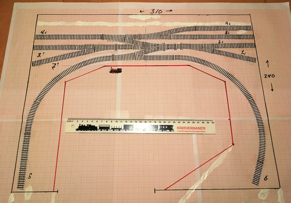

Hi Stefano, here is the track plan(1:6) and as you see, the room size it is not big. I could run trains around the room with 1020 curved tracks but then it was no space for sidings. If I want to run longer trains I can use my Z or HO layouts so that was not the point here. I got more tracks with sidings.
All tracks are Märklin - curved track 1020 mm - controller CS3 and MS2 - buildings 3D print and wood - motor turnouts Tortoise - light 3 V.
There are no bypass here so I need 2 locomotives to handle the cars. I have different scenarios or schedules for moving cars. Smart ideas are always welcome.
It is fun to build in this scale and fun to run.
Happy new year.
Torstein
thanks 10 users liked this useful post by Torstein

Your tracks plan is really interesting, especially because in this way you're allowed to do a lot of operation. I've too an H0 and Z Märklin layouts and collect Spuer1 too. The idea of 3-Ways Turnout in the middle allows you to save a lot of place. So the sidings in the upper cover a place of 100 x 310? Doesn't it? I need to build something like that! Anyway, thank you again and a lot of compliments!
Stefano

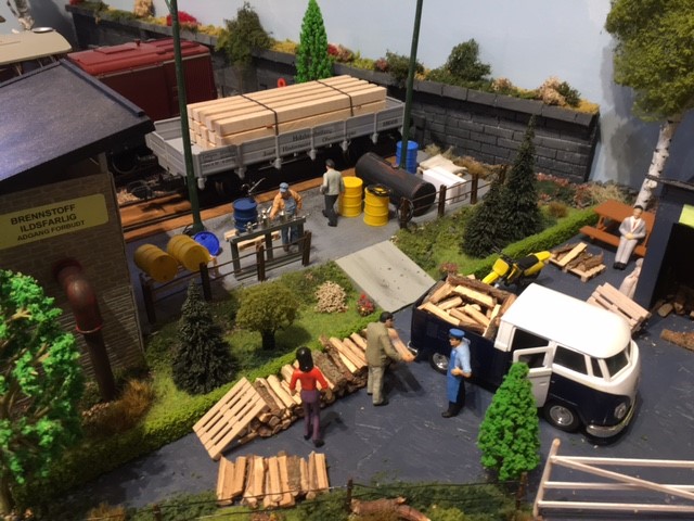

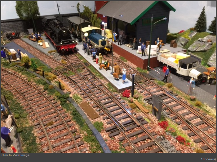

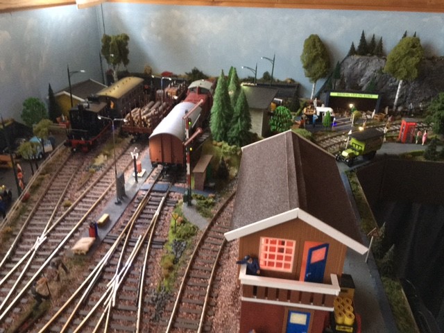

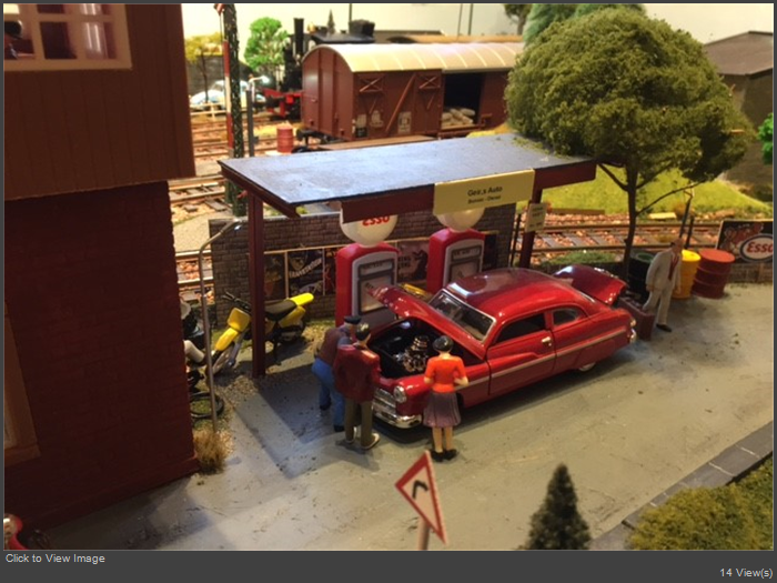

Time to pop up this thread….
Another year have gone and I am still working on my little gauge one layout. This year I got a new steamer and some cars but most of the time I put on details to make it more complete. Automatic running (event) has also been done with the CS3.
In the meantime, I have met a lot of gauge one people, it sems to be more and more who turn over to this scale in this country.
Have fun. Laugh
Torstein
Some pictures…
