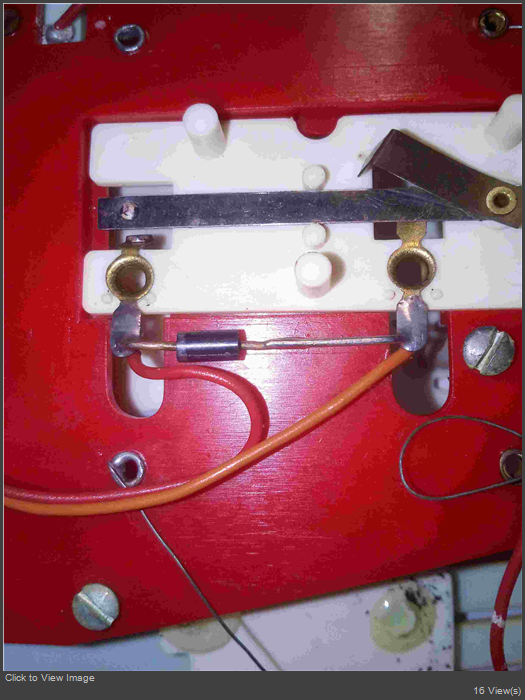

Here are two snapshots of the silicon diodes inside the Faller AMS 4030 and 4702.

There are not any silicone diodes made by Faller, the original diodes that Faller used were made with selenium which was cheap and nasty. The selenium diodes have a voltage drop between the cathode and the anode higher, almost 2.5 times higher than the silicon diodes, which means the motors will have less voltage available to work, so the cars will run slower. Another problem is the reverse current that is also much higher in the selenium diodes, which means the hand-controllers will be interfering with each other because of lack of isolation. If you want the hand-controllers completely isolated and the cars runing at top speed then you must replace all the selenium diodes with silicon diodes. For each hand controller you need one diode, so if you use four hand controllers then you will need four diodes. For each car you also need one diode, so if you use four cars then you will need another four diodes, in total you will be replacing eight diodes, four in the hand-controllers and four in the cars. Good luck!

It is a very long time since I was running Faller AMS cars, but I remember I had some device with diodes, that was intended to allow you to run two cars independently on each track. In total 4 cars independently. This was in the late 60's. I noticed that the cars did not run independently. The first attempt to fix it was to replace the selenium diodes with silicon ones. But it did not fix the problem. So I analyzed the wiring inside the device and concluded that it was designed incorrectly. This was the major reason for the non-independence even though the low quality of the selenium diodes made it even worse.
I built my own device instead. It worked well. Maybe there are different versions and maybe there are original Faller devices where the wiring mistake is fixed. But at least the device I had was non-functional by design.

Hi Perz, the problem is you forgot to replace the four diodes installed in the Faller AMS contact shoes. It is not enough to replace only the four diodes inside the controllers (4019, 4020 and 4030) and track (4702).

Then, I only had one type of device. There might be other types of devices, that only had the problem with the selenium diodes themselves, not the design error. I can't judge from the pictures whether this is the same type I had or another one.

Hi perz, I don't have any doubt that your Faller controller was wrongly wired and you are right about the low quality of the selenium diodes. One can only blame Faller as around 1976 they were already fully aware of the low quality of their diodes, the proof is that they do not installed selenium diodes in the Faller AMS 454 (451+453) but silicon diodes!
