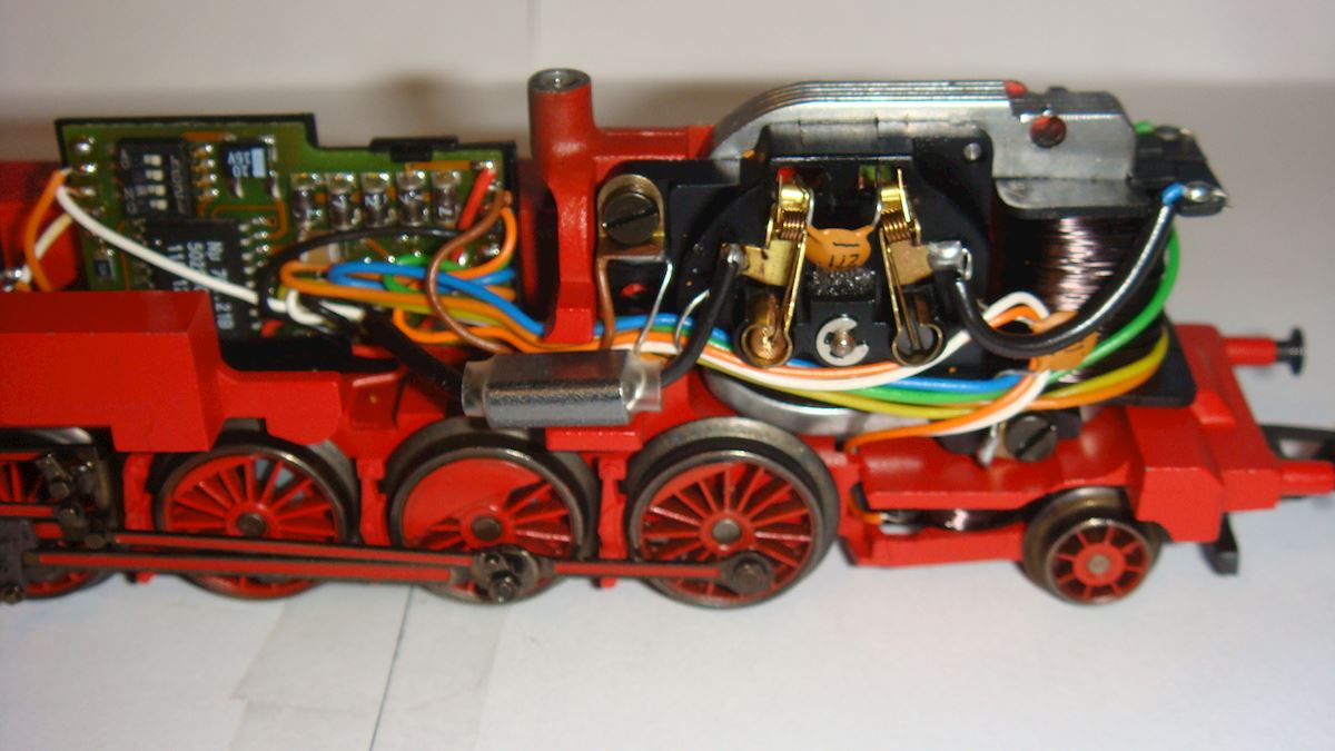

Hello.
Most of my trains are analog, but I do have one that I think may be digital or delta.
Model 86582.

Hi Karl,
According to Helmut Kern's excellent website, 86 582 is from one of three starter sets, 29535, 29537 or 29538. All three of these are Delta locos so there is no doubt that that's what you have. In fact because it has the large flat commutator motor it has to be the loco from the 29535 set of 2001 if Helmut Kern's site is correct.
In any case the decoder in your picture looks like a delta decoder in my opinion.

#4 Posted : 19 October 2019 19:33:14(UTC)
Originally Posted by: Karl Go to Quoted Post
Hello.
Model 86582.
It looks like the BR 86 582 has the Maerklin article number 3096.11 and started 2001
http://maerklin-sammler-...omotiven/03096/03096.htm
with the starter set 29535
https://www.maerklin.de/...s/details/article/29535/
with its new manual for digital DELTA locos.
https://static.maerklin....df0232829f1434542610.pdf
But already this BR 86 looks like my BR 86 (art. #37862) from 2013.
https://www.maerklin.de/...e/details/article/37862/
It seems to be the BR 86 never gets old.BigGrin

Hi Karl,
Hope this helps.
You have a märklin delta 66031 decoder with a 701.21b chip.
