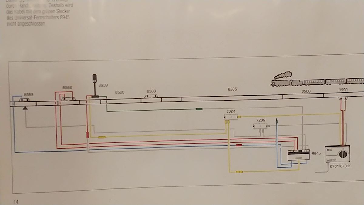

Need wiring assistance for controlling block and signal via the relay. Any help with either would be appreciated.

From 0294 track planning book use the 8939 wiring as it is the same signal ... Note train direction is right to left
Also on my product page i have an alternate updated wiring diagram and it's rotated 180d from the 0294 diagram (train moving left to right). And Märklin Germany informed me that 8945 should slot in same as 7244 as shown in this diagram (meaning 8945 uses 67014 or 67271 accessory voltage to run 89391)
https://zscalehobo.com/marklin/89391.html
What is missing from this that is still holding you back from finishing?
That should definitely do it, Frank. Thanks, as always.
