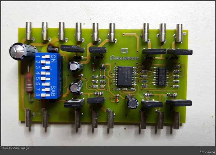

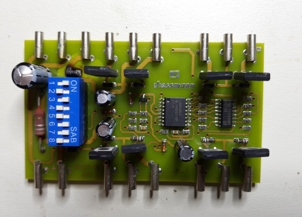

Does anyone know the specs or diode type for the Viessmann 5211 switch decoder? Diode D12 suddenly let out the magic smoke last night while I was working on a totally different area of the layout.
Burnt diode
I might be able to get a partial number off of it when I unsolder it from the board, but part of it is gone if I compare it to diode D2.

Just guessing, it looks very 1N4001-ish BigGrin
Maybe you could unsolder D2 and see it you can find the numbers on that, or if you have other 5211s, have a look at them.

Hello Peter,
I don't own 5211, but I've built many 5291 (kit to solder, no more for sale).
Looking at the schema, the diode D12 is 1N4936.
However, the schema is not exactly the same as your photo, but there is good hope...
I provide the doc of the 5291.

Hi Peter, sorry to see such damaged product.
D12 certainly was subjected to severe overcurrent in the forward direction, more than 1,0 Amps. Alternatively subjected to severe reverse voltage exceeding 50 Volt ( 1N4001).
If the current was supplied by C 2 or from there around, the copper tracks underneath, and feeding D12 should also have cooked. See if track discolouring has occurred.
So replacement of the diode by say 1N4005 or higher will be OK.
Sorry I do not know Viessmann products, but looking at the third terminal on the above PCB there may very well have been a real problem that was connected to it.
It would be wise to check those items connecting to the "output " terminals.
Chances are good an external fault is the origin of the problem.
Hope you manage,

I have some 1N4935 diodes which are what I needed to repair a K83 a few years ago. Not sure what the difference is between a 1N4935 and a 1N4936?
Anyway it puzzles me why it failed since it controls uncouplers in a switch yard that I have not operated in at least a year. Testing the uncouplers did not reveal any problem, but this yard is my brittle C track yard that to a large degree is held together with glue. If I try to take the uncouplers out for a better look inside, I will end up with a cup full of broken C track connectors. So for the price of a diode I think I will repair the decoder and give it another try. If that diode blows then I know another chunk of C track and switches will end up in the garbage.
Hardly any trace of damage below the PCB. So a little careful cleaning should be all I need.

I suspect Peter has a 5291 K83 given the component markings on the circuit board. I made up a few of these about 12 years ago and I recently picked up another one from some items our club was selling.
In the instructions, D12 is listed as a 1N4936 (I see Fabrice already answered this question in his post).
I mentioned in another thread a few months ago that I had been greeted by some electrical smells when powering on my layout after a few months of not using it. Turned out it was a 5211 that cooked - you can see the component just above the DIP switch has cooked (not sure what it is) and the capacitor to the left has popped its lid.
You can see similar components in behind the large transistors.

I replaced the diode and had to add some jumper wires on the back since the 2 soldering pad leads were damaged and would not accept any more solder even after scraping off the varnish.
It is back in place and all the devices are connected back in and working fine. Still puzzled why this would suddenly fail in an area not being used for quite awhile. I believe this is one of the units I bought on eBay a few years ago and it may have been over-stressed by the previous owner and suddenly failed.
