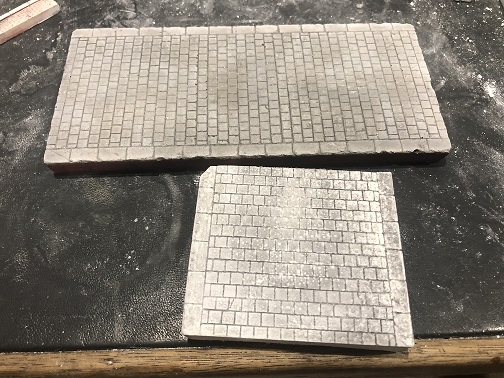

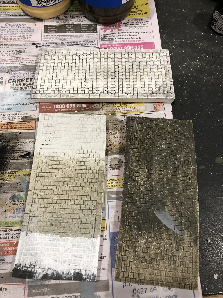

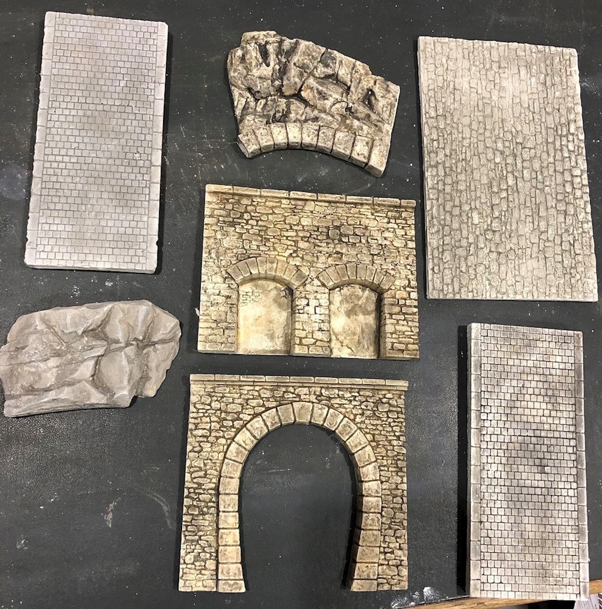

I'm using a lot of plaster forms on my layout and I am being thwarted by inconsistencies with painting.
The problem is a lot of my casts are not soaking in the water paint as they should but seem to be repelling it as though the plaster is sealed (when its not)
I have tried painting soon after casting or many weeks later, though I have not been methodical about that. I am using the same brand plaster, fresh and cast fresh.
I use a flow agent on all my casts, provided by the mould supplier (spoerle).
Can anyone explain what is causing this problem? Is it my plaster mix, or flow agent, or the timeframe after which I start painting? or something else?
Examples below, two pieces that would not soak any paint:
And here we have another two examples. The top one was perfect in absorbing the paint and was a test piece. The one below absorbed paint but certain areas didn't, so still unusable:
My original thought was since I am in Brisbane that the high humidity is causing the casts to absorb moisture from the air and seal themselves after a certain time of exposure.
However I then tried painting a really old cast and it was perfect, so then I thought I was not waiting long enough for the plaster to cure.
That was also inconclusive as other old casts I have painting would not absorb paint at all!

Offline applor
#18 Posted : 14 June 2019 13:36:39(UTC)
applor
Joined: 21/05/2004(UTC)
Posts: 1,769
Just tried painting a cast from over a week ago with no wetting agent.
It was still resisting my water paints. I tried on the back and found the same level of resistance.
The way I see it, it is either my plaster:water ratio or the cure time. I have read it recommended they cure for a month.
It may be the week was not long enough and could try speeding the cure in an oven
I have been painting my other casts with 'normal' paints and it's gone quite well.
Edited by user 15 June 2019 05:29:36(UTC)  | Reason: Not specified

Offline applor
#19 Posted : 18 June 2019 12:50:27(UTC)
applor
Posts: 1,769
On the left we have my two casts that painted great, the rest are all over washed because they wouldn't stain properly.
Since the problem is not the wetting agent, that leaves the plaster - something I ruled out earlier since I have done casts that painted well.
A Stummi member however has come across my problem and found the plaster was the cause - different batch qualities despite being the same brand etc.
Moving forward then it seems I have two options:
1) try a stronger WS paint blend, or mix with matt medium so that it paints on the surfaces instead of washing into the cracks
2) purchase a different casting compound - a shop nearby sells hydrocal for a reasonable price. Quite possibly will resolve my problem but theres a chance it won't.
I could buy WS lightweight hydrocal which would work but its just so expensive here.

Offline applor
#22 Posted : 26 June 2019 06:58:46(UTC)
applor
Posts: 1,769
Well I am just back from a brief 4 day holiday. I have done a number of tests though.
First I tried painting a platform with my water colours in a higher concentrate, I think I did 1:4 instead of the standard 1:16.
It did not come out well. Richer colour but still patchy and spotty due to different amounts of paint being absorbed.
This is shown in the middle.
Second I tried painting the platform with my tamiya acrylics at full strength. Too rich and an uneven finish. I think they are too pigmented and too runny, rather than cheap acrylics that have a heavy use of binder.
This is shown on the left.
Right platform is for reference, my original stain that come out correctly.
After returning from my holiday I tried staining a rock face plaster case I did a couple weeks ago. Perfect staining with my water colours, as it should be.
This is actually a new mould and no flow agent used:
So with that in mind, I decided to try normal staining on a platform I had cast with not only the exact same bag of plaster but also the same mixed batch and with no flow agent used.
As you can see below in the top picture, it hardly took any paint at all! So why did it fail but the rocks did not? Perhaps the previous repeated uses of flow agent have altered the mould?
I also tried using a primer/sealer and then water colours. I did the top half with sealer and then normal 1:16 watercolour stain. Way too weak, you can't even see the colour now.
The middle half I used my 1:4 watercolour stain. It come out alright though the brush texture of the primer shows. It might be an option.
My last option is to buy a bag of hydrocal and cast a platform to see if it stains with water colours or not. Otherwise my options are to either use a primer or buy new acrylic paints that won't be affected by the plasters porosity.

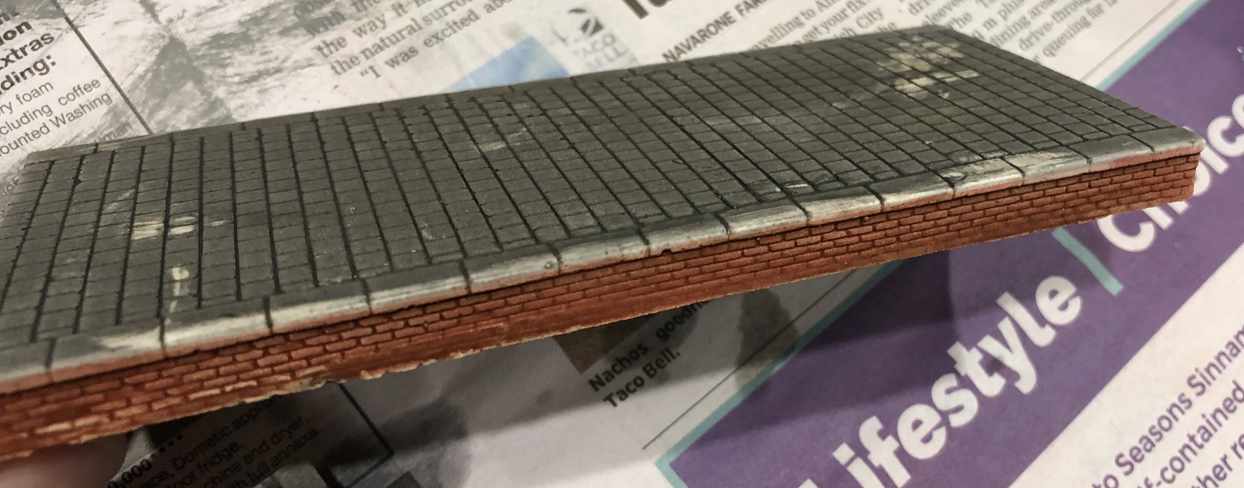

Offline applor
#23 Posted : 03 July 2019 00:08:46(UTC)
applor
Posts: 1,769
A few days ago I washed out all my moulds with warm soapy water that had been used with Lukas flow agent.
I then did a test batch and last night they were cured enough for me to paint. The results:
As you can see cleaning the moulds was successful for the most part. There are some patches and areas that were still sealed but another more thorough clean will fix that.
It is quite striking the areas that would not stain. After the success with staining the platform I then painted the other casts where the moulds had been cleaned and experimented with colours:
Base coat for red brick
So in conclusion I am very pleased that the cause and solution has been found - but it has cost me months of work.
Thankyou all for your assistance in identifying this problem and by chance if someone is using water colour stains then hopefully they will see this and avoid the same trouble I had.
From now on I will avoid the Lukas wetting agent and use only pure alcohol.
