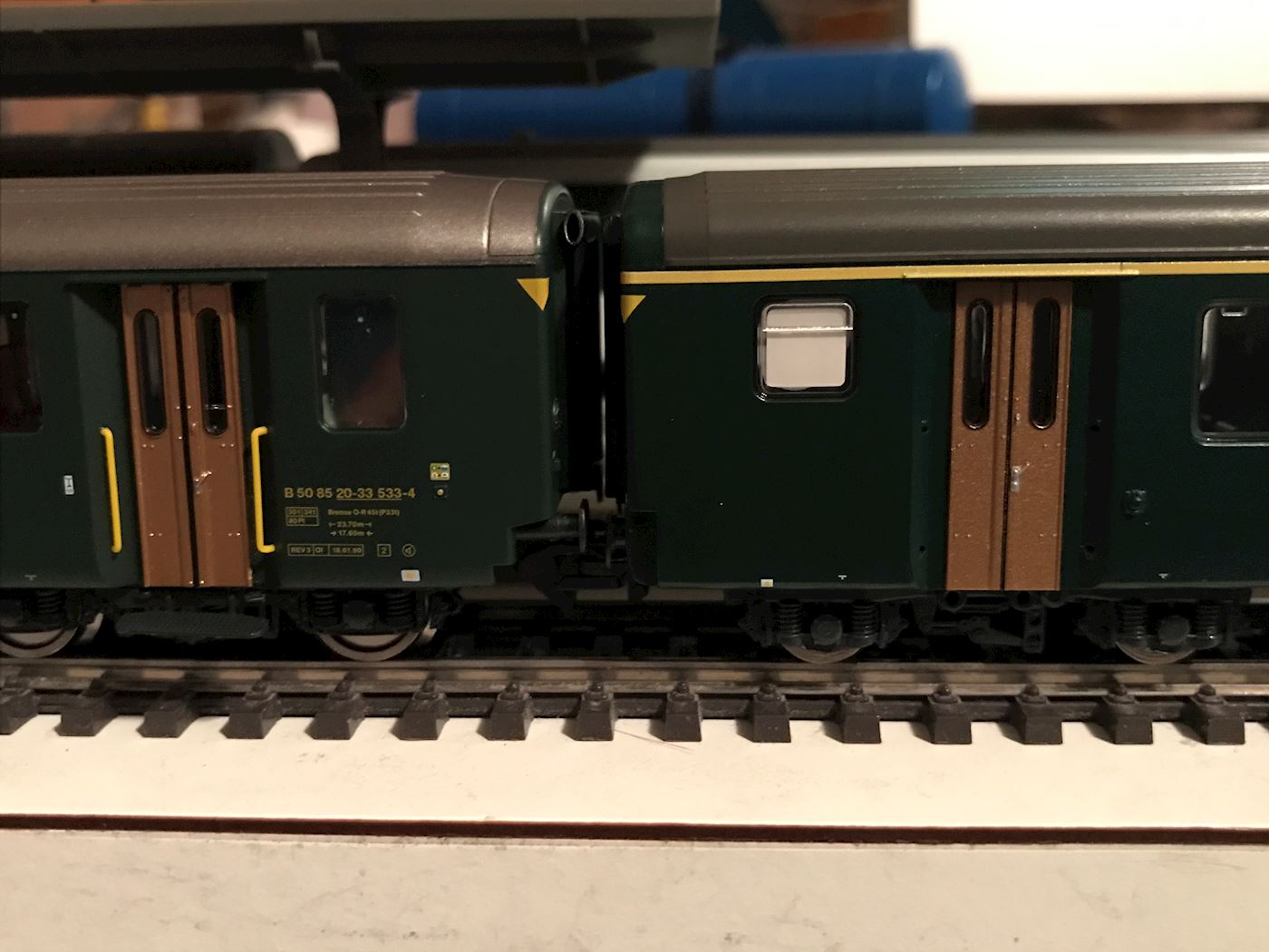

I had the chance to take a few photos of the new Roco (EW II) and Piko (EW I) coaches and one of my Lima EW I coaches from around 1990.
The Hag EW I coaches use the same shells as the Lima coaches but with a metal chassis. The colors are the same as the Lima models.
Piko EW I B (L) - Roco EW II A (R)
Roof Color
Lima EW I B (L) - Piko EW I B (R)
Edited by user 04 December 2019 08:14:36(UTC)  | Reason: Not specified
#4 Posted : 04 December 2019 08:16:08(UTC)
Posts: 8,362
I updated the last post with new photos taken this weekend.
