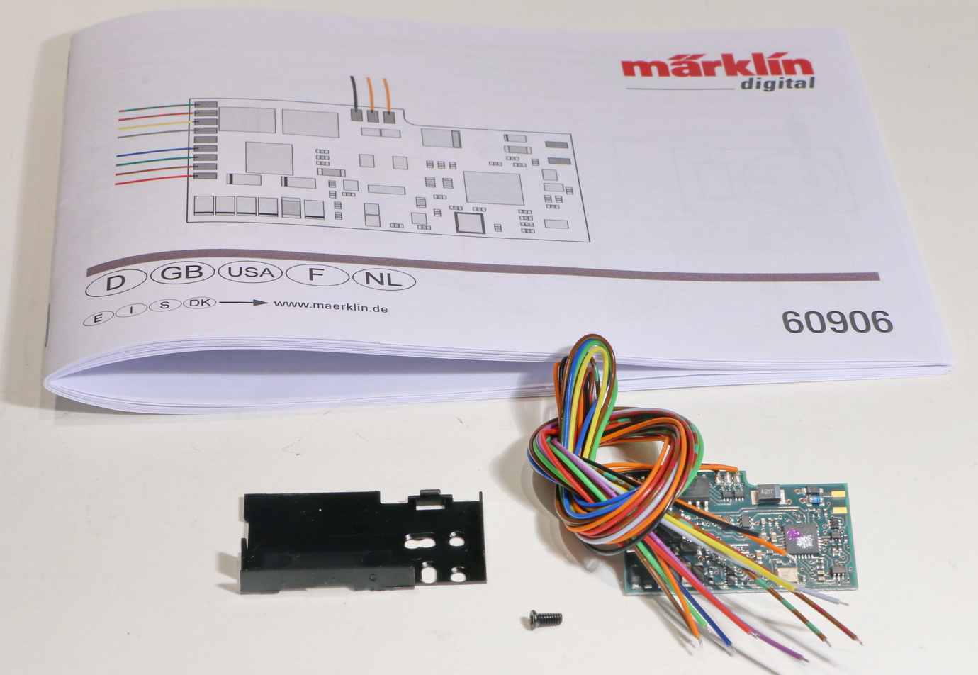

Inside the box there is the decoder the base and a screw:
The decoder itself is quite large with the various cables soldered on the decoder PCB with Märklin color code
Is a 2 side PCB but with components only on the one side.
The manual gives all the informations that you need for the conversion.

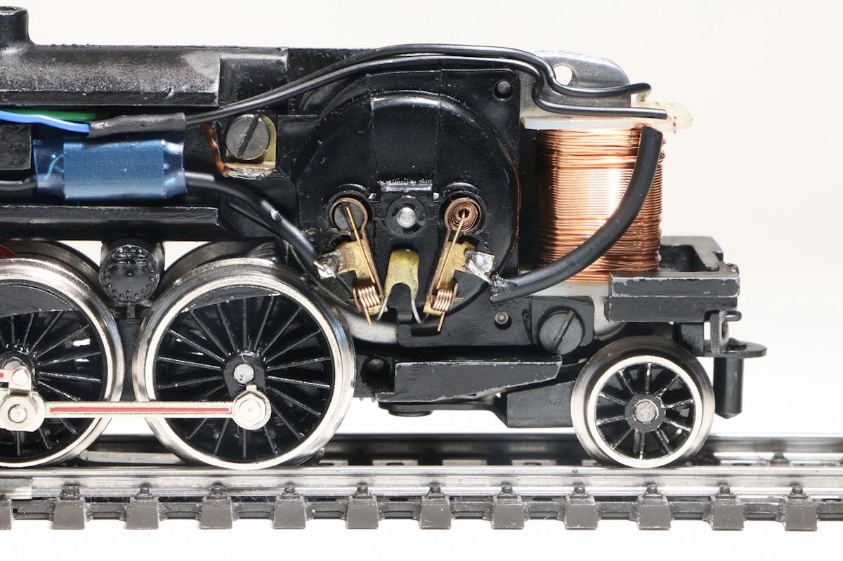

The motor had work very little and after a good cleaning is like new.
Then the motor parts put together, I removed all the capacitors except the one between the two brush plates.

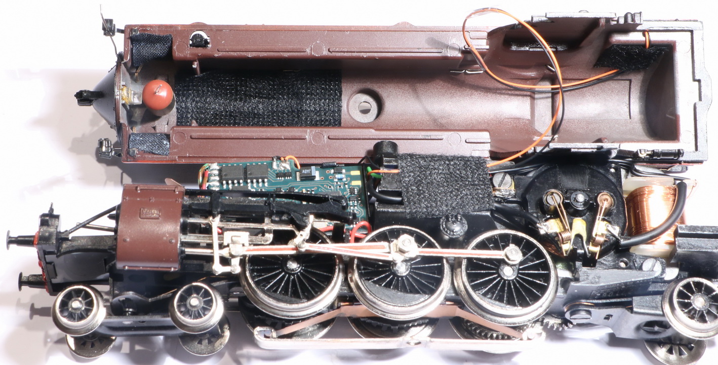

Decoder base in place the space is enough.
I removed all the cables witch I don't need (violet, yellow) and put the decoder on the base and did the soldering work.
The two SMD resistors for the LED's on a small vero glued behind the decoder
The loco after the installation of the decoder

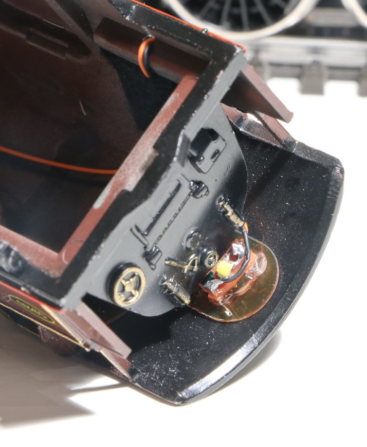

The cabin light is a 805 size WW led on a small vero glued on the roof of the cabin, and the wires pass through a 1,5 mm hole drilled in the side of the cabin and is no vissible at all.

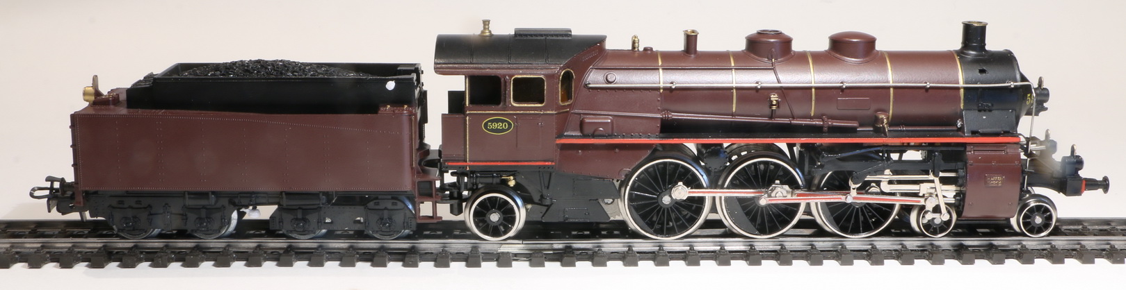

The final look with the cabin light cables soldered, smoke generator No 20 in place
Close the loco and test track....
The CS3 recognized the new mfx decoder
The lights working nice.
