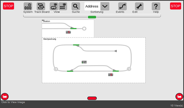

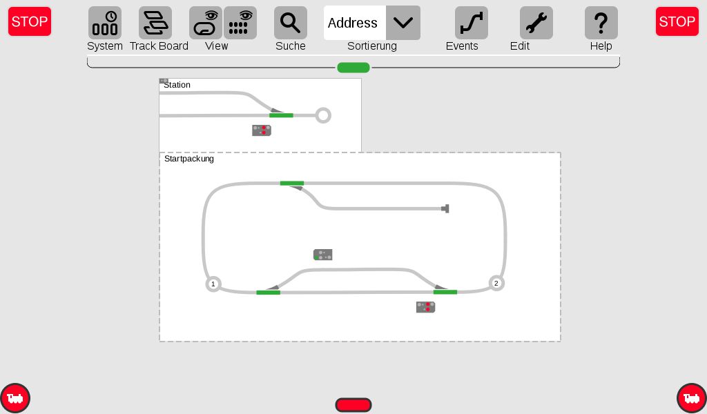

I am including an image of what it is doing.
This is what I got after selecting the entire station area (from turnout to turnout) and copying it.
