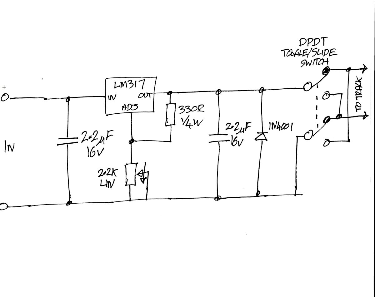

As for the panel mounted PWM controller I mentioned, even with the changes I made (which I am very happy to share if you want to try for yourself) the performance is no better than the Snail controller, though no worse either, in my opinion.

I’m beginning to wonder if we should take this epic conversation off-line, but as no-one has told us off yet, I’m going to reply here. (Besides, there must be someone who really knows about these things on this forum who can tell us how it actually is!)
When I bought the Snail Controllers I was certainly under the impression that they had back-EMF sensing feedback. However, I did some testing this evening and I couldn’t find any indication that the controller was responding to changing load, so I’m inclined to conclude there is no feedback.
I suspect your comment about how a controller would respond to little/no back-EMF feedback at very low speed is spot on. The obvious way around this problem would be to ignore feedback at slow speeds, which doesn’t help at all with the “lumpy” acceleration we’re both trying to avoid!
Your thought about a controller which smoothly switches from PWM to constant voltage as you increase the speed is exactly the “hybrid” scheme I was referring to a couple of posts ago. As I see it, the challenge is to make that transition smooth – something I’m still thinking about. I’m sure the decoder manufacturers know much more about this than I do, and probably have means of getting better and smoother control. I still feel pretty sure, though, that these would work applying power to the track.
In any case, I should be clear that on my layout I use constant voltage controllers so have no experience of the long-term effects of the Snail controller or any other PWM controller, for that matter. However, in case you do want to experiment with the “cheap” PWM controller, here are the modifications I did :

As promised here is the schematic for the controller. Hopefully it's self explanatory enough, but feel free to ask if you're uncertain of anything.
The input is 12V DC for which I use a common plug-top power supply rated at 1A.
The potentiometer I used has a switch I the anti-clockwise position that I connect in series with the output to completely isolate it in the stop position. (Even at the minimum setting it puts out 1.25V, so this is a good idea. If you can't get hold of one of those, you could use a centre-off switch for the direction control.)
The LM317 will need to be on a heatsink of some sort. I used a TV40 type which is readily available and inexpensive. You could just as well just bolt it to the case if you're building it into a metal box. Either way, beware that the heatsink will be live to the output voltage. This isn't a safety hazard but you'll want to make sure it can't short onto anything (such as the track or another controller). Alternatively, you can buy insulating kits to isolate the device from whatever it's bolted to.
Simple speed controller for Z gauge
Apologies for the quality of the drawing, but hopefully you can get the gist!
Chris

Drawing is clear Chris,thanks. Can't say the same for whats going on there though. But no sweat that's what the electronics supplier
is there for :). Will only get to him later next week.

Here are part numbers of suitable parts from RS (rswww.com). I chose RS because they have an international presence, but aside from the LM317 itself all of the other components can easily be substituted. Unfortunately, RS tend to stock things in packs, so one of all these items will be enough for one controller with several bits left over. Unfortunately RS don't have any rotary controls with built in switches, but they are widely available elsewhere.
If you have a preferred local supplier I am happy to look for suitable parts or agree alternatives if that would be helpful.
Anyway here are the RS part numbers :
LM317 : 533-5698
Heatsink : 221-2176
2.2uF : 191-985
1N4001 : 533-5698
330R : 707-7622
2.2k pot : 387-723
Switch : 734-7047
I've not included the 12V power supply, as this will be very specific to wherever in the world you're located nor the mating socket. again I'm happy to confirm any parts you've located are suitable.
Hope this is of help
Chris
