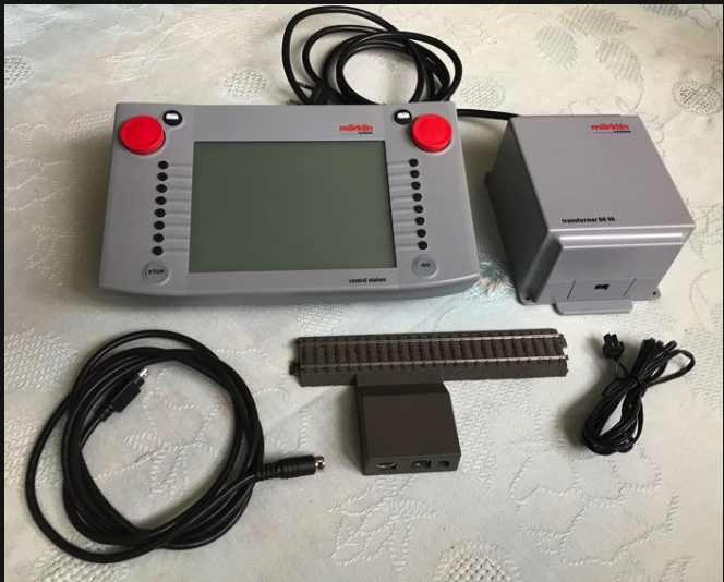

I wouldn't use anything less than a white 32va transformer with the CS1, and it is best to use the 60va 60052 Marklin transformer for best results.
The best that you can use is the 6002/6003 old transformer (52v) can use with CS1. Here is the way the CS1 came originally:

Depending on your expected track/accessory load and purpose you can use (probably should aim for) the 52VA transformer (60055 USA) already picture, however the 60212/CS1 will work the the smaller starter power pack (e.g. 66181 that cam with the Mobile Station sets)
at the time of release, any Marklin 16VAC transformer 600x were common - with the noted current/power limitations.
i.e. either a 16V AC transformer or a 18V DC power pack.
The 60212/CS1 shipped with BOTH
- the 8 pin to 10pin CAN cable (pictured above - bottom left) for use with connector boxes 24088(C-Track), 60115 or 601111
and
- 2 pin plugs (x2 for main and programming outputs) and cables with/without spade connectors (C-Track assumed)
Do not use BOTH at the same time
The 60212/CS1 item did NOT ship with the 24088 track adapter (pictured above bottom middle), although this may have been provided in a C-Track starter set which included a 60212/CS1 .
Power must NOT be provided into the track connector box if used . (only to the 60212/CS1)
Refer Users manual page 16/17(online) or page 25/26(updated hardcopy with s88/booster/sniffer references)
