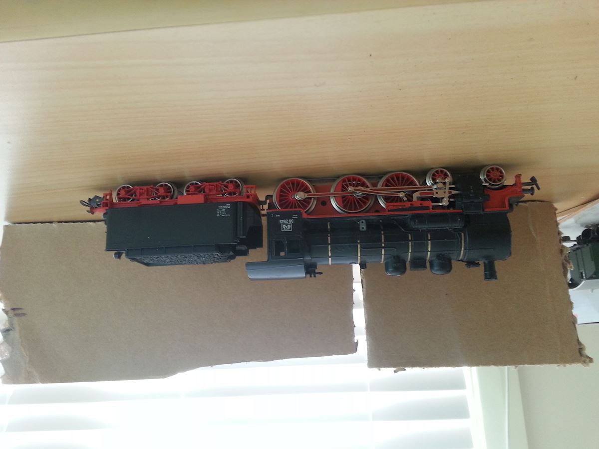

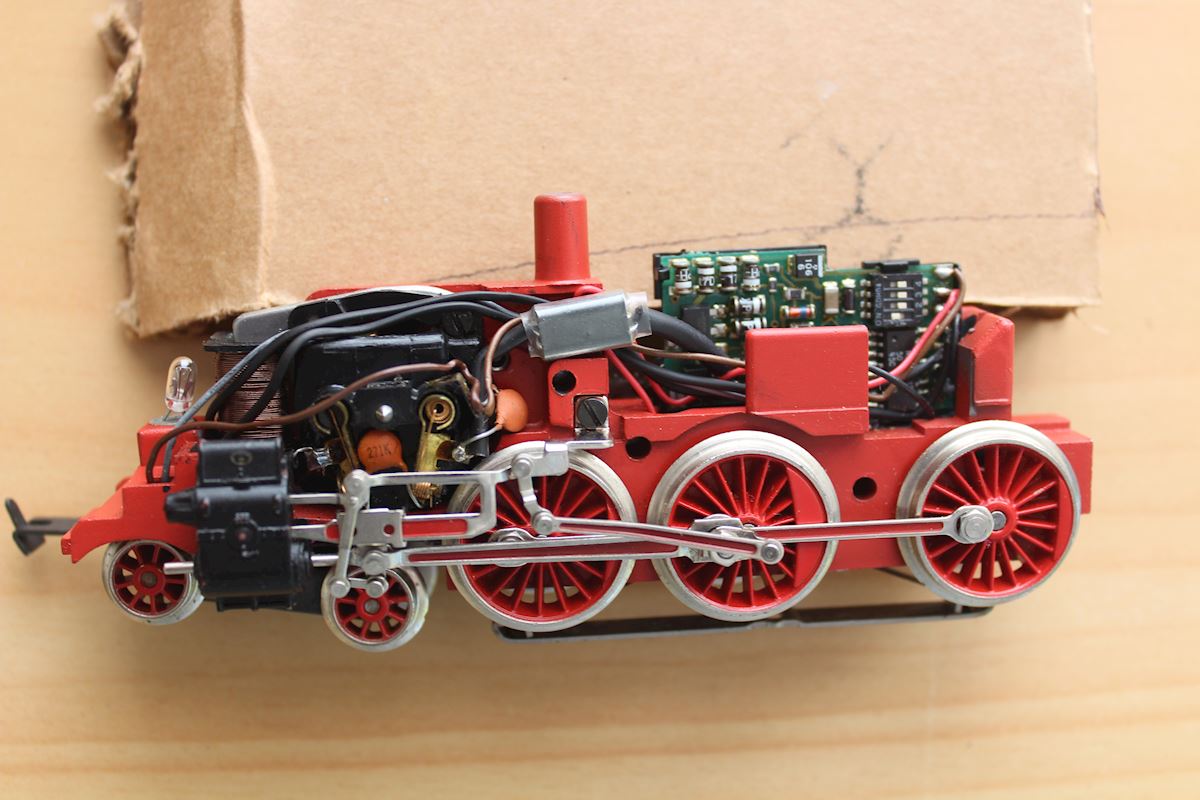

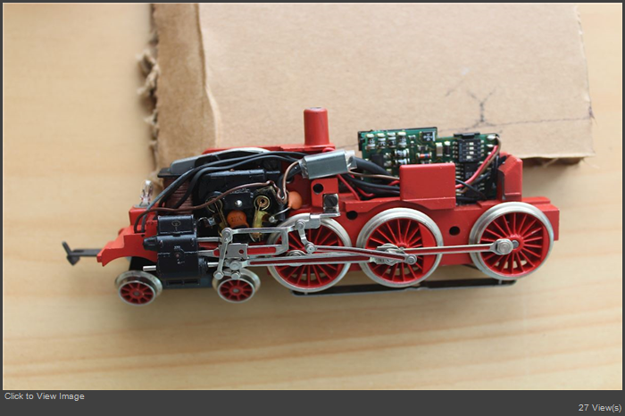

Hi, Before I present my problem I would like to introduce myself. I have a modest and ecelctic collection of marklin locos,track and wagons. I stopped collecting due to financial reasons and the realisation that I wasnt doing anything with them.
I have recently started building a small layout based on a Marklin starter set oval with some sidings. This is to get the kids involved in the hobby. Getting them to paint,plaster and create scenery for the layout.
To add some variety I brought out a delta loco ( 2960, BR38) from storage. I got this second hand from ebay 10 years back and never tested to ran it. I tried to run this loco on my track which has a digital controller . I changed the analog setting on the decoder to run on digital ( it can be seen in the pic). The loco ran herky-kerky for a while.
I had a look online and did some troubleshooting. Cleaned the pickup shoes with Isopropyl alocol. Unscrewed the top and tried to get to the motor, but was unable to open the motor housing completely ( not sure what i was doing wrong).
Now the loco simply refuses to run. No buzz of electricity passing through it when put on the tracks. The lights dont switch on either. Its looks dead for all reasons.
PS: The loco is missing traction tires and hasnt been oiled in a long time. I have got these and plan to apply in next few weeks.
I would really appreciate if someone can shed light on whats happened to the loco.

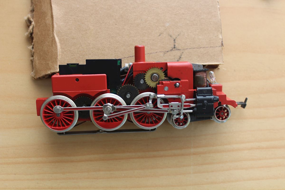

Yogi, somehow you have to find a way to take the motor apart and look inside, most probably its the armature which is stuck due to the lack of running the loco on occasions.
look out for any loose wire as this could also be a reason, the loco looks like new so it shouldn't have major problems with it., what is the object on the second last picture underneath the tension spring on the right ? is this just copper shining through ? another test you could do is take the globe out and test it on the track and see if it works, with a multi meter you could test all the wire connections.
you need to realign the front coupler to a vertical position.

"what is the object on the second last picture underneath the tension spring on the right ? is this just copper shining through ? "
Yes, thats the copper shining through.
