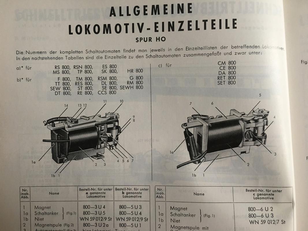

#4 Posted : 04 February 2019 15:44:01(UTC)
Posts: 3,721
Hi Chuck
This type of reverse unit brings a jerk with it because there is no switch-off of the motor during the 24V pulse.
This is specially true when the loco is stopped with lights on. Thats why in those days invertions (overvoltage) was done by a quick push on the button.
Adjustment of the spring is easy: set the loco to maximum speed and trim it so that the reverse unit is not triggered
Below are the two types of Märklin direction relays
The one on the left allows to adjust the spring tension and with the other one you bend the spring one way or the other.
Any Märklin dealer sells those springs for reverse mechanisms

Hi Chuck
Thanks for posting the instructions Jean. The one I have is on the right. Since I now know that a little jerking is to be expected, I think I'll leave it as is. Hope to post a pic of the engine with the background story in a day or so.
