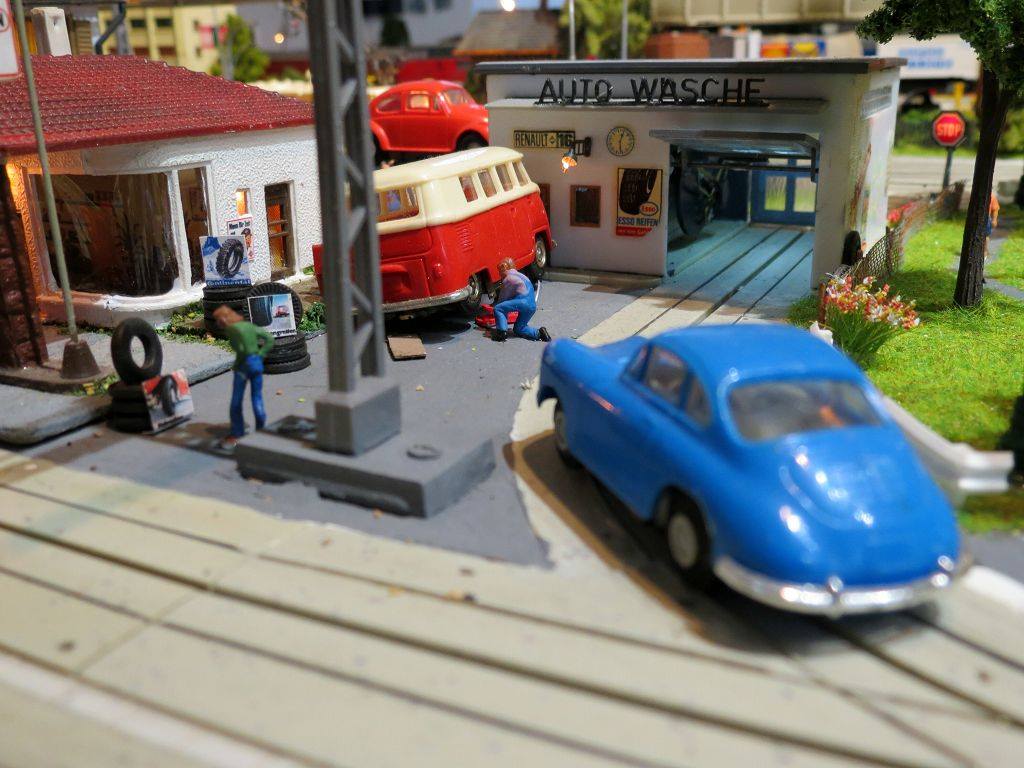

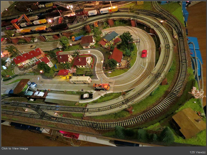

These photos were posted on the Faller AMS Facebook group - they are simply too good to hide away so I have copied them across here, just about everything covered, a truly magnificent and imaginative layout with heaps of play-value.
Note that Michael has already covered the building of this layout previously....
https://www.marklin-users.net/forum/posts/t38423-Extension-of-my-old-layout
... but I wanted to hi-light the Faller AMS aspect of it with this new topic.
Some notable features are the AMS Transporter (drive-on drive-off), the Auto car Wash, Eheim Trolley-Bus, Container terminal, Turnouts and Intersections, Traffic Lights, a single-lane road running between houses (very cool and suburban, a scene not often seen)..... BigGrin - oh, AND Märklin of course LOL LOL ThumpUp

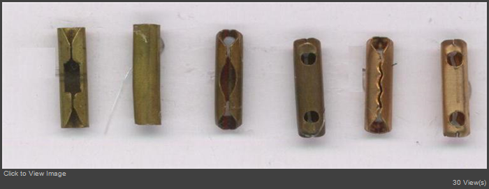

But before the tops of the rails, you also have the connecting pins between the tracks. There are three styles, the earlier ones (left pair in image) work loose more easily but are easily (gently) squeezed tight with pliers. The right end ones have the most grip and you'll soon know this when you try to remove a few with your fingers!! - use a hook or pliers to pull them out without damaging them - there is a Faller tool for it but it breaks quickly.
What's more important and easily overlooked is the surface of the sides of the metal track rails. These too can become tarnished, and you can't really clean them because they are recessed into the holes but all you need to do is insert and withdraw a joiner several times to burnish the connecting surface between the gripping portion of the joiner, and the track rail. And again, if you give the joiner a light spray with CRC first, it will help.
