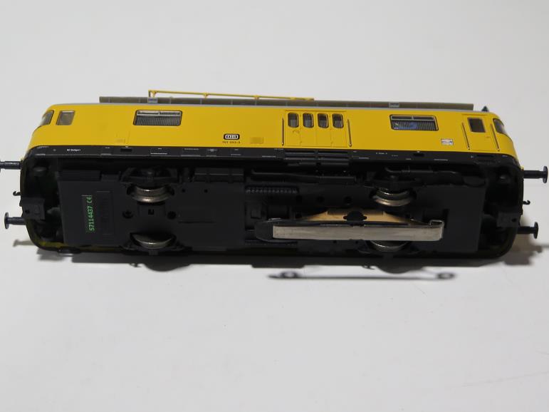

I have this Railcar which I love by the way, but it's a bit lonely and I'd like to pull a couple of small maintenance wagons behind it.
It has a coupling pocket but it sits a lot lower than others so if I put a coupling in of course it won't hook up.
I see the variation 39971 that comes with a cable-wagon and it shows a connecting bar to hook it up. What I really want however is a clip in Relex coupler designed for the low-riding coupling pocket to raise the height to normal.
Has anyone done this? The exploded view for both locos shows only the coupling pocket, but not any connector.
Is it a standard part that can be purchased or would I have to go the angled bar path for the other model? See images below which should make it clear.
Thanks in advance

Posts: 3,648
Hi Cookee
I have also this railcar which I love.
Of course if you can order those parts it is great.
What I did on mine is to take a Märklin close coupling and remove the buckle and its S shaped pre-decoupling device
Then I bent the coupling head upward by approx 20°
On the wagon to hook I bent downwards the coupling head by 20° and also made sure the buckle would go down enough to catch the "up-facing" coupler and checking that the part to raise the buckle is not too low and catching on "Puckos"
The result is this
So it looks like a little "bricolage" but is costs nothing, can be decoupled and is very discreet
