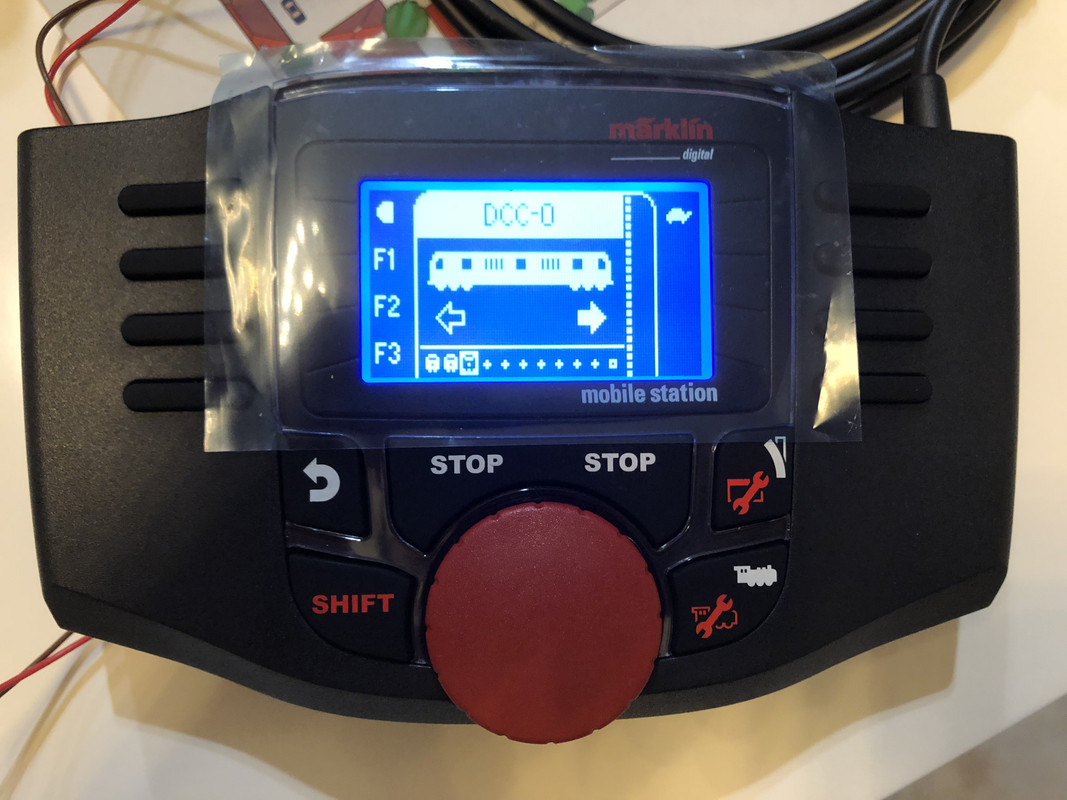

Hello
So I finally bit the bullet and bought an HO set (29000) which includes the Mobile Station (60657), track connector box (60116) and enough pieces of track to make an oval track. Marklin trains with MFX decoder work fine, they are recognized right away and most functions seem to be there(This would be another question)
My problem starts when I try to program a BRAWA locomotive (43901) This one has no sound but DCC decoder. When i tried to program automatically it seemed like it did, but it had no functions nor control. I went ahead and modified some parameters: Change loco, Address and changed the domain to 3(According to the instruction manual) And I gained some of the light functions but no forward nor reverse movement. I went ahead and changed the domain to 4, and I gained movement control but no functions, changed it back to 3 and finally got movement and light control. My question now is this:
1. I know this locomotive has a lot of light functions, but the mobile station only shows 4, how can unlock all the other ones? Posting a picture of this
2. What is the turtle symbol for? (All other marklin locomotives have it, the manual shows it as ABV off, but when I press it nothing happens)
3. Some of the functions require you to press multiple buttons, do you press them at once? or one by one? ( I tried both an nothing seems to happen)
Thank you very much for your help!

I see 2 questions not answered [ or not in full ]
You can get f0 through to f7 from the 8 buttons. You can get f8 to f15, I think, by pressing the shift button before pressing one of the 8 buttons
The tortoise sign does mean slow for shunting, but what it also means is that it disables the acceleration/braking delay functions so what ever you set the dial knob to is what you get. Ie it can go from flat out to a dead stop by spinning the knob back./

Coming back to the original question. Something that might not be clear yet is that the symbols and functions that MS2 created by default for your loco is not what the loco is capable of, it's just some defaults that might or might not match your configuration. Check your loco's own manual to see which functions should be supported then configure your MS2 entry to reflect them. Something like the table below.
If you don't have the manual any more, just enable all 16 in MS2 (set a symbol for each) and see what they do. With that information you can then assign icons or temporary/permanent flags, disable the ones that are not doing anything and so on. Well, that's a bit more tricky, some functions could alter the behavior in non-obvious ways (like disabling braking sounds, ABD, shunting...).

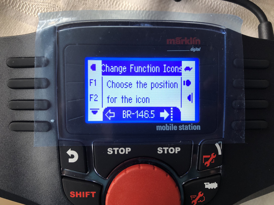

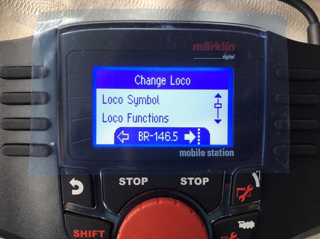

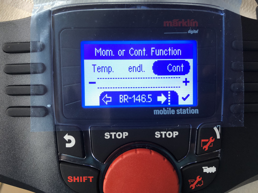

Hello everyone!
I finally figured it out and i will show you the steps:
1. I looked in the manuals and it shows the functions it has, in this case from F0 to F6 since it does not have sound
2. Press SHIFT + TRAIN and select CHANGE LOCO
3. Press LOCO FUNCTIONS
4.Select CHANGE LOCO FUNCTIONS
5.Select an F function (In my case I selected F5 which was blank) and select an icon
6. Select the duration you would like the function to last
And that is it!
It was definitely not as bad as I thought it would be, its more time consuming and repetitive, when I first put the locomotive on the rail I had it detect it automatically, which it did, but only showed functions F0(as a symbol of lights), F1, F2, F3, F4(as a symbol of a turtle), so I had to program F5 and F6, then I changed the other icons, I am not sure if they are right or not, I have to double check
Thank you once again for your kind responses! Little by little I am learning more and more!
