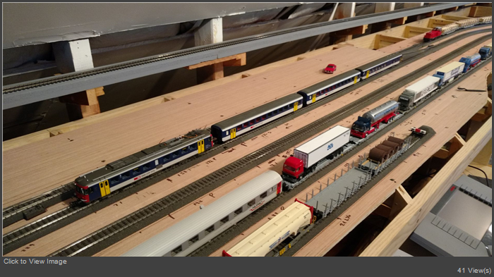

Here is a picture of my RBe 540 and trailer with two HAG cars.
The railcar loaded on my CS2 automatically with all functions. I entered the trailer using DCC address 4 and all functions work as well. The set runs smoothly and sounds are good. Frame on the railcar is very heavy providing good traction and rail contact. Motor must be very compact as its location is not visible from the exterior.
Christian at Eyrotech emailed me that the two car add on set will be be coming out in May. There is no AC version so the lighting question remains. He did say that AC wheel sets will b e available.
I am pleased with it.
