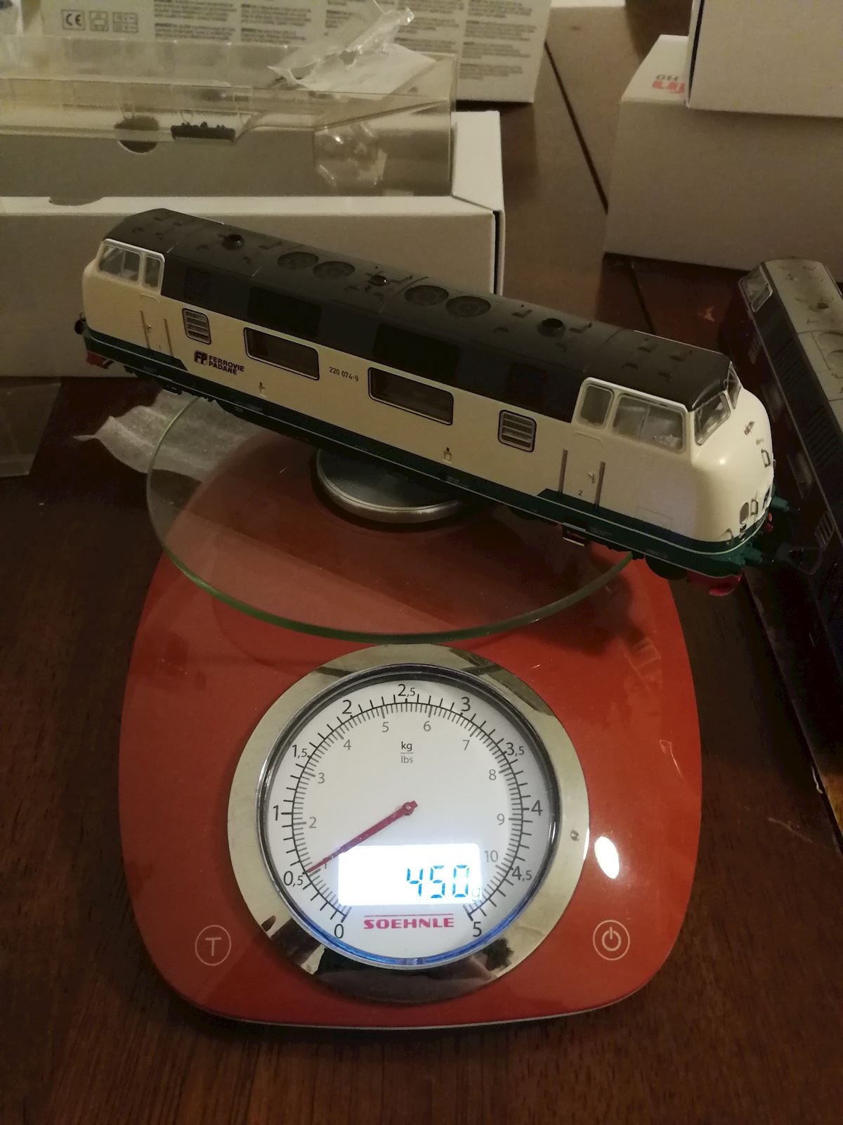

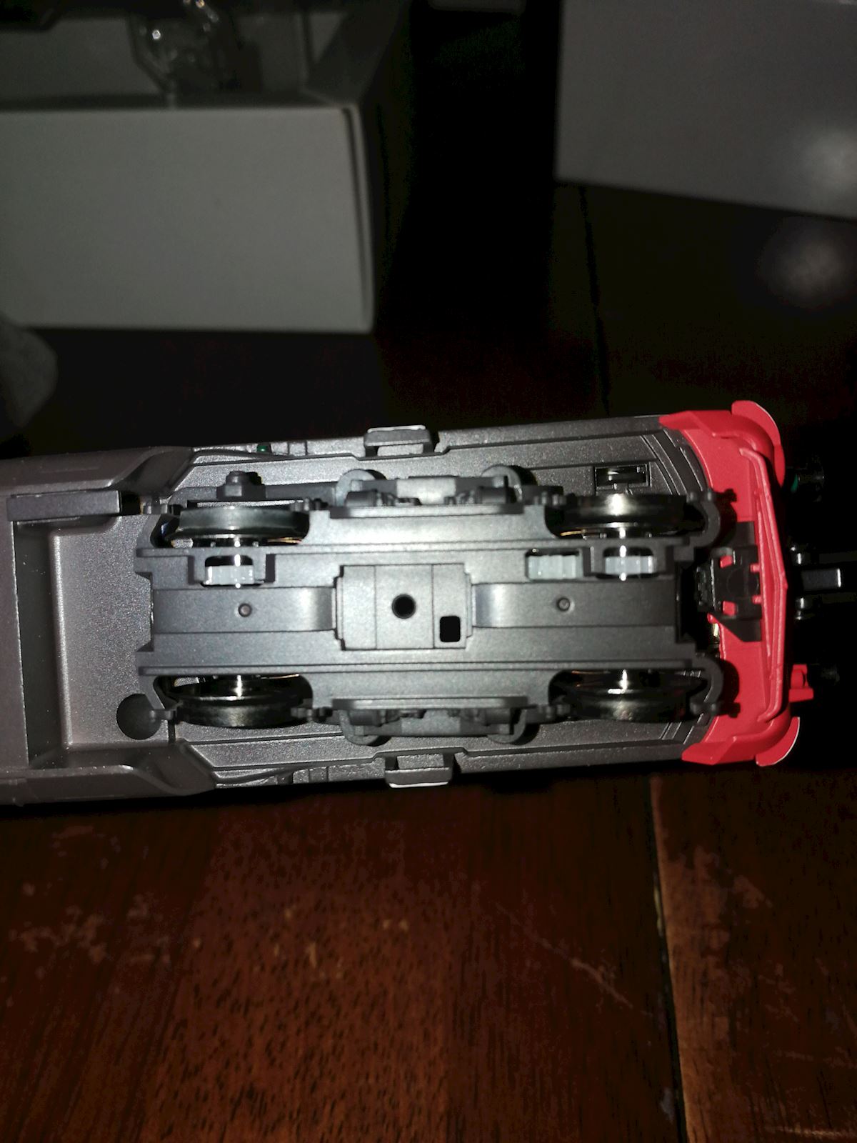

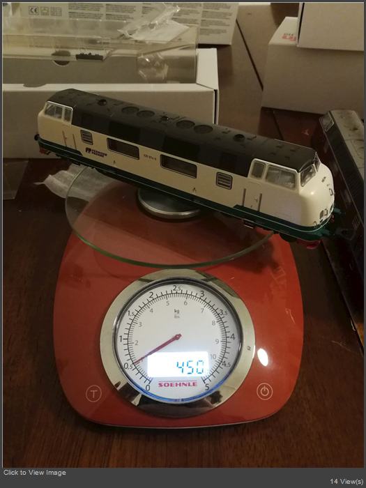

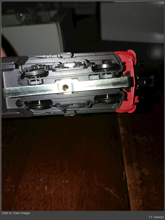

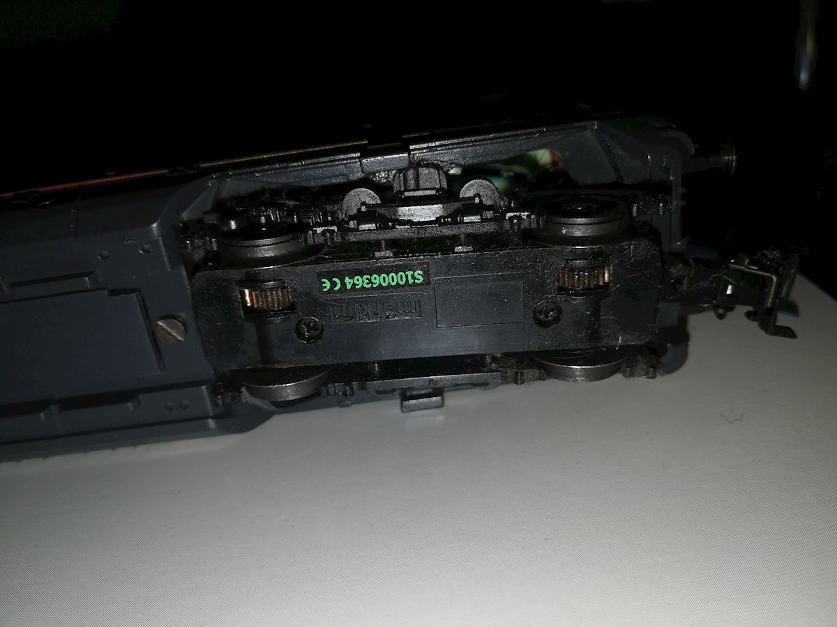

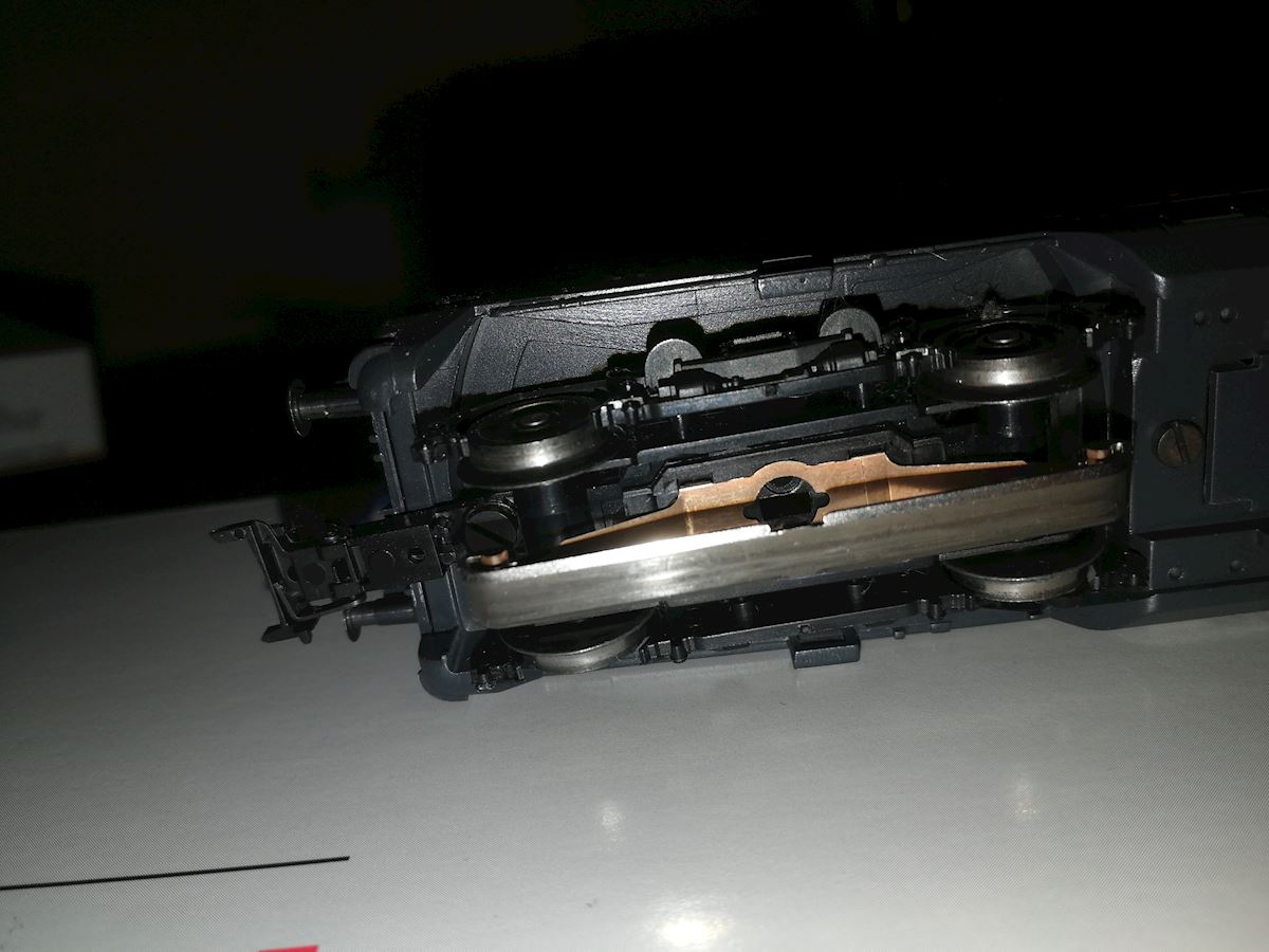

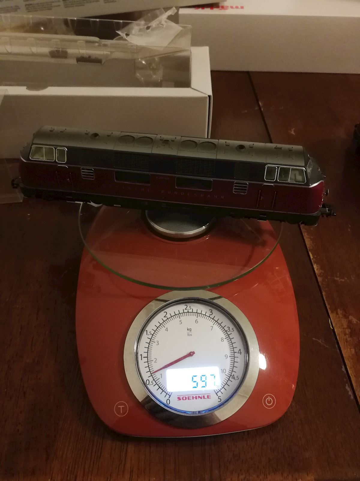

I made test and pictures, apparently Marklin for unknown reasons decided to save money on rubber tire, this makes the loco run in a terrible way.
Here's a comparison between the Marklin 39804 and 37806...
Marklin 39804 is lighter and has FOUR rubber tyres.
Marklin 37806 is heavier and it has only TWO rubber tyres.
Piko 59717 I also took the occasion to test the V200 Piko and, even if it has just two tires like the 37806 Marklin, this one is much higher and works quite smoothly.
Front:
Video:
This is the first time I get disappointed by a Marklin locomotive, and I think is quite surprising the problem arise on a V200, hopefully they'll understand that saving a few cents on tyres is never a good idea...

When the wheels with tyres are in the front truck ?
On the photos it looks as if each truck has one traction tyre.
If you have a preferred direction of operation, you can make sure that the axles with traction tyres are the rear axles in each truck.
Theoretically you get more tractive effort in the preferred direction, but less in the opposite direction.
Having slider and traction tyres at one truck could reduce the effectiveness of the tyres. Reducing the spring tension of the slider might improve the tractive effort.
