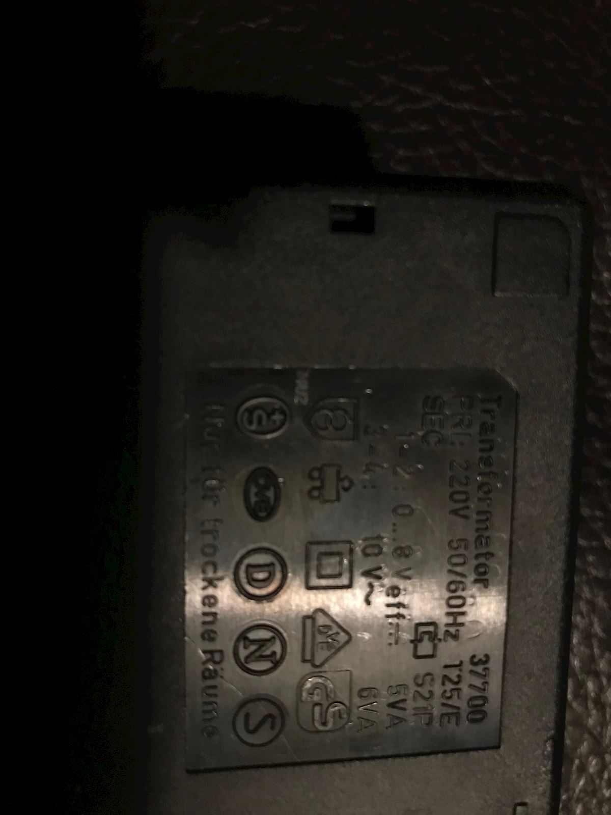

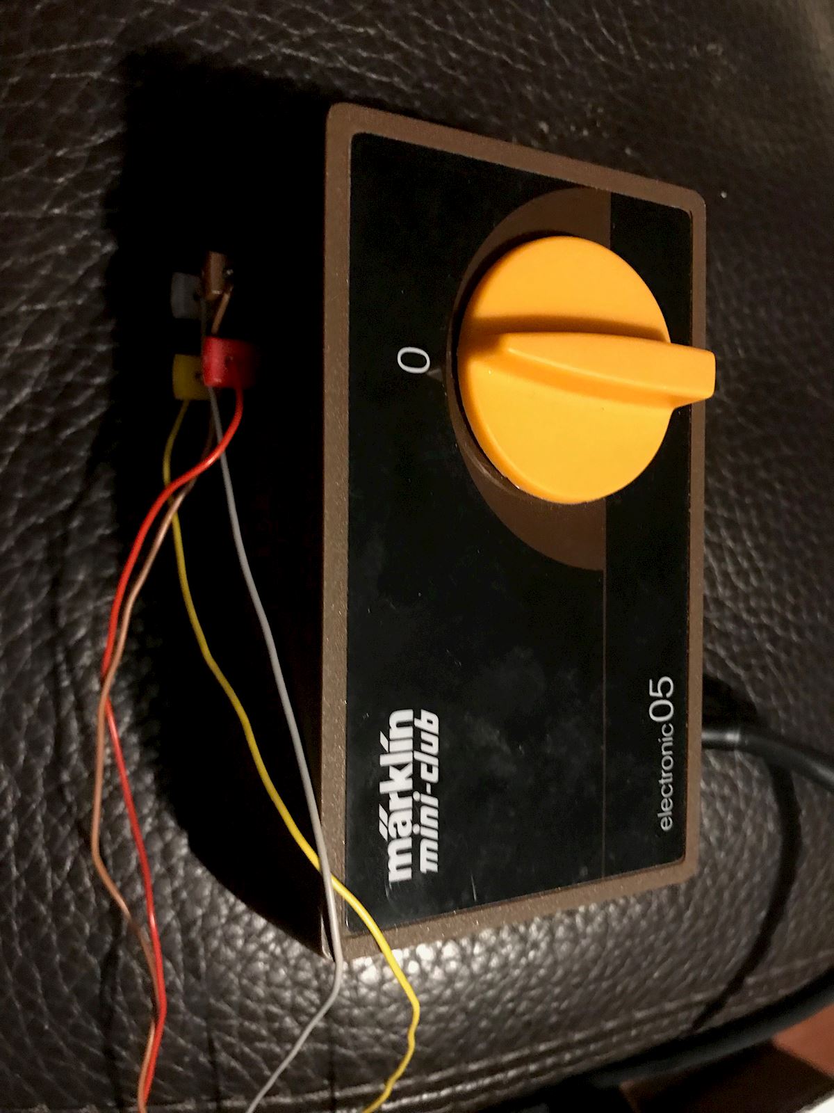

I have attached photos of the power block I currently have which says 10v on it?
This is not going to be used by children... OMDB... so battery option connected to a controller sounds good. Can you recommend a controller?

Märklin 67013:
https://www.maerklin.de/..._torrpdb_pi1%5Blang%5D=2
The power supply that comes with it has 12 V and 12 VA.
Similar devices with a green speed knob are available from Trix. You can get them from starter sets for much better prices. I don't know if there are differences internally.
For Trix H0 the thing uses a power supply with 18 V.
I assume there are differences inside and then you'd be on the safe side with the #67013.
The Trix device is specified for up to 24 V DC input voltage.
Maybe an owner of the 67013 can check the specifications on the bottom of the device. Maybe it'll work with batteries for 14.4 V which would give a larger selection.
Otherwise buy the 67013 first, then check the specifications before deciding which battery you will use.
