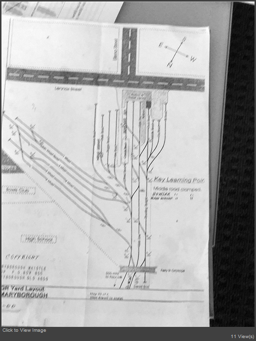

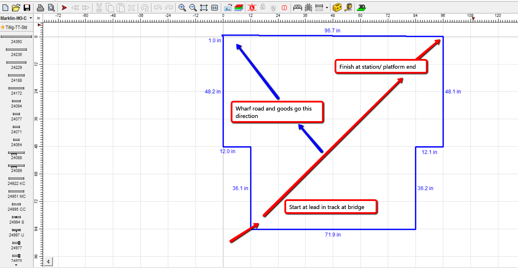

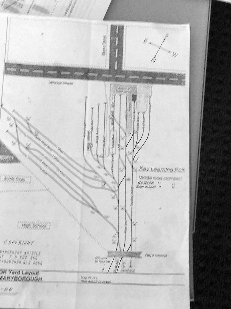

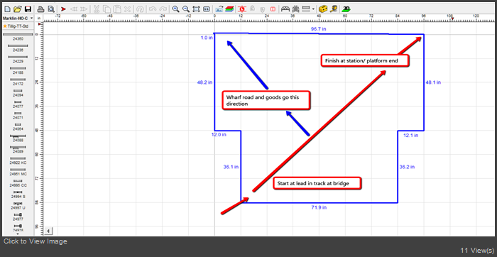

I'm slowly getting my feet wet with SCARM watching the tutorials etc I have my base board done and have a track plan but I need to lay the track on a 45 degree angle across the corner end to end to get the maximum length available can't see how I can do this
I include the SCARM base board file and 2 views of the track plan and of the baseboard I'll be using C track
The start point will be on the smaller board left corner (Ferry Street over bridge on plan) and completing at the bigger board right corner (Station/Platform end on plan) is this doable?

When you click your left mouse button to place your start point, just hold the button and when you move your mouse, the angle follows it. If you move your mouse far away from the point, it gets more precise.
In the bottom left corner it tells you what the angle is. When it says 45.0, let go of the button.
