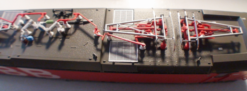

the 4 pantographs are again flimsy and there is no power contact (which seems to be the norm lately with other manufacturers as well.

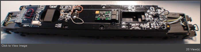

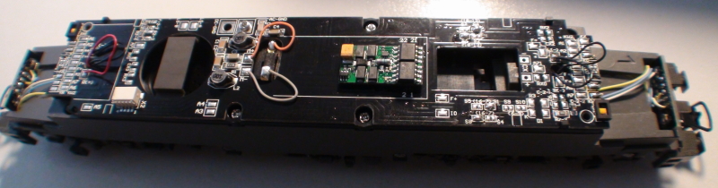

worked on the small light circuit board for t6 hours and I still can't get the high beam going,, if I put 12 Volt straight onto the led it works, I than used the multi meter to see which contact is which, found it and than connected a resistor to one of the contacts but the moment I do this the led is not working, the polarity is right, so another frustrating afternoon.
received spare parts for my BlS Vectron (Roco) = light reflectors for the interior lights and fixed them and they work fine. so everything works with the Roco loco, high beam, interior lights, marker lights and headlights.
#3 Posted : 03 October 2018 14:39:06(UTC)
Posts: 14,875
Hi, finally got the high beam going, traced the contacts on the small circuit board, yesterday I had it totally wrong connected + the polarity., it has got a basic decoder in the loco so know I have to order a Plus22 sound decoder. the Roco BLS Vectron works fine with its sound, interior lights, hoigh beam and marker lights. the pantographs ain't to bad and I've got 4 rubber tyres on 2 axles.

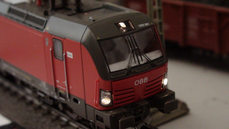

#10 Posted : 02 December 2018 03:14:15(UTC)
Posts: 14,875

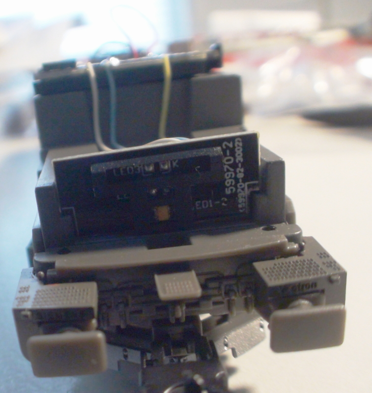

Hi, the loco has now an ESU sound decoder and I've added led's to be able to activate the high beam. thinking of adding cab lights as well down the track, also a Roco model of the same model is on order.
