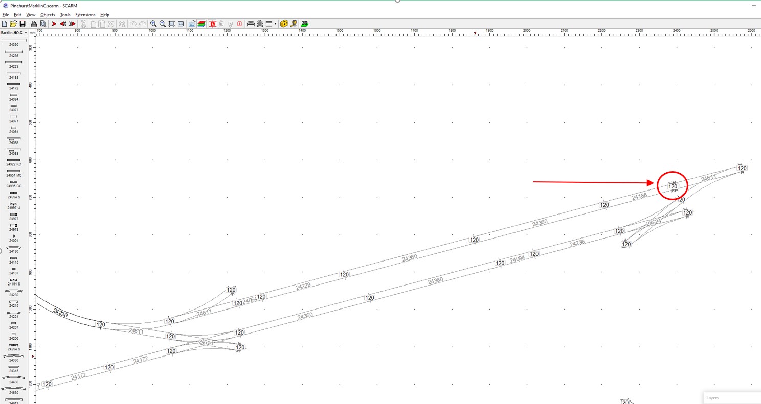

I'm new to using SCARM and am stuck. I am trying to create this layout in SCARM 1.4, it is from Marklin Magazine 03/2018:
http://streaming.maerklin.de/public-media/MM/03-2018/Downloaddatei_Gleisplaene_MM_03-2018_051618_NEU_cz.pdf
I'm working on page 2, creating the station area. I can't seem to get two of tracks to connect in SCARM. It seem like there is a small space between them, hopefully you can see it in this picture:
Is there a way in SCARM to force these to connect? I verified that the height of all track pieces is the same, 120. The magazine article said the layout was created in Wintrack, not sure why it would work in Wintrack but not SCARM.
Thanks!

In the top menu, there is an option where you may extend the tolerance for fitting track pieces. As I don’t have Scarm available right now, I can’t explain exactly where...

I found the setting, it's "Tools - Settings - Edit - Tolerances". I changed the "distance" from 2mm to 4mm, that seemed to work.
Thank you
