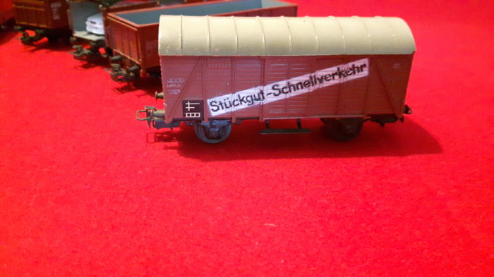

An elegant solution for you to solve needlessly complicated wiring: the Germans ran a set of box cars labeled "Stückgut-Schnellverkehr" to handle express packages between baggage and passenger cars, modeled by Märklin in versions of the #4504 box car, which accepts pick-up ski #7076. 38804488_303260476910136_8763260170483531776_n.jpg#4504.jpg
I never heard (and I don't recall seeing prototype pictures) of "Stückgut-Schnellverkehr" in PmG trains in regular service.
AFAIK those "Stückgut-Schnellverkehr" units were used in dedicated trains to increase the speed.
I do not see any LEIG cars on the picture. There are brown box cars in the train, but without the "Stückgut-Schnellverkehr" markings.
The picture shows the passenger train P 2342 on July 1st, 1961.
Since it is a passenger train (P, not PmG), the box cars will run from end to end without shunting during the train run. Most likely there wasn't any loading/unloading during the train run either.
There were special box cars for use in passenger trains (e.g. for mail) that had pipes for train heating and extra brake hoses.
Standard box cars between loco and passenger coaches would prevent train heating in the coaches and would impose speed limits on the train.
