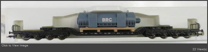

I've got a Fleischmann 5297 heavy load freight car, which has 8 axels, 4 at each end, which I want to run in freight trains on my layout.
For S88 detection to work, I'm thinking of replacing the DC wheelsets it has on it now, with AC wheelsets. But thats 8 wheelsets.
So one option, rather than spending $30+ to get 8 wheelsets, is to instead only replace some of the DC wheelsets, such as 2 of the axels (one at each end) or 4 of them (on at each end of the cars groups):

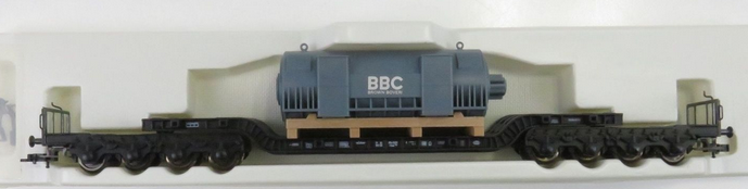

While that model isn't listed, Fleischmann does return an newer car:529701
This is the same 8 axle car (but with NEM coupler pockets, my older one has no NEM coupler pockets, different transformer load), and lists as the appropriate part:
AC Wheel set Article number 6560
which would be 24mm. So 8 axel cars may use the same axels as the 2 and 3 axel cars ..

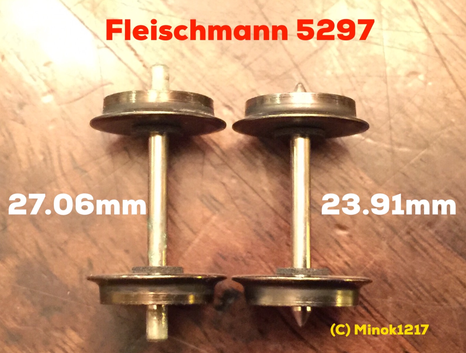

Well this just got a lot more interesting.
First there was the need to disassemble the wheel bogies from the car and bend some metal tabs to get the wheel sets out. Needless to say I'm only reinstalling once I have the wheels in hand to limit bending those small two tabs.
Then there turn out to be two different sizes of axels and styles on the car. Each end has 4 axels. The outer two on each end (the ones I'd planned to replace with AC wheelseta, have the sharp pint on them and ride inside a tight well the way one expects. Those are 23.91 mm in axel length. So 24mm. The inner two axels are looser without the ends being as captive my the wagon frame and longer and have a flat end to the axels. They are 27.06mm long. So 27mm.
So I need four 24 mm wheelsets to do the job.
Replacing all eight wheelsets would not be possible I think.
Three-axle cars from Märklin and Liliput have a different middle axle: no needle bearing, a lot play left and right and up and down.
Same for the four-axle trucks of this car. Full weight on the outer axles, the inner axles are just decoration.
This makes going for the ADDA setup easier.
