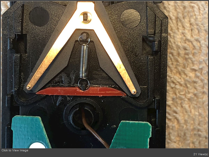

When my Rheingold coach set passes through smaller radius curves the internal pivot mechanism for the CC couplers often moves beyond their normal position and gets stuck to the side. This does not cause a problem until the next curve in the opposite direction and then the trucks are pulled off of the track. They have had this issue since I bought them last year but so far I have just constrained where I run them on my layout. Ultimately I would like to get this handsome coach set working properly and I was wondering if anyone else has dealt with this issue.
This is approximately the furthest deflection angle caused by traversing larger radius curves:
But on smaller radius curves the ends move out of their normal path and stick in the slot where the coach body attaches. They will not return from this position, which causes the derailments:
I have a few ideas about fixing this problem but I would love to hear if anyone else has experienced this and what their remedy was.
Thanks!

Offline Crazy Harry
#4 Posted : 12 March 2018 02:21:01(UTC)
Crazy Harry
Joined: 18/11/2008(UTC)
Posts: 507
Location: Oakville, Ontario
Jim,
I don't have any experience with current carrying couplers, but looking at your photo I think the issue is binding/catching of the wings of the contact piece. See the red circles in the attached photo:
What keeps the spring from pulling this contact piece too far back? Would it help to file off the ends of the wings (green line) a bit to avoid binding/catching of these components with the slot or ridge in the body?
Harold.
Offline dickinsonj
#5 Posted : 12 March 2018 02:53:34(UTC)
Joined: 05/12/2008(UTC)
Posts: 1,883
Location: Crozet, Virginia
Harold.
Thanks for the ideas Harold.
Filing those areas would probably help if that piece was fixed in some way, but it is free floating in that space. The only thing that controls its movement is the spring. It is hard to see in the second image, but if you look at the first image notice the lower wing and how it is normally contained within that raised guide. When that piece goes to the inside of that guide it lets the other wing slip into the slot.
I think the problem might be that there is not enough spring tension and the part moves beyond where it is intended to operate. I might try adding some kind of curb to stop the wing from getting outside of that curved guide. My other option is to try more spring tension, but that might make the whole situation worse. My other CC equipped coaches are very different in design, since the PCB they contact is at the top of the coach. In these coaches the PCB sits on the floor to illuminate the table lamps and the brass contacts rub against areas on the bottom of the PCB.
Offline Crazy Harry
#6 Posted : 12 March 2018 05:17:14(UTC)
Crazy Harry
Posts: 507
Jim,
I agree with your line of thinking - preventing the wing from moving too far should help. I would try a shorter spring (more tension) as a test to see if it helps without creating other issues. At least this modification is easily reversible!
Harold.

OK - I have some progress to report. Cool
My solution of blocking the inside guide so that the tips of the wings can't escape does prevent the other tip from slipping into the pocket for the pin on the body. My first attempt was a bit crude and I managed to break off the small nib that the spring attaches to. Blushing Luckily I realized that I could place the spring on the plastic strip I was adding and that seems to work fine. Necessity is indeed the mother of invention. BigGrin
Here is an image of the first attempt:
But I improved with practice and the second one not only fits better but has a slot to allow it clear the spring attachment:
The coupler pockets will now pivot all the way to either side without getting stuck, so my problem is solved. Some additional good news is that most of the other coaches in this set don't have this problem, although I can't detect why. For now I will run it as is and if this problem occurs on other coaches I will fix them as needed.
I have given up on the idea that all of my new Märklin products will arrive without any issues and I am just happy if I can fix them myself with a reasonable amount of effort. I am glad that Märklin has survived and I remain hopeful that they will solve their quality control problems as they make some money and time goes by.

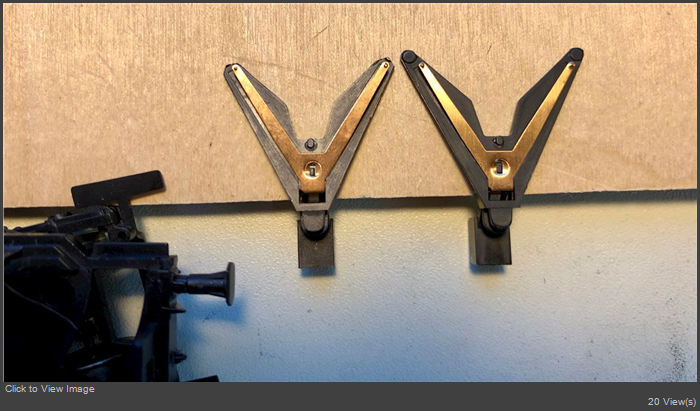

#12 Posted : 12 March 2018 22:16:56(UTC)
Posts: 31,769
I have the 41928 five car set Rheingold from 2008 item.
Photo and video of 41928 coupling, Find no issue. Note the extra long 'V'.
#13 Posted : 12 March 2018 22:22:20(UTC)
Posts: 31,769
Maybe the factory error put wrong Short 'V' on 41929, The short 'V' is for other coaches or freights.
I post pictures above showing correct long 'V' for 41928 and it should be 41929.
Offline dickinsonj

#17 Posted : 23 March 2018 16:31:40(UTC)

Good observation! I have never seen that longer 'V' that you posted from your 41928 set and it definitely is not the same as what is in my 41929.
I just came home with the new 26928 set, and I can report that it also has the longer 'V' (and not getting stuck anywhere in its movement). It is starting to look like a mistake in the production of 41929.
thanks 1 user liked this useful post by Mikael

That confirms that my set has the wrong parts, which I suspected of being true, but I have not had the time to follow up with that. Do you have a part number for that coupler pocket?
The 26928 manual says the part numbers are:
E214980 for the long 'V' plastic parts.
E239830 for the current conducting metal inserts.
And these match the spare part numbers for 41929, according to Märklin spare part database.

I wanted to update this thread and report success thanks to Mikael and his help in finding the correct part numbers. ThumpUp
It took over 6 months for a US dealer to get these for me - the magic of Walthers I guess. I just had the time to install them last week and the derailments are now over!
It does indeed appear that they used the wrong coupler pockets when they were assembled at the factory in Hungary. The new parts also extend the coupler pocket just enough to make coupling and uncoupling easy, where I had to really bang them together to get them to couple before.
Here is a picture of the two parts, with the new one on the right and it is obviously different in both size and shape:
Even more disturbing to me is that these parts in the coaches were not even all the same, with a number of them appearing to have been ground down to fit. I guess they just used whatever parts that they had on hand and then modified them if they were too long. ThumbDown
This set also came without the contact springs in some of the couple pockets but since they put them in the ends of the baggage coaches, where they serve no purpose, I could move them around and get the electrical parts working. I also discovered that two of the six coaches do not have the metal inserts under the PCBs to improve the running and I doubt that there is any way to find them. In one coach with the metal insert there was a small lake of oil over and under the plate, which had spread to the PCB where it could damage the circuits. All in all this has been my most problematic coach set ever, although they finally do run well and while I had them open I also added lighting.
I am a strong believer in all's well that ends well however and I certainly hope that QC at Györ has improved since this set was produced because this is a beautiful rake of coaches, even if they were poorly made.
