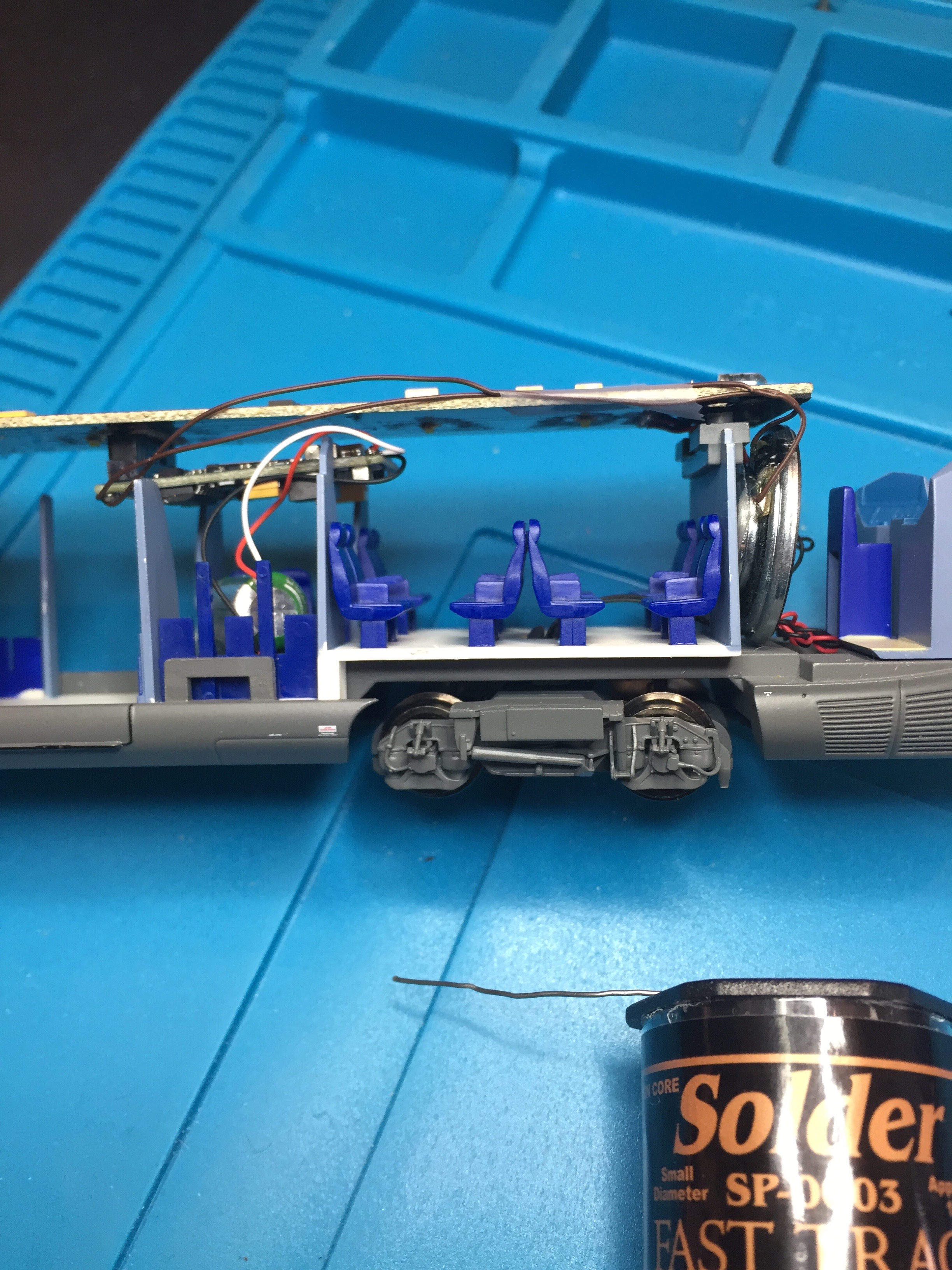

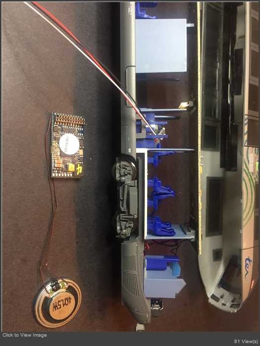

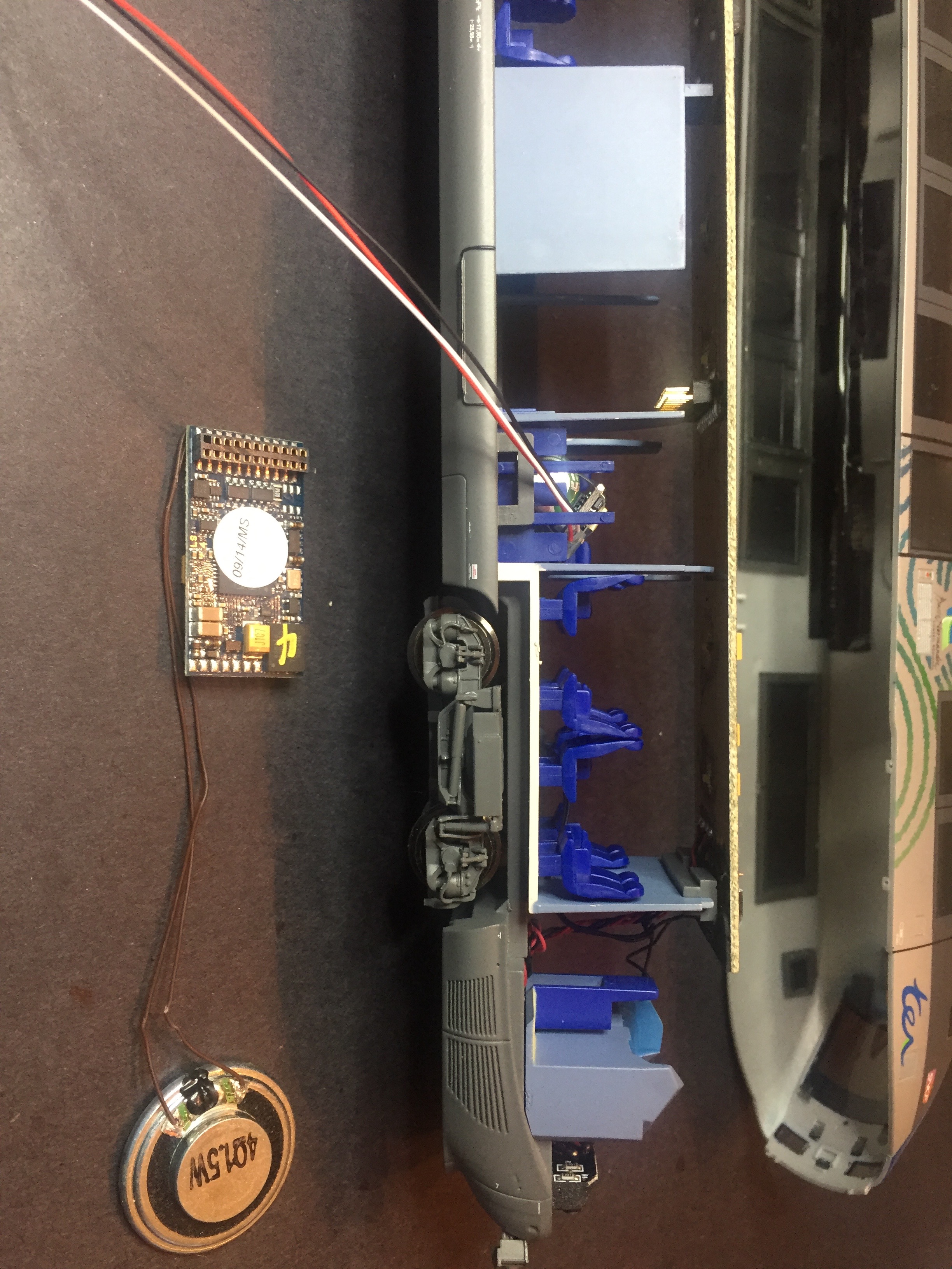

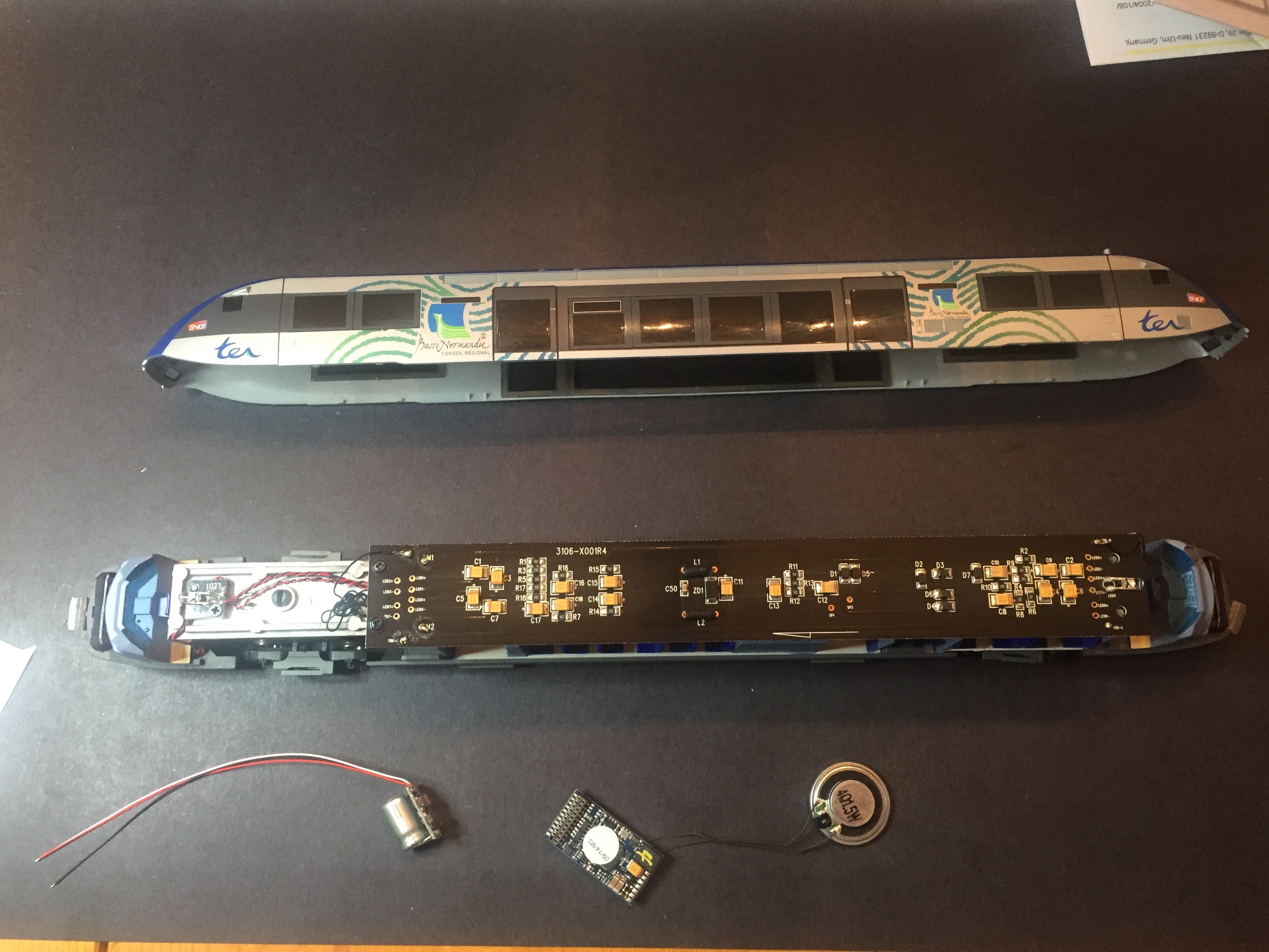

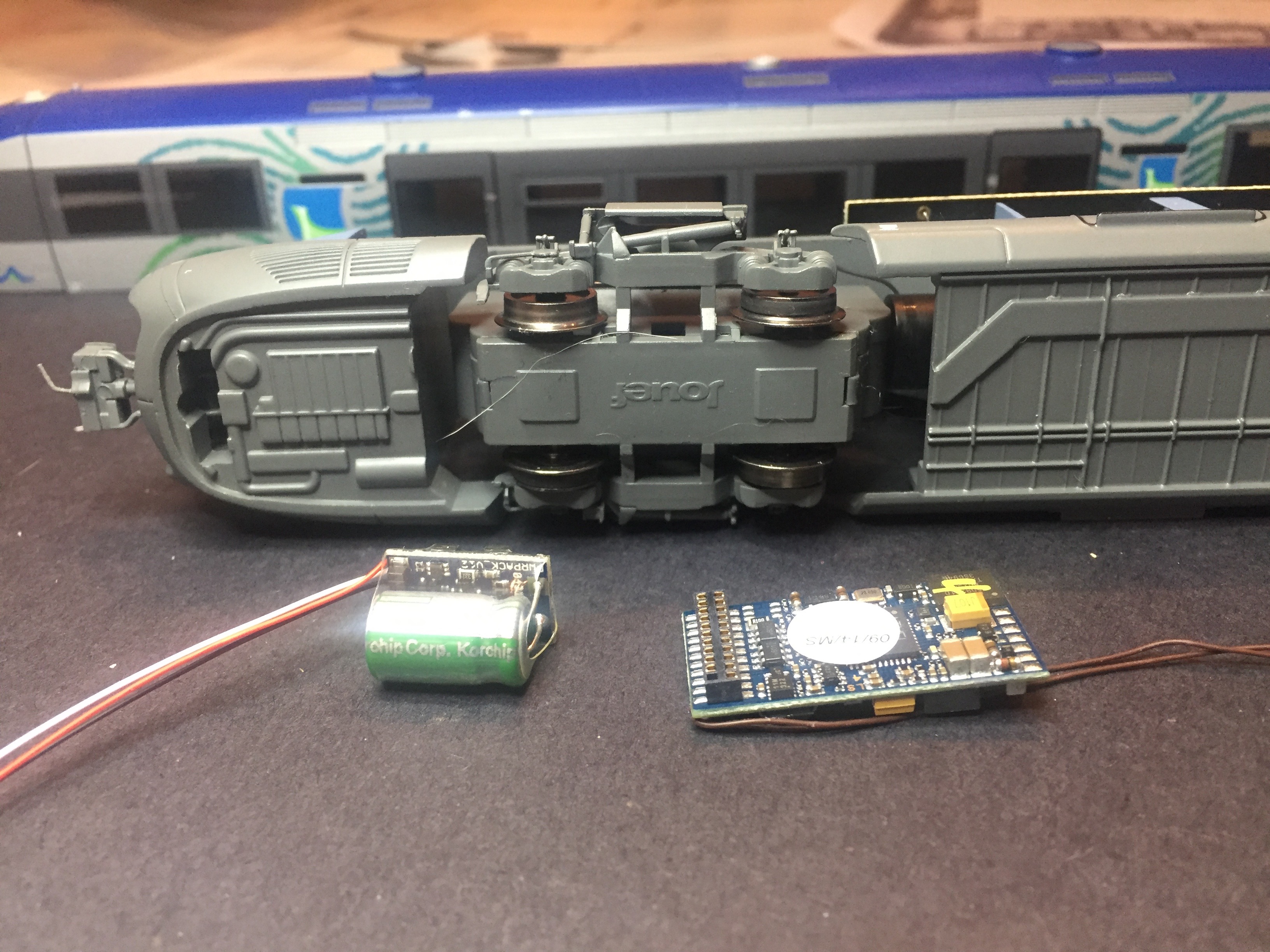

The ESU Powerpack mini is designed to help bridge the power gaps and lessen the flickering of the interior lighting. Upon opening the shell, I found a great hiding place for the Powerpack right underneath the decoder. This section of the body is hidden from view despite having seats. My speaker is tucked against the drivers bulkhead with a small piece of double sided tape.
Installation
Installation is easy although I did require a magnifier and third hand during soldering. I have some very thin solder I acquired for making Z scale turnouts - this was also a huge help!
The Powerpack instructions clearly show which pads the red, black, and white wires get connected. Once soldered, i reinstalled the decoder and set the Powerpack in the opening below with a small piece of double sided tape on the bottom to hold it into place. I also tucker my speaker back in place.
Results
The railcar's slow speed performance dramatically improved. It crawled through my test track without stopping. I don't have the same issues with my longer railcars - probably due to more wheels on the track. I do plan to retrofit the Powerpack where possible to my locomotives and single unit railcars.`

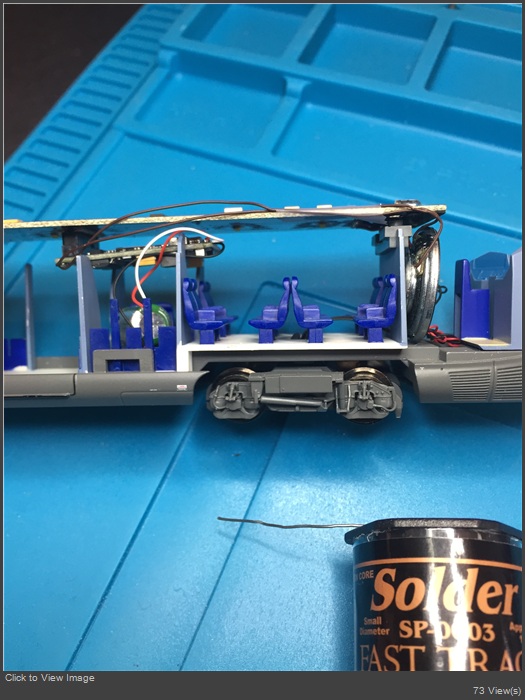

Here's the completed installation. I used a small piece of tape to hold the speaker wires to the PCB. Next time I'll add longer speaker wires and run them over top.
