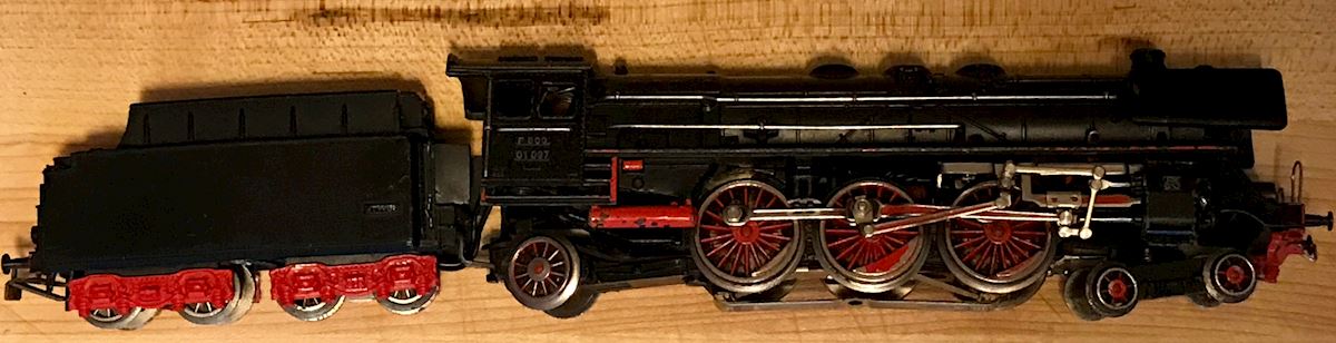

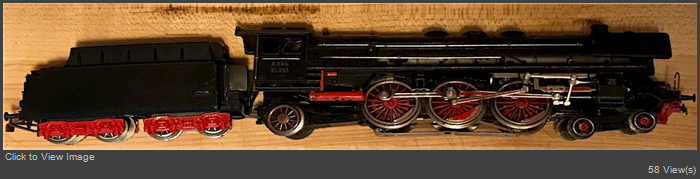

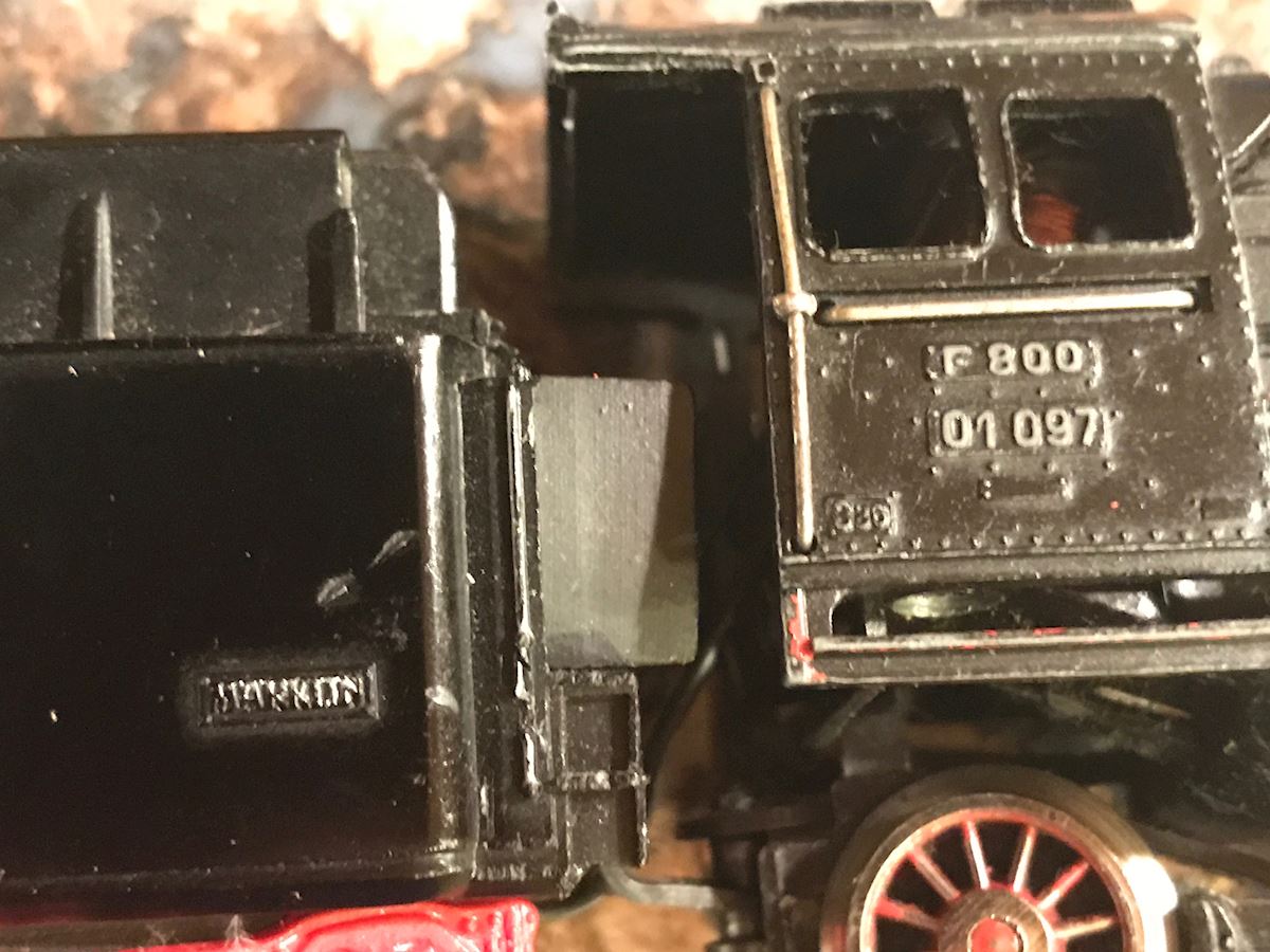

Going through a childhood collection of 1960's era Marklin hardware and starting with a couple of locomotives (I have more, but I'm just getting my feet wet as a newbie to the forum). I'm curious if there is anything special here, and would like to know how to identify the version/year, grade the condition and approximate a value for an F800 and a 3015 so I'm reaching out to the collector community for help (which is appreciated). The F800 was converted to a smoker back in the 60's. When I ran it about 10 years ago for my kids, the smoker unit wouldn't work so I installed a replacement but kept the old parts-everything else is how I had it as a kid. I'm not sure if this is standard or not but the tender has a solenoid for the coupling and requires two speed control knob presses to change locomotive direction. The 3015 is unmodified. Both of them run but there are no boxes for either of them. A picture is worth a thousand words so here are a few posted photos (hopefully this will work!):

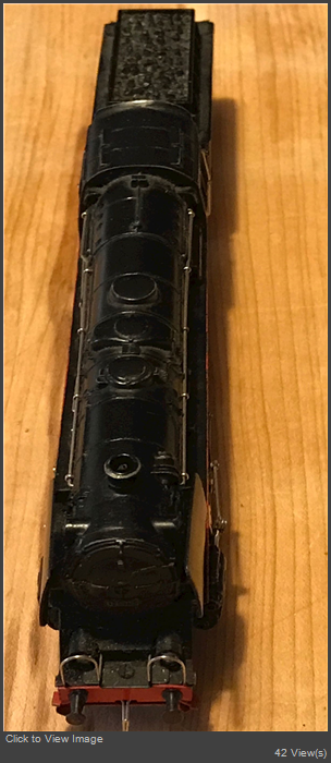

Is it really an F800, or the later 3048? The F800 numbering on the cab may have carried over into later production as the models stayed the same even under the new numbering system. The smoke unit may be original, as there were a handful of locos that came with factory fitted smoke units around that time, along with the Telex coupling you mention in the tender. This would have been a premium production item in its day. The smoke units can fail.

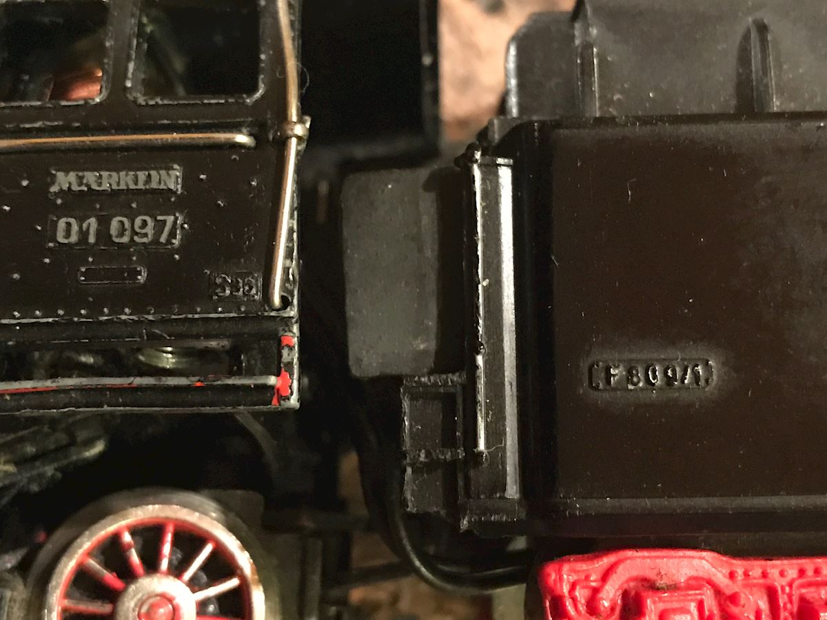

It is a 3026 after F800.
3026 have two black wiring to relex coupling at back of tender from loco but 3048 have no wiring.
The 3026 do not have smoke but 3048 have smoke unit.
Maybe someone drilling throught the chimmy of 3026 for smoke unit fitted?
3026 Running number f800, 01 097, MARKLIN on cab side and F809/1 on left side of tender.

Thanks for the information, that's very helpful and something I certainly didn't know. I'm certain the smoke unit was installed in the 60's by the Marklin dealer in Germany. I know this because my brother got a 3048 as a gift from my grandparents and it had the smoke unit so to keep me from missing out with my older model without smoke (which they had given me as a gift years previously) they had it installed. Grandparents are the best, aren't they? So I would conclude there's nothing that special about this model; any way to determine the year and value of it?

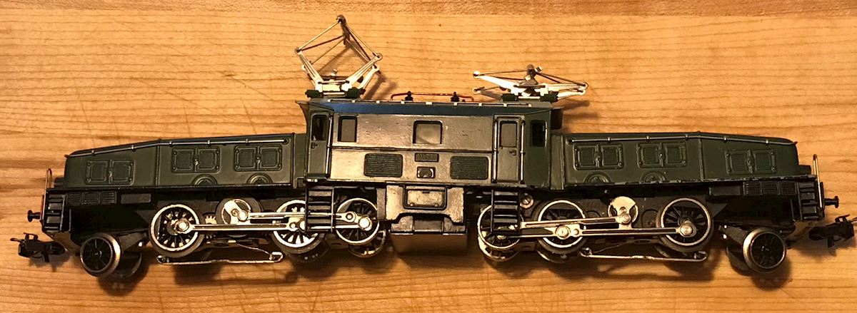

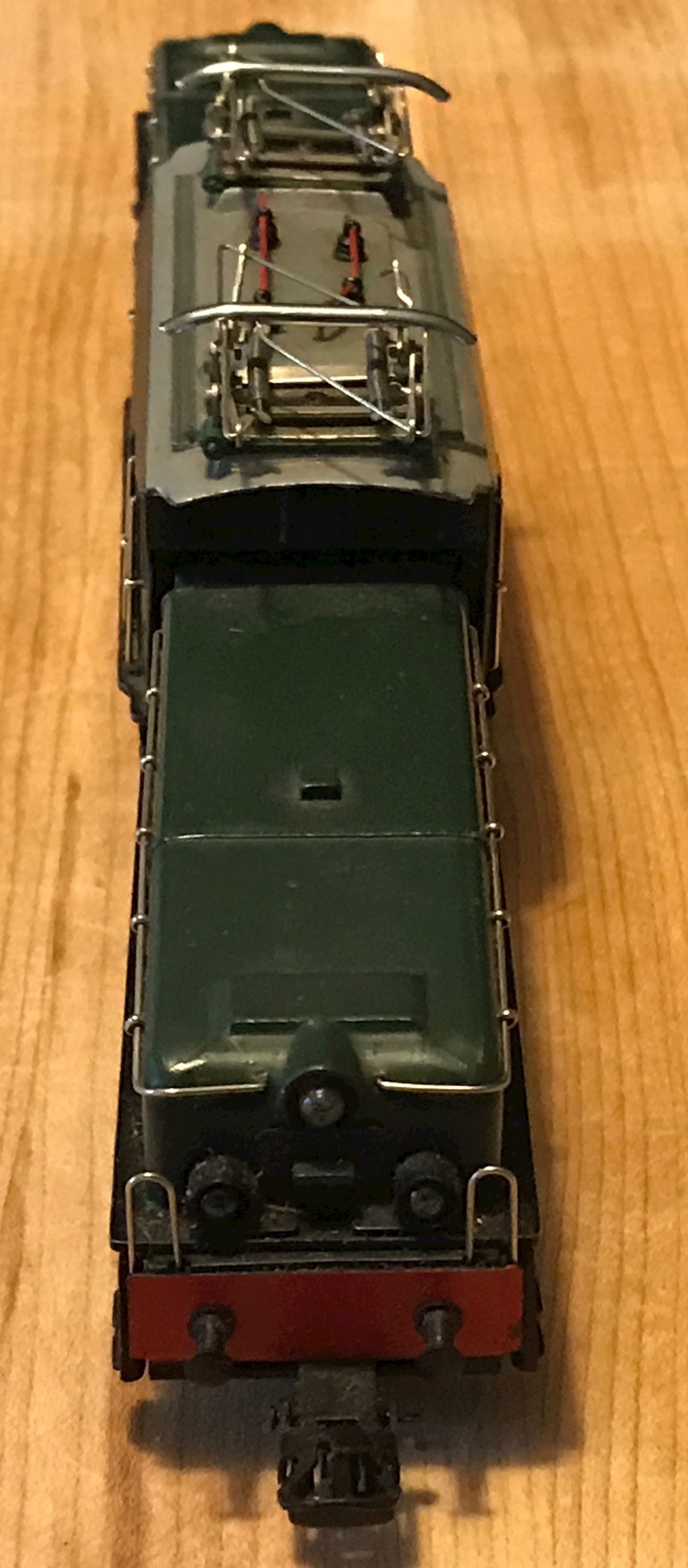

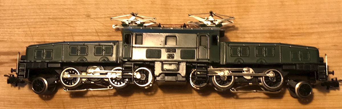

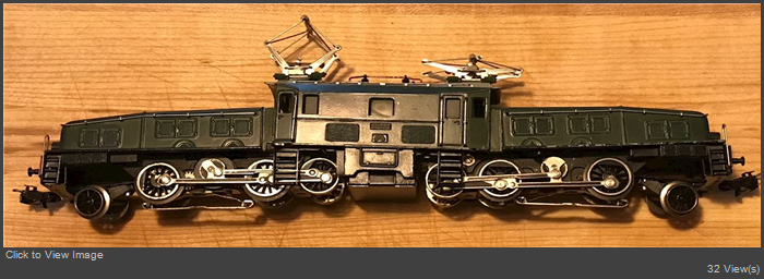

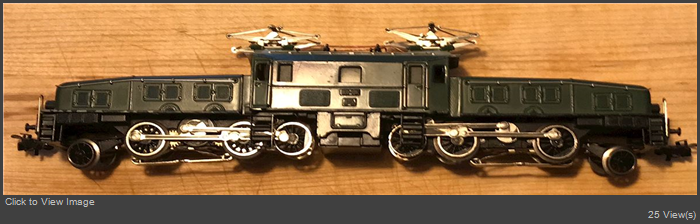

Anything special about the Swiss locomotive 3015 and what year might it be? (it's going to be newer than the 3026 since it was given as a gift years later)

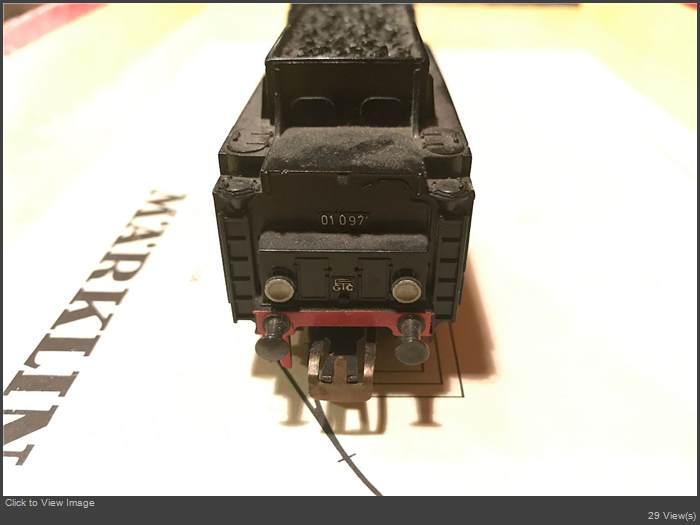

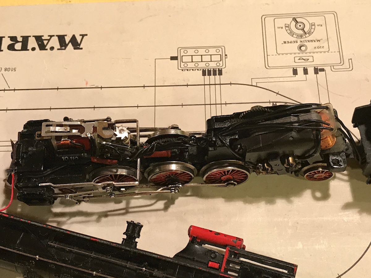

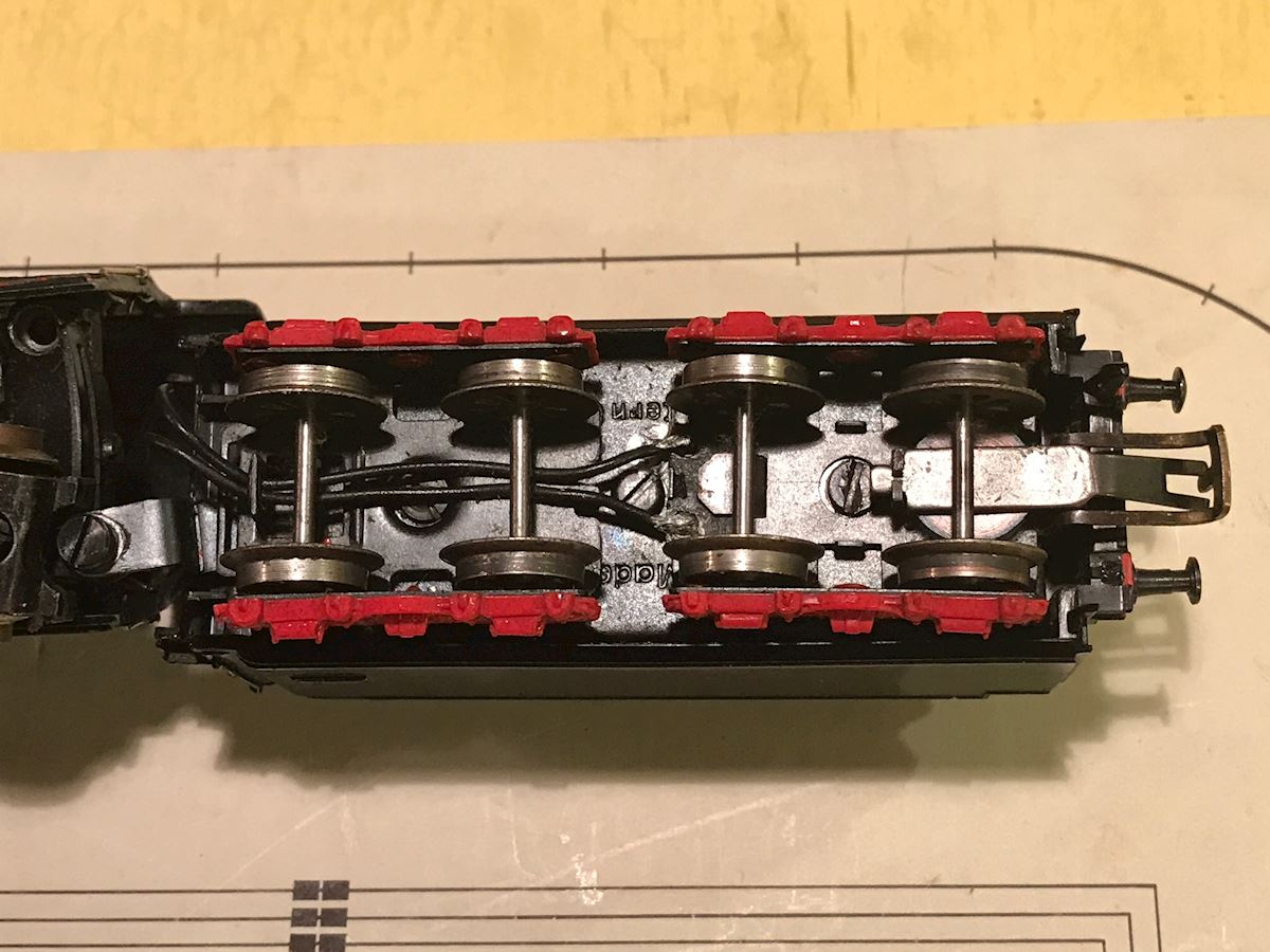

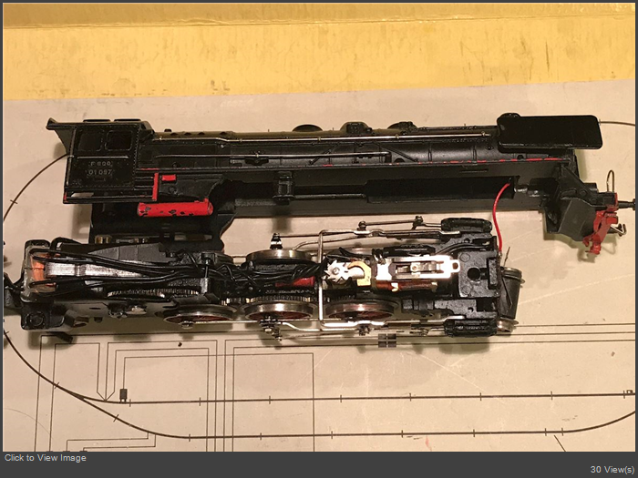

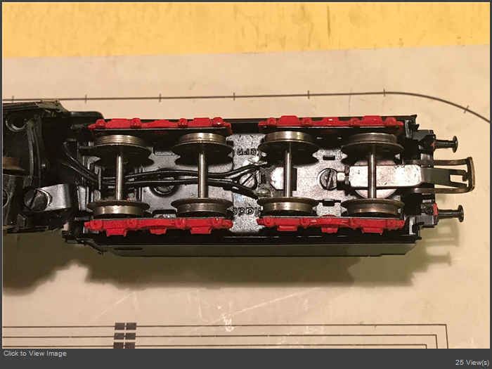

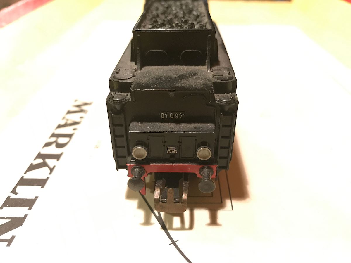

But the 3026 you have is interesting. I think it would be helpful if you could get a couple of photos with the engine shell off and some close up pics of the tender. The rear coupler, stairs and running numbers on the tender always help identify specific versions or at least narrow it down to a few options thus give you a better idea of the value.

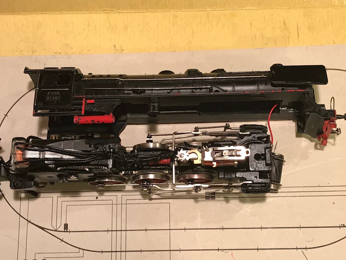

Photo of 3026 (bottom) and 3048 (top).
3048 have screw at top of boiler to open loco body but 3026 have three screws (two underside of cab and one undersider of front of loco).
Tender coupling/handrail around front of headlight are different.
Note the loco driving wheels type are different (3026 4mm and 3048 3mm wide).

Here are some close-ups of the 3026's tender and views of the chassis to (hopefully) aid in identification. The locomotive still runs, reverses, and emits smoke (via the custom modification mentioned previously); the telex coupler is intermittent in its function but I haven't investigated the cause.

the Crocs (3015) are usually worth quite a bit, but I do not know enough about the different versions to make an educated guess.
