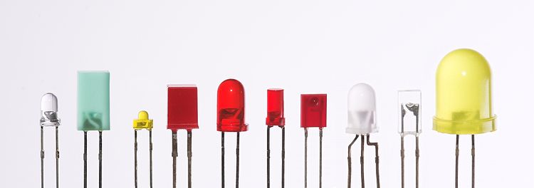

There are various types of LEDs used for model railroading so there is no standard answer except these LEDs are usually operating in the 3-4 volt range and require a resistor to drop the typical model railroad voltage down to this 3-4 volt level. The value of the resistor depends on the voltage requirement of the LED and its current draw. Then it is a matter of Ohm's law to determine the resistor value (R = V/I).
Having said that there are model railroad LED lamps available with built in resistors and these are generally direct replacements for older style loco bulbs, built in switch lantern bulbs, older signal bulbs, etc. They do not require an additional resistor.
There are LED lighting strips operating at around 12 volts DC that again have built in resistors and do not need additional resistors if you have a 12 volt supply, but require an external resistor if your supply voltage is greater than 12 volts.
So depending on the LED type you have, 470 ohm may be sufficient, but it is always worth the calculation if you know the LED characteristics. Otherwise do a test circuit on one LED, measure the voltage across the LED and if possible the current through the circuit. That is helpful in determining the resistor wattage. I have burnt my fingers a few times on a too low a wattage resistor, but fortunately have not created a fire.
Probably a more complicated answer than you expected, but there is no one size fits all solution when it comes to MRR LEDs.

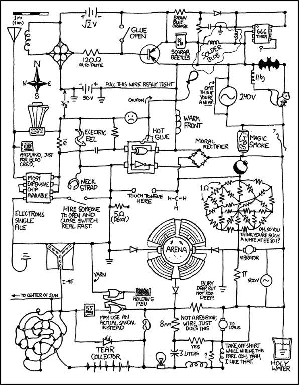

It was suggested that one should draw out the circuit. I'm going to try to attach my sketch. Please let me know if you see anything I missed. Enjoy. Cool
thanks 3 users liked this useful post by JDennis

#36 Posted : 12 December 2017 11:45:41(UTC)
Posts: 14,901
Dennis, there are led's with 2 wires (cathode + anode), the one which would fit most locos are 3mm or 1,8mm tower led's they fit into the socket. available from any electronic shop or ebay. the cathode (-) side this is where you add a resistor to it.
you can't use led bulbs either with screw or bayonet fittings as you rightly said they are not separated from the chassis.
