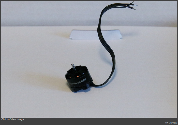

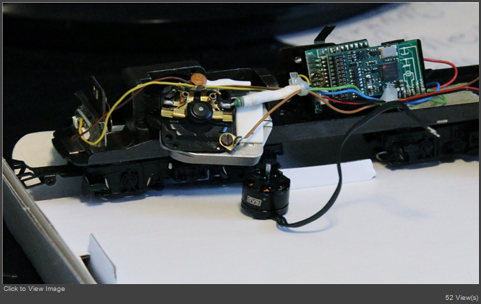

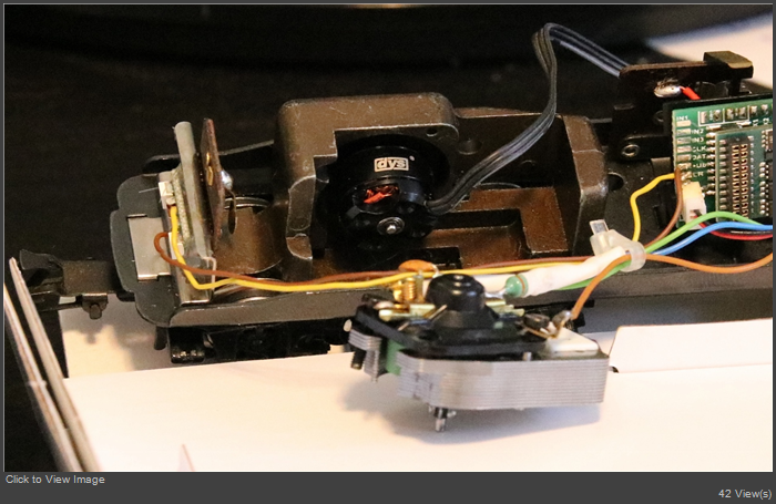

Here you can see a sample of a motor itself, a 3 phase brushless outrunner. This is a motor designed to run at 2S (7.4V) peak. The one potential draw back of it is that it's 5200kv which is a fairly fast spinning motor. Something more on the order of 700kv would be better suited, but this what was quickly available for now to try with. Worse case one could go down the road of attempting to rewind this motor. I may have gone slightly too small with this choice, but it still has a fair amount of torque and there's plenty of other options available to try with.

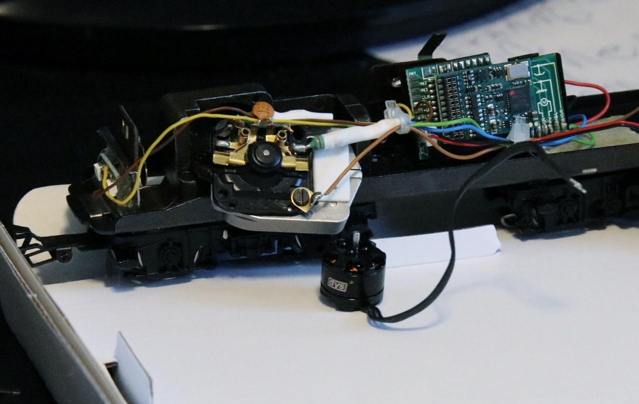

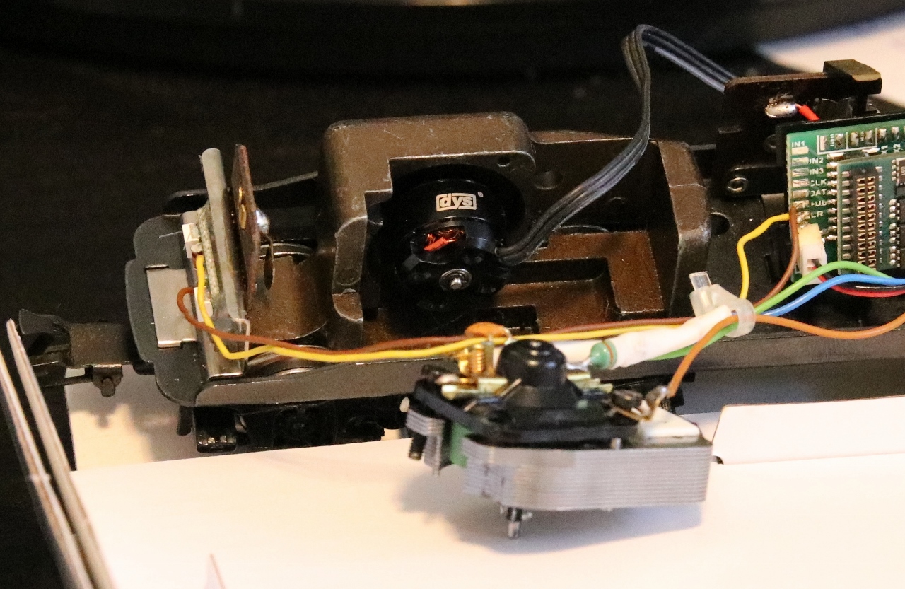

Here's a comparison and you can get a feel for how small it really is.
The motor itself fits well within the available space

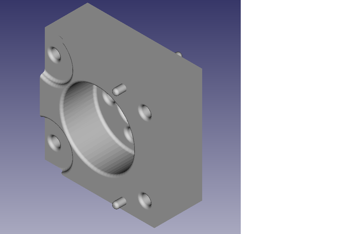

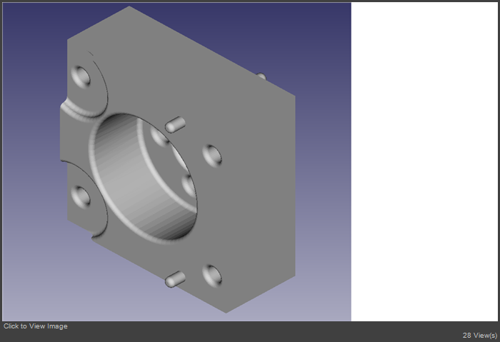

One of the first hurdles will be building a new motor plate to hold it in place. If anyone has 3D mechanical modelling experience and wants to help out here that would be great. I have access to 3D printing FDM and CNC at home and full SLA printers at work to build the prototypes.

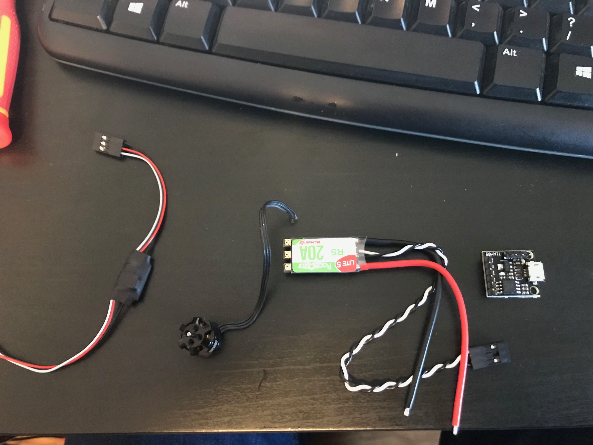

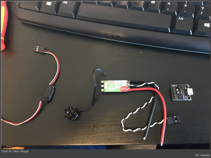

As for the electronics side, most of what is needed is easily handled in the RC market as well. My idea for now is to use as many off-the-shelf components as possible with the ultimate goal of consolidating them on a integrated PCB once it's proven out.
From left to right:
1) 5V buck converter (voltage regulator). This will supply all power to each item downstream. Ahead of it will be a simple AC/DC rectifier/filter from our track voltage.
2) The motor again
3) The ESC (electronic speed controller). This takes a standard server input signal (sort of PWM but not quite) and drives the 3 phases of the motor appropriately. Since this is off the shelf, it's unidirectional but the integrated one could easily have reversing ability.
4) The last is a small micro. It's main purpose will be to sample the motor voltage output from the existing decoders motor leads in the locomotive and convert it to the pulse train necessary to control the speed on the ESC. It will have to be prefaced with a small amplifier to circuit to apply a DC offset and scaling. This way we can easily retrofit/integrate with existing decoders.
You're looking at a total cost of components of only around $25 in this picture. Cost will come down further with a integrated PCB.
Ill try and update as I progress and share how things proceed. Again, if someone can assist in the 3D modelling area that would be very helpful.
I don't know what you mean by 2S (7.4V) - or is that the number of battery cells? It sounds like it might be at that voltage.
I presume when you say 5300kv that you mean 5200 revs per minute, which would make sense for a motor of about this size.
I suspect this motor has built in electronics judging by it having only three wires. This will mean it will run at only one speed (two speeds if you count STOP). It will need external electronics the way the C-Sine motor has to make it variable speed. This would be a significant project for someone skilled in electronics to get it running smooth and as good as a C-Sine motor.
As an aside to this, what do you suggest doing to put a suitable gear on the motor shaft to engage with the drive train?

Hi.
No, 2S is common terminology in the battery world. Here is means 2 cells in series (each cell being 3.7v).
KV is common terminology in the motor world. Here it means RPM/V under NO load. It’s hard to extrapolate to real world as there is always a load and tends to be significantly slower. The DCM gearbox provides further reduction. Hence though my guesstimate something closer to 700KV would be more ideal to run all the way from 0-7.4V
And no, the motor has no electronics. It’s a 3 phase brushless motor hence 3 leads. You vary the speed by adjusting the frequency/amplitude of the drive. The ESC shown are the drive electronics (basically a small 3 phase inverter). Direction is easily changed by swapping two lead so the phase ordering reversed.

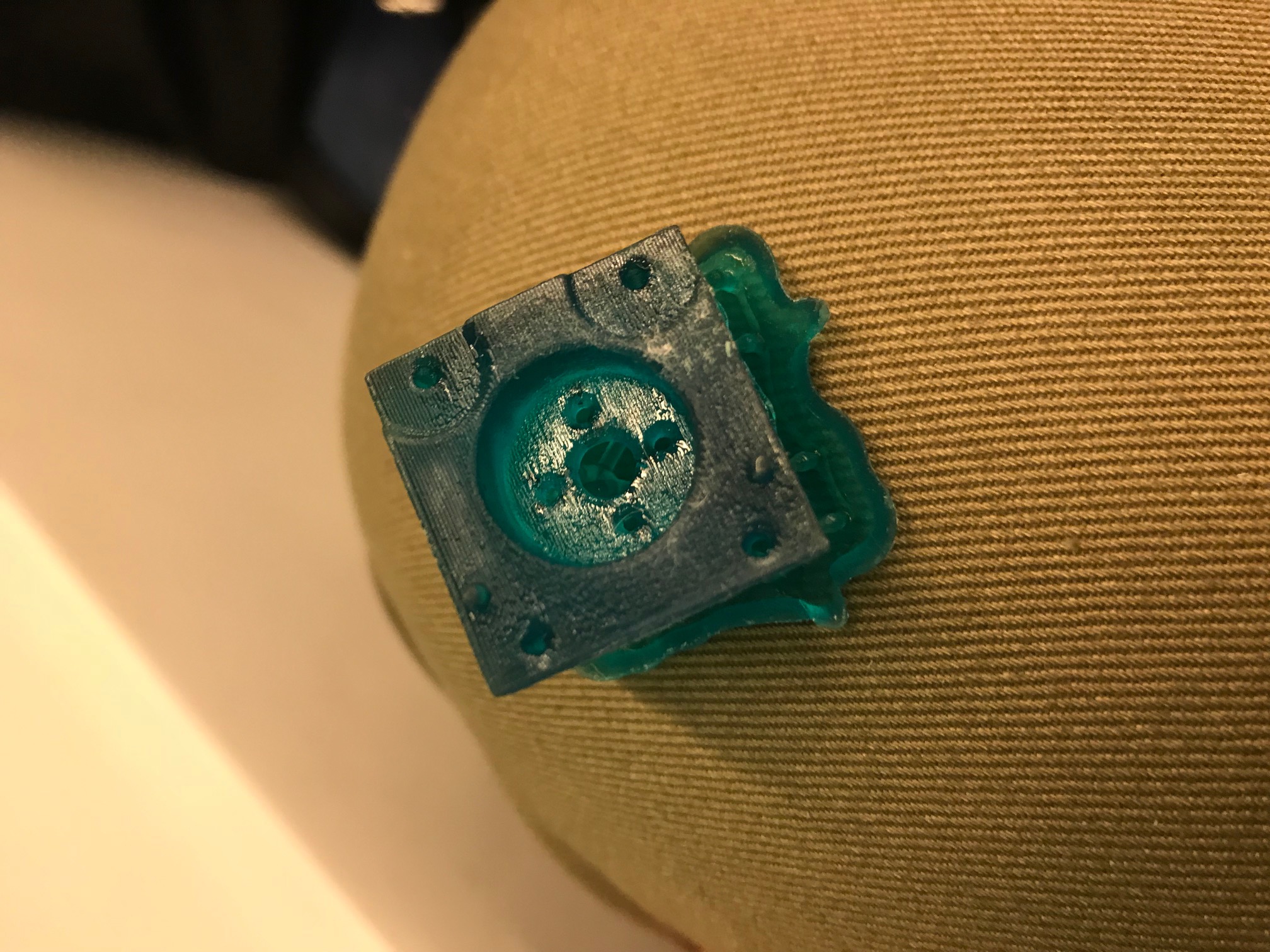

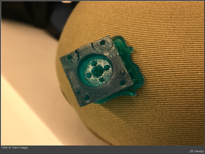

Was actually able to get a very quick prototype motor plate printed up. The CAD model definitely needs work but a quick check to see how things might fit together. I can still probably clean this up a lot on the mill if it isn't a perfect fit.
The print is still curing (and so a bit wet still)
